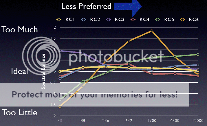

I like this graph/study from Dr. Olive about preferred room response curves:
Fixing the power response in the treble seems to have helped as did just 'fixing' it and the bass for just one location.
Thoughts?
Dan
I believe he was looking at DSP room EQ units. If I remember the top two curves are the Harman unit but one is set for best 6 seat average and the second set for best single seat average. The other units were various competitors including Tact and Audesey?
All have some arbitrary down tilting "room curve", as they must, since they are EQing the steady state (room) curve. Not the best approach.
The 6 seat averages and the center seat average are pretty close for upper frequencies and vary a bit for low frequencies. This in spite of Audesey spreading the flasehood that they can lessen the variation between seats (not possible with EQ to a single speaker).
I'm not sure there is anything to do with power response here.

Close, the best is for 1 seat EQing, 2nd was for 6 seat average.I believe he was looking at DSP room EQ units. If I remember the top two curves are the Harman unit but one is set for best 6 seat average and the second set for best single seat average. The other units were various competitors including Tact and Audesey?
Maybe, maybe not... These EQs have worked better for me than any other method. They beat the unEQed sound in the study as well. Doesn't mean they are a substitute for good speakers or room treatment of course.All have some arbitrary down tilting "room curve", as they must, since they are EQing the steady state (room) curve. Not the best approach.

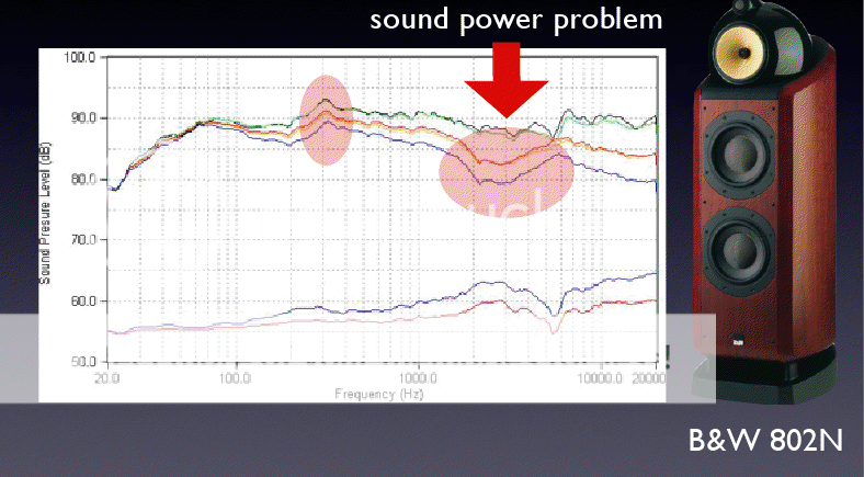

Audyssey's claims... Not touching them. I'm going to go through some slides here with power response in mind:The 6 seat averages and the center seat average are pretty close for upper frequencies and vary a bit for low frequencies. This in spite of Audesey spreading the flasehood that they can lessen the variation between seats (not possible with EQ to a single speaker).

I don't see how Harman could be 'fixing' the power response directly, but it looks like that's their aim and it seems to work. I'd rather start with 'right', but if you need to buy esoteric speakers for whatever reason, looks like they can still be improved in their perceived balance. The top three fill in the hole on the power response. The top one also has the best bass response--that could be the biggest part of it, but it would be hard to argue that the power correction didn't play a role. Wish he would have kept the colors the same throughout. The software I use is the same as the top.
