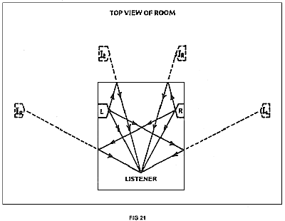

I very much agree but there's also the option of a stereo bipol center speaker which maximizes delay of first reflections. First reflection point could be rigid panels or side walls (although this will decrease the delay slightly):
You are not implying that the sound from the reflectors can be considered as the direct sound, am I right?
Nonetheless, getting > 3 m path difference between the sound from the speaker and the sound from the reflectors would still be difficult in this situation.
Anyway, the topic was conventional stereo, so let's stick to that. These other set-ups do sound interesting enough for their own thread, I think. Graaf, maybe you could do the honours of opening one? :D

any system which relies on the reflections from room boundaries as a primary source of sound for the listener is not on my list of satisfactory solutions, and this also applies to Markus's suggestion in the previous post. (I'm not sure how it solves the problem anyway...)
The bipol setup I've just shown doesn't rely on reflections, it utilizes them for increased spaciousness. There is a direct component that's why I've drawn a line from the speaker to the listener.
This setup addresses the fundamental problem of stereo speaker crosstalk and head-in-a-vise sweet spot. It also maximizes side wall reflections.
See my answer to Simon.
Why 3m (8.7ms)? I'd prefer >10ms. Linkwitz is fine with 6ms (2.1m).
You asked "What is the ideal directivity pattern for stereo speakers?". This bipol is a stereo speaker. One of the biggest challanges with it is its directivity pattern. How loud do the side reflections need to be, how to prevent serious lobing over the listening area?
Yes but the direct component comes from the listeners centre line, so all of the stereo information in the recording must be provided by the wall reflection. Unless you are listening to a mono recording you are relying on those reflections.
You have the added problem that the low frequencies and mono component of the music arrive first, and the stereo part of the image is greatly delayed by the extra path length. I really don't see how this solves any problems and in fact introduces many others.

The center bipole approach is about adding spaciousness by strong, symmetrical and delayed reflections.
Yes but I don't want strong delayed reflections...when in this whole thread have I ever asked for that ? ;) I have never had a listening room where I thought to myself "gee, I wish I had more room reflections". It's always been a struggle to reduce reflections and get slap echo/ RT60 and early specular reflections from the side-walls down to manageable levels without doing very WAF unfriendly changes to the room...
Here's the direct sound and first side wall reflections for Beveridge:
... and Stereolith:
Fundamentally different.
You have to think outside the box :D
Stereolith (with my modification, The cardboard (TM):
Beveridge:
Fundamentally the same ! :)
Stereolith creates wider stage, and importantly, all the images are outside room boundaries, the walls really disappear.
