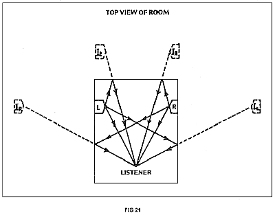

I often see figures tossed around like Linkwitz's 6ms to first reflection, or Earl's 10ms to first reflection, but they frustrate me no end because they seem completely unrealistic.
Lets get real here - how on earth can these figures be achieved in anything other than a huge (by European standards) living room ?
Just looking at my current room, 3.45m wide x 4.8m long.
Your room is too small for conventional stereo triangle !
But I have news for you: Do you realise your room is ideal for stereolithic projection with direct sound blocked ?
You can achieve 6ms between first and second ipsilateral image. And more than 9 ms between first ipsilateral image and first contralateral image. Are you not tempted to try ?
