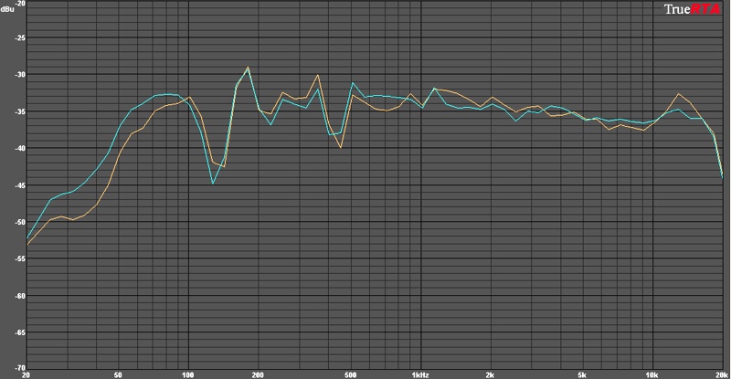

I find the floor bounce is pretty dominant when you are fairly close to the speaker, just as the back wall bounce is obvious when the speaker is near the back wall. At greater distances it does get somewhat lost amongst the standing waves.
Here are two speakers being measured close in (1.5 meters or so). 130 and 420Hz, or so, dips from floor bounce.
David

Hi David,
I doubt what you've measured is the floor bounce. Vary the distance of the whole setup from the front wall while keeping height and distance of mic and speaker relative to each other. If the dips change in frequency it is an adjacent boundry effect. If the frequency stays the same and just the magnitude changes, the effect was modal.

It is most certainly audible. If you've ever experimented with a 3 way design where you can adjust the height of the woofer all the way from the floor to just under the midrange driver, the difference is large, and plain to hear.
Of course some of the change is due to room modal effects (mainly the floor-ceiling 1st and 2nd order modes below 200Hz) and some of it is also due simply to proximity to the floor, and also occurs outdoors.
When people speak of floor bounce I think they usually mean only the incident bounce between the speaker and the listener - the time delayed copy which introduces a notch and comb filtering.
At normal listening distances that notch goes high enough in frequency (above 300Hz or so depending on driver height) that the modal density of the room tends to fill in or disguise this notch.
Certainly in my current room I'm unable to measure the notch calculated from the single floor bounce back at the listening position - there are too many other reflections at various random phase angles for it to manifest without some other reflections filling it in.
On the other hand the floor ceiling 1st & 2nd order modes (typically 70Hz and 140Hz for a 2.4 metre / 8 foot ceiling) do tend to manifest at any listening distance. Depending on the length and width of your room the 70Hz notch may be filled in by other modes, but the 140Hz notch will usually remain stubbornly present.
Technically not floor bounce perhaps, but it is still a response aberration whose primary cause are the bounces between floor and ceiling, and are least troublesome when the woofer is very close to the floor, as measured anywhere in the room.
For this reason I think its fair to lump the floor/ceiling modes in with the usual "floor bounce" from a practical perspective.
