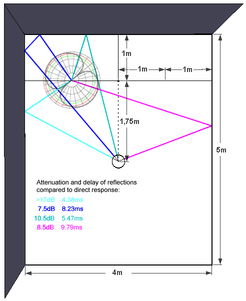

To me the speaker directivity is not a value in itself, but a means to achieve certain goals. I use the radiation pattern of my dipoles mainly to control the first reflections. In my room the speakers are roughly 1 m from the front and side wall, with a stereo base of 2 m. When listening in the 60° triangle I get the first horizontal reflections as shown in the picture below. Dipoles are toed in 40-45°.
I almost achieve the ideal dipole pattern with -3 dB at 45°, -6 dB at 60° and -12 dB at 75° (second picture). This leads to the attenuations depicted in the first picture. Note how the attenuation is inversely proportional to the delay: earliest horizontal reflections get most attenuated.
This is what I think is "ideal" about a dipole; two nulls can be pointed at the first reflection points. The next question is if even stronger directivity would be beneficial for stereo. My opinion on this is that it has advantages and disadvantages. Sharper imaging and higher tolerance of high SPL's but more listening "through a window" and and less spaciousness.
If we want to reduce reflections in line with the speaker and maximize lateral reflection then a dipole is less than ideal at the usual orrientation. However, if you take Rudolf's diagram and turn it another 30 degrees then you can totally kill the back wall bounce and strongly increase the side wall bounce. This isn't a typical orrientation but it looks like it should work very well.
If you're relying on a high degree of rejection of the ipsilateral wall reflection due to it being at or near the 90 degree notch of the dipole, what happens for listeners who are at a different distance from the speakers ?
Surely this makes the forwards/backwards seating location very critical, due to the sharpness of the notch in the polar pattern of a dipole. Sit at just the right spot and you'll get almost complete attenuation of that first ipsilateral reflection, (maybe a good thing, if your tastes are to minimize side-wall reflection) but sit a couple of feet closer or further back and now you'll get far less attenuation and the overall presentation will change, perhaps dramatically.
Not only that, as you move further forward from the side-wall reflection "dead zone" the reflections will receive an additional 180 degree phase shift in addition to the path length time delay, while if you move back from the "dead spot" they will be in phase, meaning that being slightly ahead or behind the ideal spot will sound very different to each other.
Compare that to a more conventional well designed "directional" or CD design, where there are no sharp notches in the polar pattern, and no abrupt change or reversal in phase of the reflections.
I'm struggling to accept that a very deep and narrow notch in the polar response of a speaker is a desirable thing, especially if you are trying to increase sweet spot seating location radius, not reduce it.
The fact that there is a constant phase difference of 180 degrees at all frequencies on either side of the notch is worrisome to me too - nobody has yet provided a convincing (or any) explanation why we should not be concerned about the fact that some reflections depending on incident angle are getting an additional 180 degree phase rotation - something that all the diagrams with nice little arrows gloss over.
Maybe at high frequencies there is enough random phase decorrelation provided by the room geometry and path length that the treble reflections from the room corners will come back sufficiently scrambled in phase that it doesn't matter, but at midrange frequencies, no, there will be in and out of phase coherency issues.

I doubt that you started by drawing reflection paths and then decided to build a dipole :)
Surely not. :)
But when I went the route to a deeper notch at 90°, it was with the intention to use it in loudspeaker positioning.
... if you take Rudolf's diagram and turn it another 30 degrees then you can totally kill the back wall bounce and strongly increase the side wall bounce ...
Who has a pair of dipoles to try?
I turned the dipoles 30° more inward. The "stage" widens well into the side walls. But the definition of the stage between the drivers gets worse - which was to be expected. Centered instruments double in width, partners singing in duets are dragged apart. This is much worse than the strong, but well delayed side wall reflection as shown in my diagram. My layout is not the same situation as in Toole, p.297, fig. 15.8 b, but it helps to widen the stage beyond the speakers - into a pleasant 90° panorama for many recordings. This without blurring images between the speakers to a comparable extend.
In fact I don't think that (the quality of) imaging as such has much to do with the loudspeaker directivity pattern (as such). But is has massively to do with how the directivity of the speaker illuminates the adjacent walls. By turning the dipoles from 0° (along the listening axis) to 90° (facing each other) I can dial in quite different listening experiences - in the same room and without changing anything along the walls.

I have and I've just given it a try. My room is only 2.5 m (8 ft) wide and highly reverberant though. The dipoles are also 2,5 m away from the back wall and I can't put them closer.
The side wall reflections are extremely early, about 2 ms. With the normal toe-in that reflection is down > 9 dB, which is definitely a good thing for a reflection that early I would guess.
I've already tried "toeing out" the speakers, but then the image collapses into two pieces and phantom sources are split.
With an 80 degree toe-in, the ipsilateral reflections still come from about 60 degrees off the rear-axis of the dipole (because the side wall is so close), so they are still relatively weak. The image is still reasonably well defined but further backwards and there is no significant broadening.
With a 90 degree toe-in, the image broadens more and sounds more spacious and diffuse, the sound really fills the room. The image is now vague and somewhat ambiguous for some instruments.
