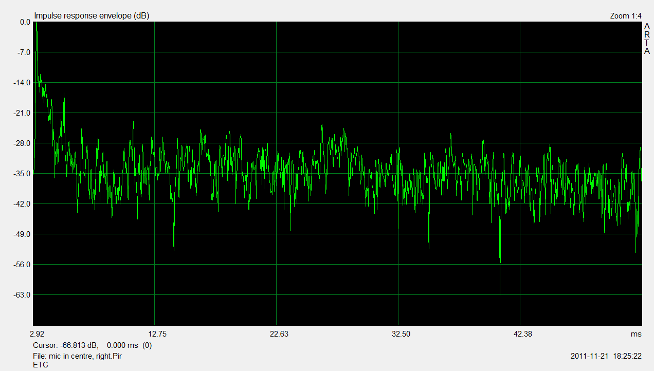

This is with a speaker with a 12" horn and woofer crossed at 1 khz in a relatively live room of about 100 m^3, with damping panels at the first reflection points.

People do understand the term diffuse (homogeneous and isotropic) but the ETC posts were about your comment that it's "difficult to impossible in most small rooms" to achieve 15dB/15ms.

That's even markedly cleaner than I get when I measure speakers outside. Before I had absorbers, there were one or two reflections louder than -15 dB, the contralateral one being the most pronounced.
EDIT: Or maybe I don't know how to read your plot. The impulse peak is probably not at zero dB's. Maybe at -30 dB and about 114 ms?

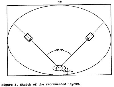

"Loudspeaker Placement for Optimized Phantom Source Reproduction
A joint paper by J. Gerhard, B. Theiss, M. O. Hawksford from the 1996 AES Convention in Copenhagen (Preprint 4246). Their loudspeaker layout is quite different from the ORION++, but similarly based on psychoacoustic observations. I suspect that their listening experience could have been even more convincing, if omni-directional loudspeakers had been used. Those would have increased the reflected energy from the wall in front of the listener over the energy coming from the side walls. That would have reduced the need for micro placement of speakers and listener to 0.5" (12 mm) accuracy without affecting imaging precision.
A setup of loudspeakers parallel to the long wall of the room and close to the listener would seem to be well suited for small rooms and the PLUTO. It could also easily fulfill the minimum distance requirement of 3' (6 ms) from any wall. Close listening distance to the speakers also reduces the magnitude of floor and ceiling reflections if that should matter. "

Markus - I misread the scale - yes that is remarkably good in-room results.

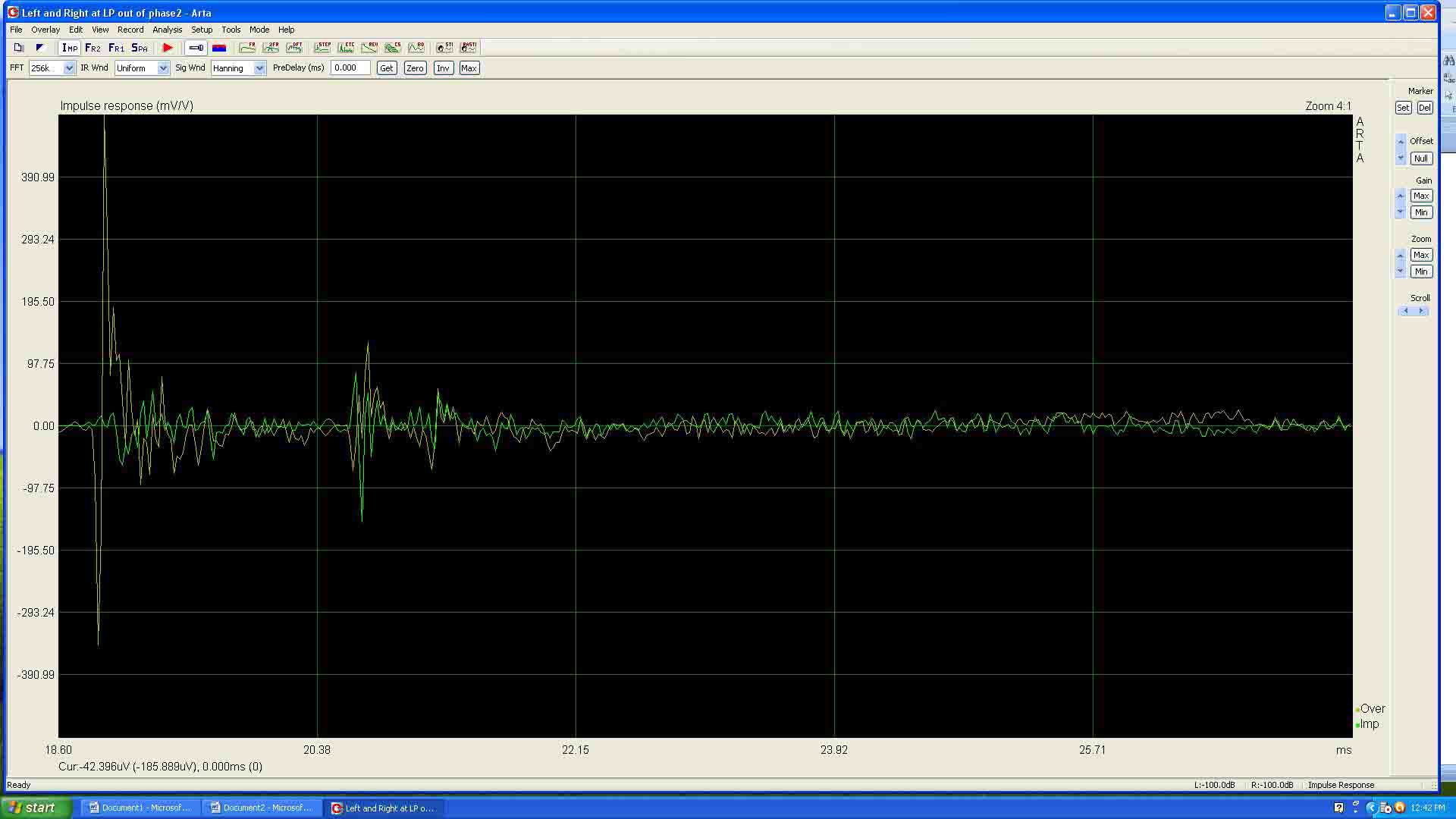

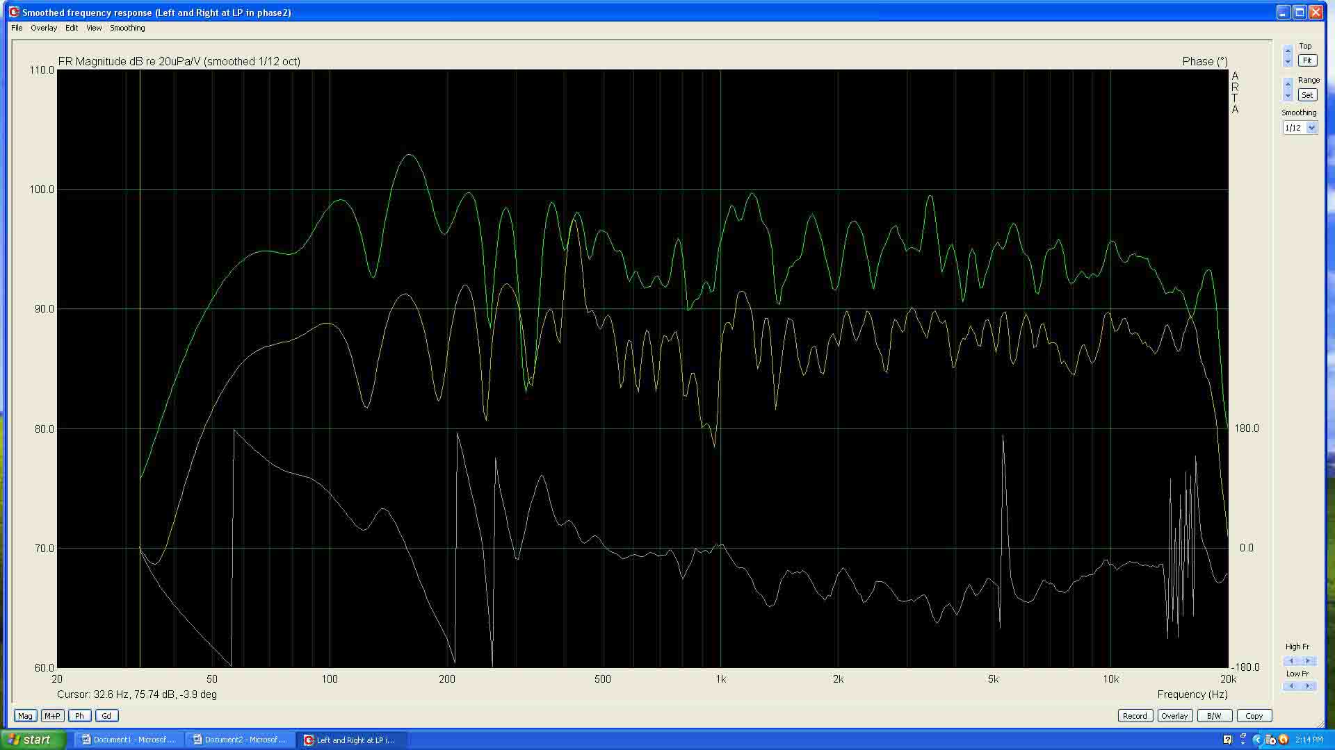

Hi Guys
I was thinking about that left minus right test some of you had done, that had my curiosity going. I had an Arta set up in my livingroom the other day and thought hey, I will do that test. I figure these may look different as a result of having a little more directivity than most hifi speakers.
The speakers are my old passive xover SH-50’s, built about 7 years ago and could probably be refreshed. They are a three way full range horn employing 7 Drivers. The room is fairly cluttered with mine and my kids stuff and there is no room treatment at all with a bare hardwood floor.
There is a wall about 2 feet behind the speaker and a secretary desk and the rear of a motorcycle within a foot of the mouth (IE; not a pristine anechoic condition).
The directivity is such that there should not be any significant short side reflections, while the pattern is 50 degrees wide, it is still -20dB at 90 degrees off axis at 500Hz and about -10dB 90 degrees off at 300Hz and they are aimed inward relative to the side walls.
The listening position is a couch; I have the microphone stand at the foot of the couch, center seat but a bit higher than seated height (wanting to avoid couch effects). The rear wall is well behind the couch.
Picture one is the impulse response for both SH-50’s in polarity and both SH-50’s out.
The listening position is about 14 feet from the speaker, the mic is 18.8ms away from the origin of sound within the speaker. The yellow curve is the impulse response for the two speakers in polarity and the green is the out of polarity case.
As one can see the speakers cancel each other out well at least initially but after a very short time, the stray sound begins.
Picture two is the magnitude responses at LP both in and out of polarity condition.

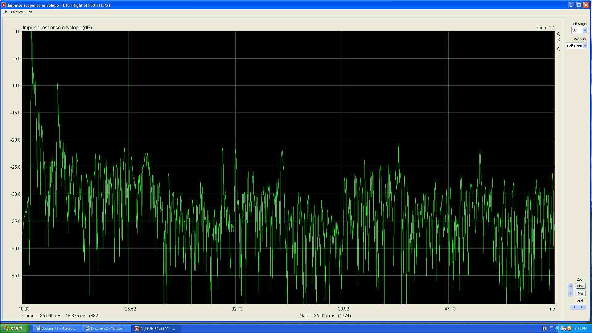

Being an old TEF guy, I like the ETC view of time better than the impulse (the real component of the envelope), the ETC shows energy vs time.
The next picture is the ETC from the right channel at the LP.
Notice the obvious first arrival and a couple ms later, the floor bounce arrival.
In placing the speakers “back then” I put them on top of the subwoofers which at mid height, made the ceiling bounce and floor bounce add together where the mic is at mid height, clever planning eh…ugh?
A closer distance or narrower vertical pattern would be better.
Anyway some curves to add to the heap.
