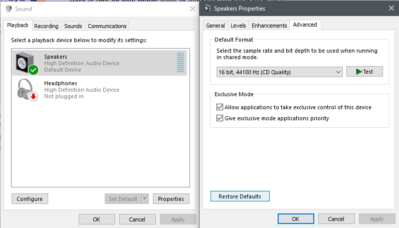

Windows 10 Professional here.

It is a characteristic of Windows 10. And as I said, it can be changed in Windows control panel, sound, device, properties, advanced, shared mode sample rate.
Windows 10 does auto SRC in general if the source sample rate differs from the shared mode sample rate.

Here is info on how things work in Windows 10 direct from MS:
https://msdn.microsoft.com/en-us/wi...atency-audio#windows_audio_session_api_wasapi
Starting in Windows 10 , WASAPI has been enhanced to:
Allow an app to specify that it wishes to render/capture in the format it specifies without any re-sampling by the audio engine

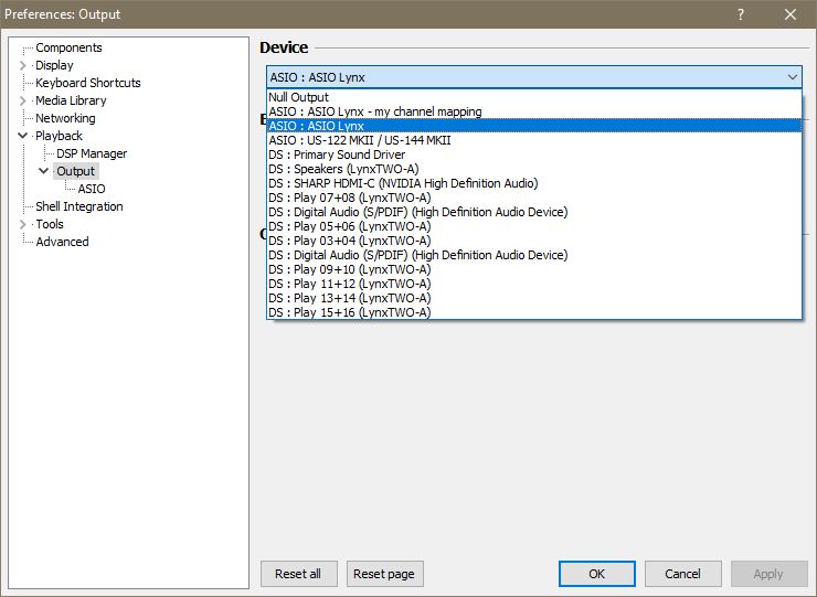

Looks like Foobar can be setup to use WASAPI exclusive mode: foobar2000: Components Repository - WASAPI output support
Thus assuring no resampling (SRC - Sample Rate Conversion)
Foobar can also work correctly with ASIO, although the documentation for configuring it appears incomplete.
http://www.foobar2000.org/components/view/foo_out_asio
