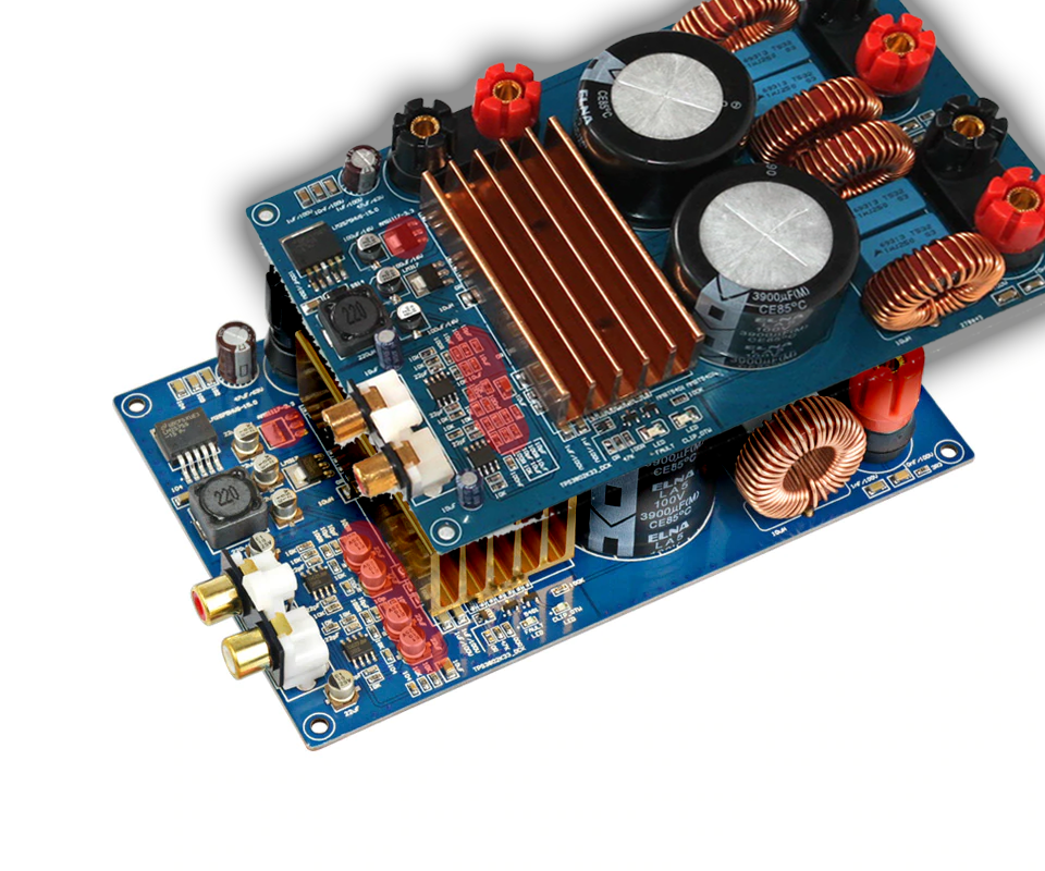

Sorry if this was brought up before, I've read through this thread back and forth but not in a linear fashion.
I noticed there are two variants of the blue TPA3255 board, the major significant difference being different capacitors. One has electrolytics after input opamp stages and is missing the 3.3V regulator. Electrolytics are more expensive so I'm assuming the other one is newer "optimized" version.
Can anyone chime in on the versions and which is considered "better"? My intention is to use a pair of these boards for biamped speakers in place of TPA3118 for moderate listening levels so power requirements are somewhat low - I think 36V supply will be more than plenty so the step down regulator is fine as is.
Thanks in advance!

hi WXN
if i understand you and see the pic´s i can say that i never had board without this little polymer caps.
i bought 1 year ago a blue board with the version of following regulators:
LM2575S -15 and the LM 317. so this regulator is providing the voltage for the opamps and the power chip. not really separated because the LM2575-15 is step down the input voltage to 15V to feed the lm317 input ..then the lm317 is configured to get about 12,7 Volts..this is for the power supply of the opamps and the analog supply of the power chip
as you see in the power chip (TPA3255) datahseet the max input voltage sould not go over 13,2V - so sybic (😉) did a modification of the lm317 down to exact 12V
for testing and try an 8R configuration a bought additionally boards- these boards are with 1 voltage regulator LM2575T-12...so these regulator is providing the voltage for the opamps and the power chip
for my impression with the board i got.......with LM2575T-12 are of a bad quality...soldering is a nightmare because my solder pads are partly away and as you read 1 regulator was dead after some tests...😡
its existing a black board in the net. i don´t know what for a version it is...
the voltage regulator 3,3v is not existing in my boards...so maybe you have a version 4
blue LM2575S-15 +LM317
blue LM2575T-12
black
blue with AMs3,3 and SMD caps...yours
so i am not able to write you which is better in SQ.
so you have more than 1 board so you can compare....
chris

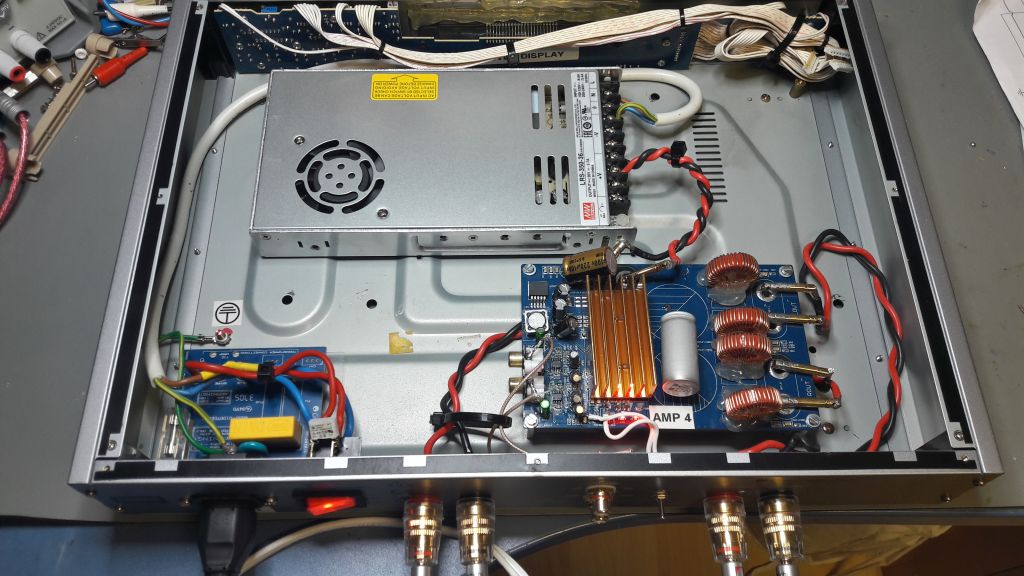

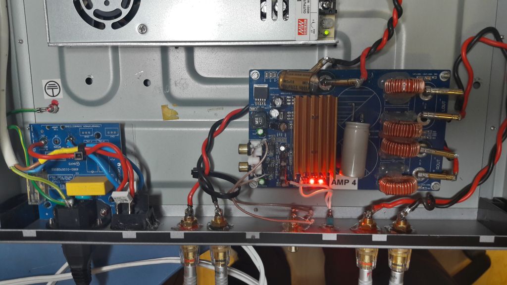

good morning...:wave2:
amp light 2 is ready..its continued from post 605
https://www.diyaudio.com/forums/class-d/309813-wrong-tpa3255-61.html#post5632314

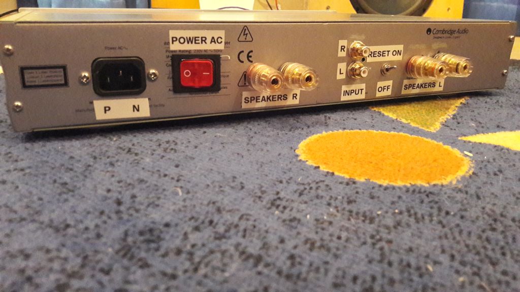

i was a little bit in trouble because the inner dimension high is just 58mm...so i have to change some ideas😀 + add a power switch
its an 8R output filter with the selected original coils that means i use the coils with the bigger values..about 12,9-13,2 µH for my 8R speakers.
opamp 1602, input caps green bipolar muse to the amp + elna silmic 2 to the power chip. original buck regulator but changed 220µH coil and caps. decoupling cap are the gpd
sound very good.
chris
