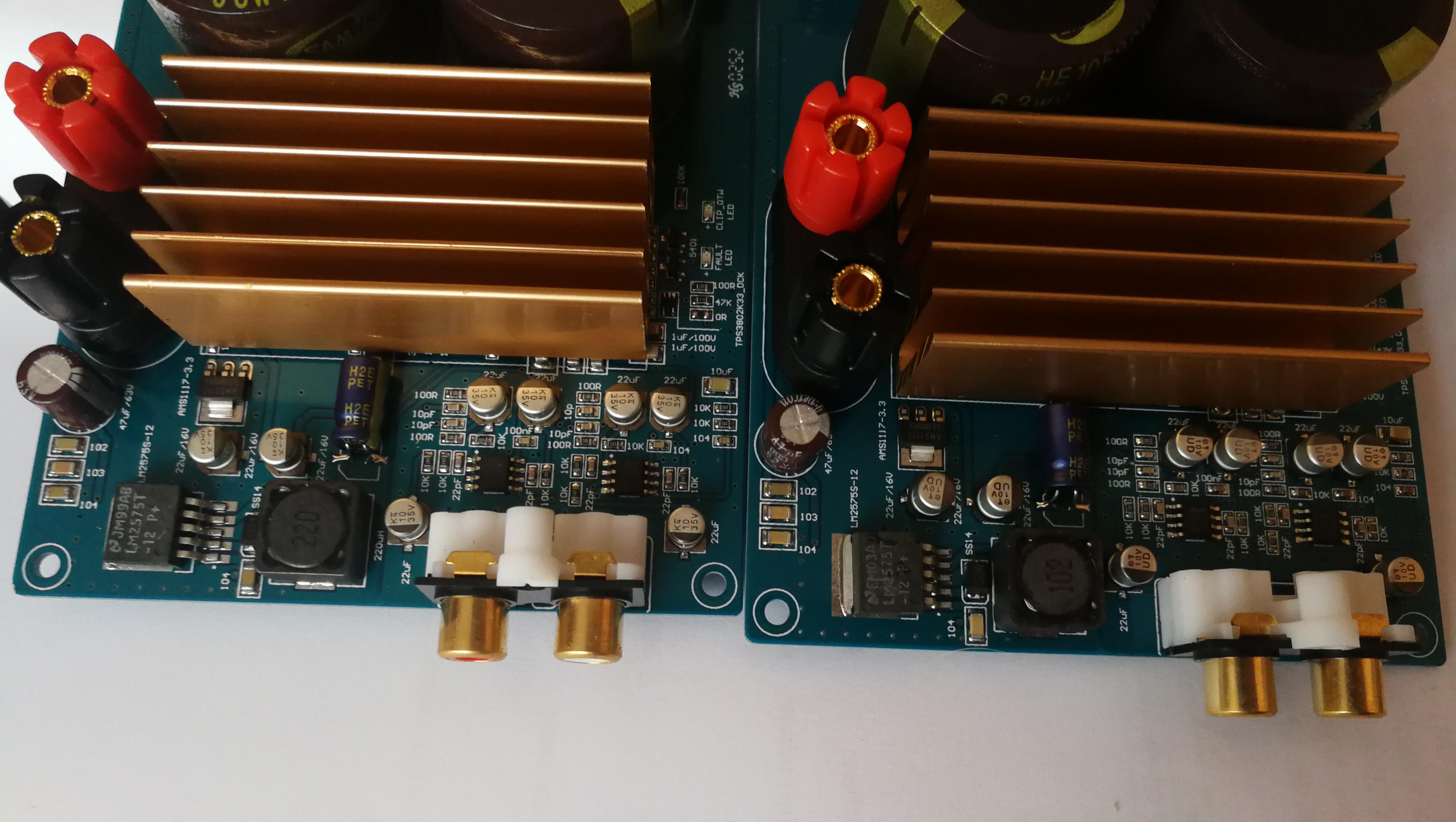

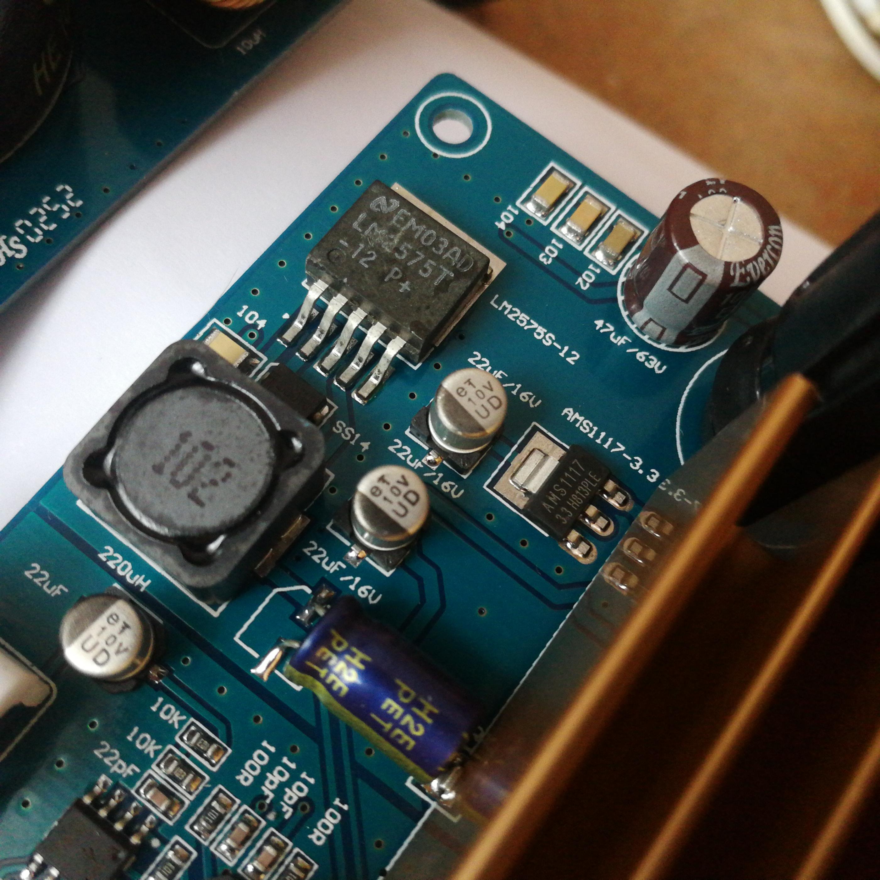

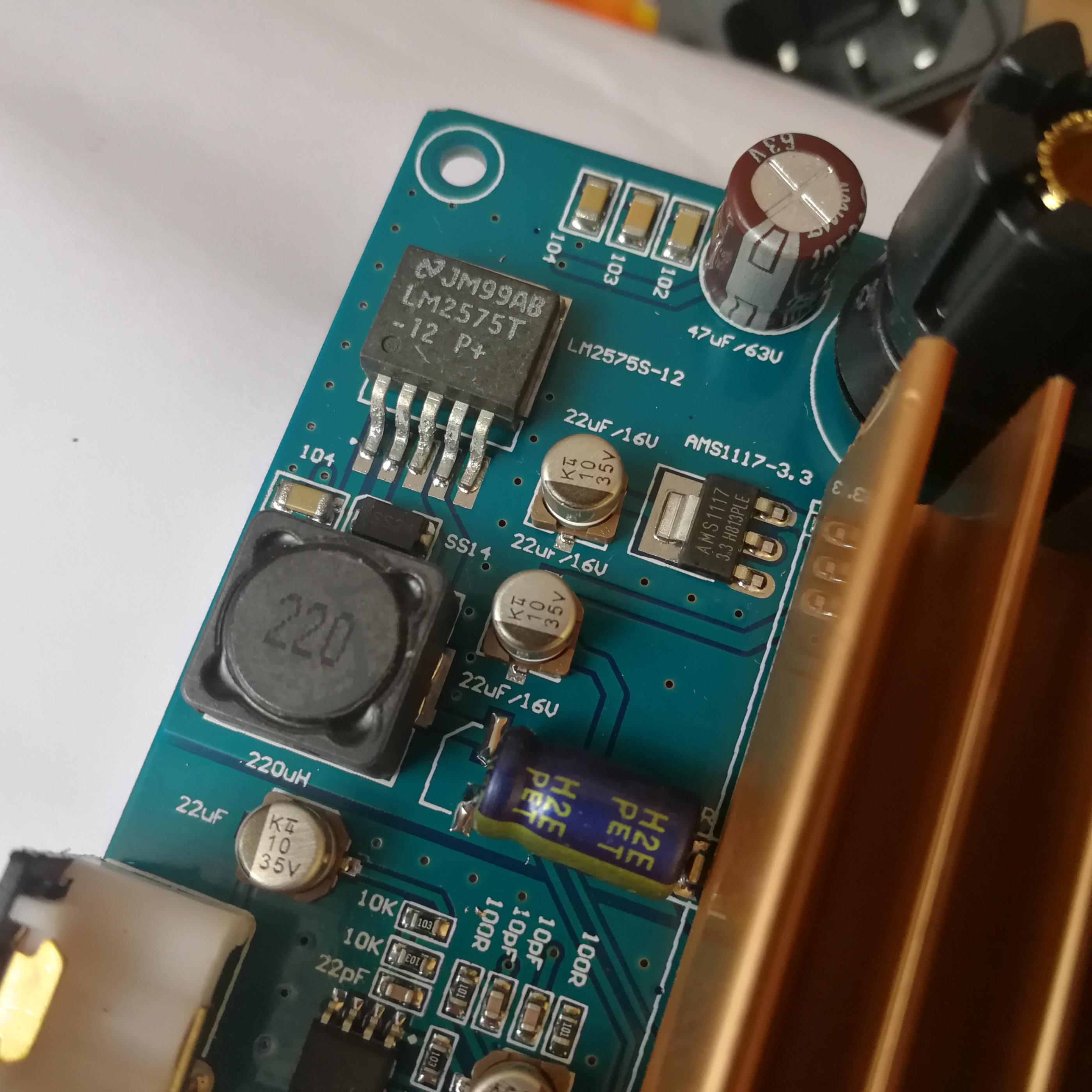

I ordered 2 Aiyima boards around New years, this is what I got... Single regulator for the 12V line, one for 3.3V. One has inductor 220, the other 102... Capacitors are equally strange, will have to change all of them. Of course no Elna caps as promised in the description
. LEDs are always on, upon clip fault one of them goes out. Other than random variations in components the boards work, have no turn on/off thumps and are built quite decently
