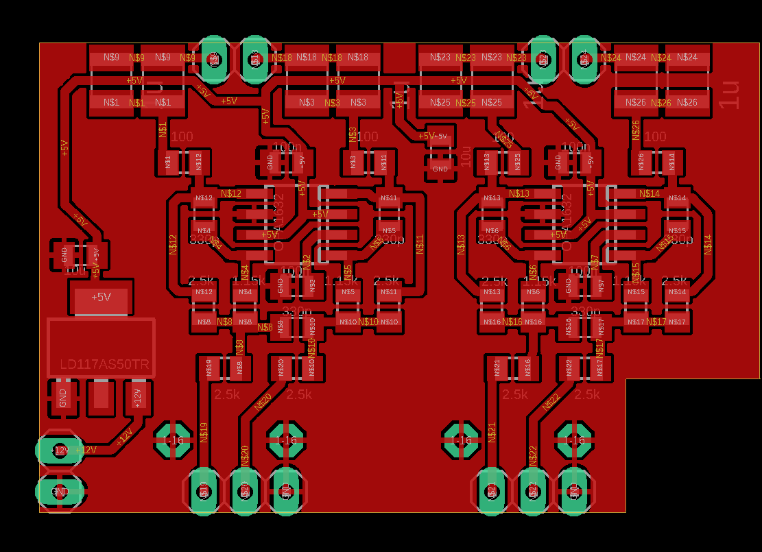

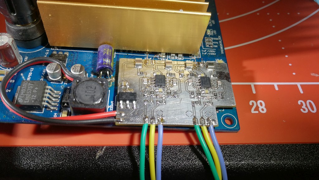

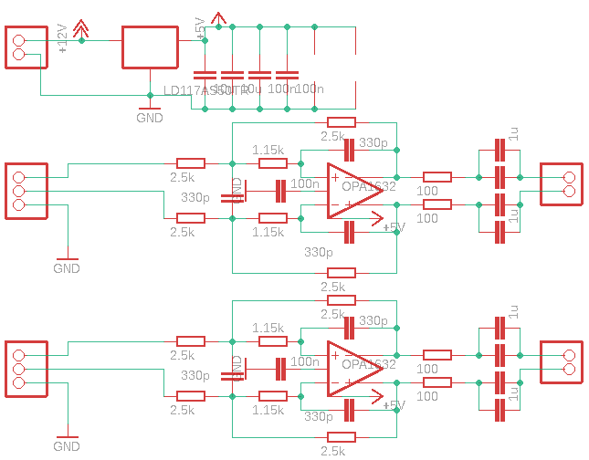

Hi everyone, I thought I'd share my variant of TPA3255 front stage. I used THS4531 fully differential amplifier, running on 5V - plenty for my power needs and doesn't need dual supplies.
Objectively speaking it has much lower noise than the stock TL072 opamps. No means to measure THD. Other than that - they sound alright

I'm presently away from home for at least one week, so cannot take a photo.
To disable the opamps I simply cut the leg of the power supply pin of each one - pin 8.
The 4x small capacitors nearest to the heatsink are the blocking caps. I removed these and soldered my input wires to the now-exposed pads where the negative side of the caps were ... but be careful, I completely broke off one copper pad altogether, which made it extremely difficult to then expose more of the correct copper trace.
Of course this method means you have no blocking caps - not a problem for me, my DAC has no DC offset - but you might need to add outboard blocking caps.

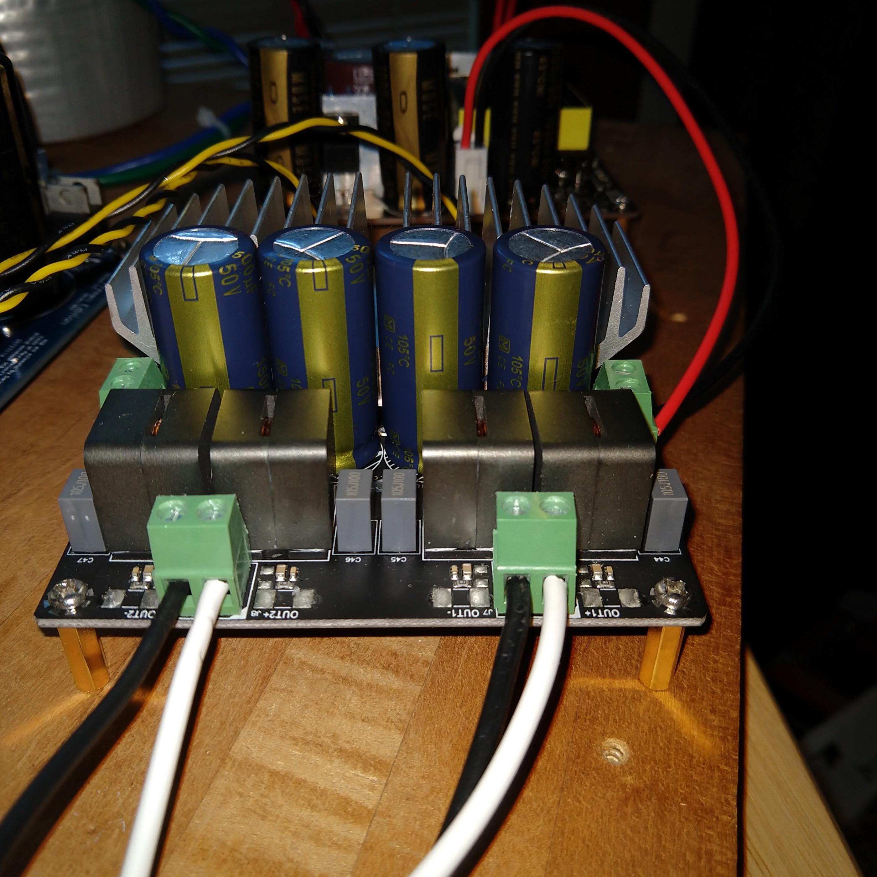

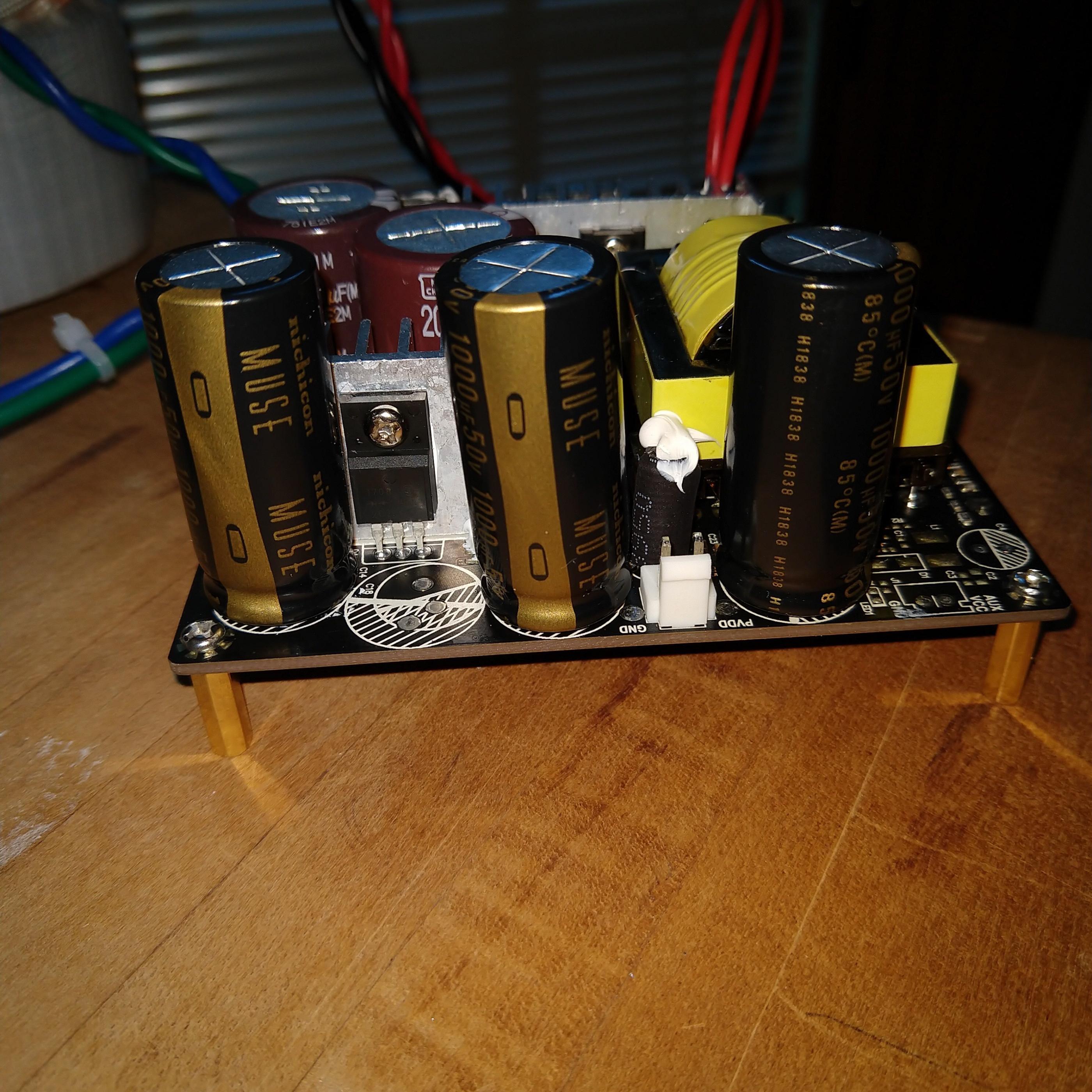

I came upon the thread after talking to a friend (an EE) who said I should look into the cheap Class D amps from China which sound amazingly good for their price. I’ve been building numerous Gainclone either based on the LM3875 or the LM3886 but have been disappointed with the lower frequency responses (even though the soundstage is pretty amazing when they are designed & built right). I’m using Genesis Physics model 210 speaker (8 ohm), an Akitika PR-101 preamp (bypassing tone controls) and a Cambridge Audio Dacmagic 100 modified as per this posting (Cambridge Audio DacMagic 100 – Audio Purist). So I bought the tpa3255 board from 3e Audio (260watt 2ch amp) along with the ICE2QS03G PS. They were so cheap what could I lose? I connected them all up (using the lightbulb protection startup routine). Everything sounded pretty good on the test speakers and not too bad on my normal stereo system. But there was no presence. It was a perfectly acceptable reproduction of the music (for the money I spent I had little complaints) but the musical reproduction was rather unexciting. I had some audio-grade caps left over from various Gainclone builds so I decided to experiment. I replaced the four cheap 1000uF/63V Chengx caps on the amp board with Panasonic FC grade 1500uF 50V caps. It was an immediate, dramatic improvement in the warmth and soundstage. Then I replaced the three (tiny) 1000uF 50V output caps on the PS with Nichicon MUSE 1000uF 50v caps. Holy cow! This amp sounds fantastic now! I would have skipped all the other Gainclone builds I’ve done (well not really..it’s was fun to build and experiment with them all & I learned a lot along the way). I just can’t believe how good this inexpensive Class D amp sounds now. Nuthin’ wrong with this TPS3255

Hi Alonper: I’ll repost the pictures. Hopefully you can see them this time. As far as the PS goes, he (3e-audio) stopped posting that unit on his website but he was selling them on eBay. I don’t know whether he still does. Here’s a link to the original unit’s posting ...hopefully you can message him and see if he still has any left.
TV Boards, Parts & Components for sale | In Stock | eBay
You don’t necessarily have to use 3e-audio’s PS. You can probably find others with the same power characteristics.
