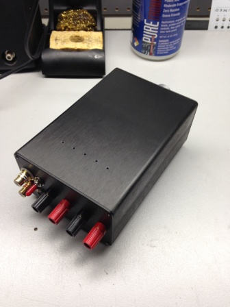

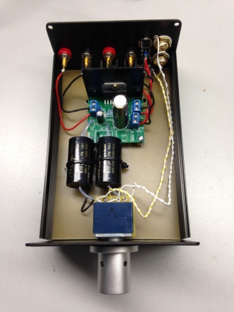

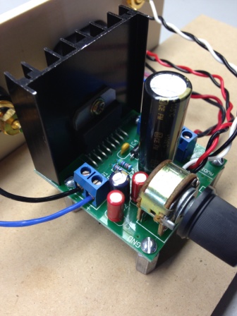

I have two of these amps, and I liked the first one so much that I decided to get a nice anodized Aluminum case for it. I bought this Context Engineering case from a local Fry's Electronics (a chain of electronics superstores that are the size of a department store). I swapped out the eBay-bought 21-step SMD resistor stepped attenuator, and installed an Alps Blue Velvet volume pot. I really like this amp a lot and it will serve well as an alternative to my tube amps.
Here are a couple photos of my second unit in prototype mode. I was going to leave it stock for a while, but without the upgraded 2,200uF / 25V Panasonic FM cap in the power supply path, it really lacked a nice low end and deep soundstage. I put that cap in and also upgraded the input caps with a pair of 1uF / 50V Black Gate N non-polar caps I had in my spare parts bin. I installed the SMD resistor stepped attenuator on the board. This photo doesn't show it, but it almost looks the same as the stock volume pot. This amp sounds great too, and eventually, I'll probably stick this in a nicer enclosure as well.

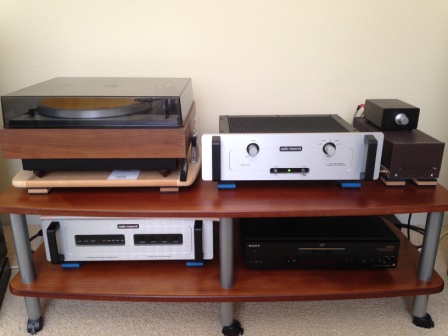

Both of these amps sound great with my turntable and Audio Research PH5 phono stage. This next weekend, I'm going to have some audio friends come over and compare these amps to my Audio Research LS7 line stage amp and Dynakit Stereo 35 power amp combination.

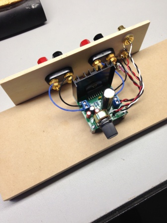

View attachment 386656 View attachment 386657 View attachment 386658
View attachment 386660 View attachment 386661

Very nice! Thanks for posting this. It's great to see pics of how others are using these boards.
A couple of quick questions for you.
Is the Alps pot out-performing the 21-step SMD resistor stepped attenuator?
What Value is the Alps?

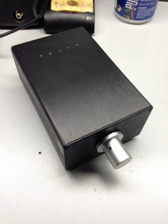

To my ears, the Alps Blue Velvet 100k log-tapered volume pot is equal to the 50k log-tapered, 21-step SMD resistor attenuator in terms of transparency and balance. I happened to have this Alps volume pot on-hand for a Dynaco tube amp project where I didn't need it after all. For the TDA7297 as an integrated amp, I wanted the ability to more finely adjust volume when feeding audio directly from my ARC PH5 phono stage or Sony ES SACD/CD player. The 50k SMD stepped attenuator seems to only give me about 2-3 positions before it gets too loud, so that's why I tried the 100k pot.
At the same time, I wanted a transparent volume pot to allow me to use this as a power amp when feeding audio from my ARC LS7 line stage for more tube magic. Here's a photo of the amp connected to my LS7 with the volume pot turned all the way up. Sounds great!

I seriously considered one of those kits, but it looks like the heat sink sits right over the two board mounting holes in the back end of the board. Other than that little quirk, the kit looks like a winner.

Good looking little box you have there rhing. Is that a Dual 122x series turntable I see there in your rig? I have a near mint 1229 that works as perfect today as it did back in the Summer of 1972 when it was new. 41 yrs old and still going strong. Actually, it's not in service at the moment due to a recent move and me trying to finish my man-cave.To my ears, the Alps Blue Velvet 100k log-tapered volume pot is equal to the 50k log-tapered, 21-step SMD resistor attenuator in terms of transparency and balance. I happened to have this Alps volume pot on-hand for a Dynaco tube amp project where I didn't need it after all. For the TDA7297 as an integrated amp, I wanted the ability to more finely adjust volume when feeding audio directly from my ARC PH5 phono stage or Sony ES SACD/CD player. The 50k SMD stepped attenuator seems to only give me about 2-3 positions before it gets too loud, so that's why I tried the 100k pot.

The turntable is an obscure Kenwood PC-400U belt/idler wheel drive turntable that was made in the late-1960's. It's basically Trio Electronics' (Kenwood's parent company) clone of the Thorens TD124 minus the eddy current braking system. Most Japanese electronics from the late-1960's seemed to make it to the US through servicemen who bought hi fi gear while serving in Asia. A friend who bought it through eBay received it from a seller who didn't package it well, so it sustained damage to the dust cover by the time he received it. My friend was so sour about the deal, he told me I could take it and work with it to see what I could do with it. The first area that needed attention was the platter bearing assembly, so I dismantled it, and polished the spindle and thrust bearing to a mirror finish. Next, I fabricated a new Delrin thrust bearing plate to replace the completely shot original Polyurethane plate. I went to the nearest Yamaha/Honda motorsports dealer for high performance Molybdenum grease and applied it to the bearing assembly. After that, I dismantled the stock Jelco SA-100 tonearm and polished the pivot bearing cups and points and re-wired the arm with Cardas phono wire and added a little damping material. It took me a while to figure out how to balance the tonearm with no manual available. This turntable is a rare find, so it's not like I could consult a lot of people through Web forums for help. Another friend gave me a Talisman Alchemist IIB high output moving coil cartridge to replace the Shure MM cartridge. My friends and I have had turntable shoot outs with this turntable, a rebuilt Bogen Lenco L75, an Empire belt driven TT, a Thorens TD124 and a Sota Sapphire. Everyone loves the dynamic response, drive, huge soundstage and detail that this TT produces. The icing on the cake was finding a matching Kenwood dust cover for $20 through eBay.
I would love to get my hands on a reasonably-priced Dual 1229 or Dual 1019 TT to refurbish. I used to own a Linn Sondek LP12 with an Ittok II arm and Grado Signature MM cartridge, and it was a great belt drive TT, but I've converted to the idler wheel drive camp. My uncles who were audiophiles owned McIntosh amps, Fisher amps, AR loudspeakers and Dual turntables. I have very fond memories listening to their stereos with those German turntables.

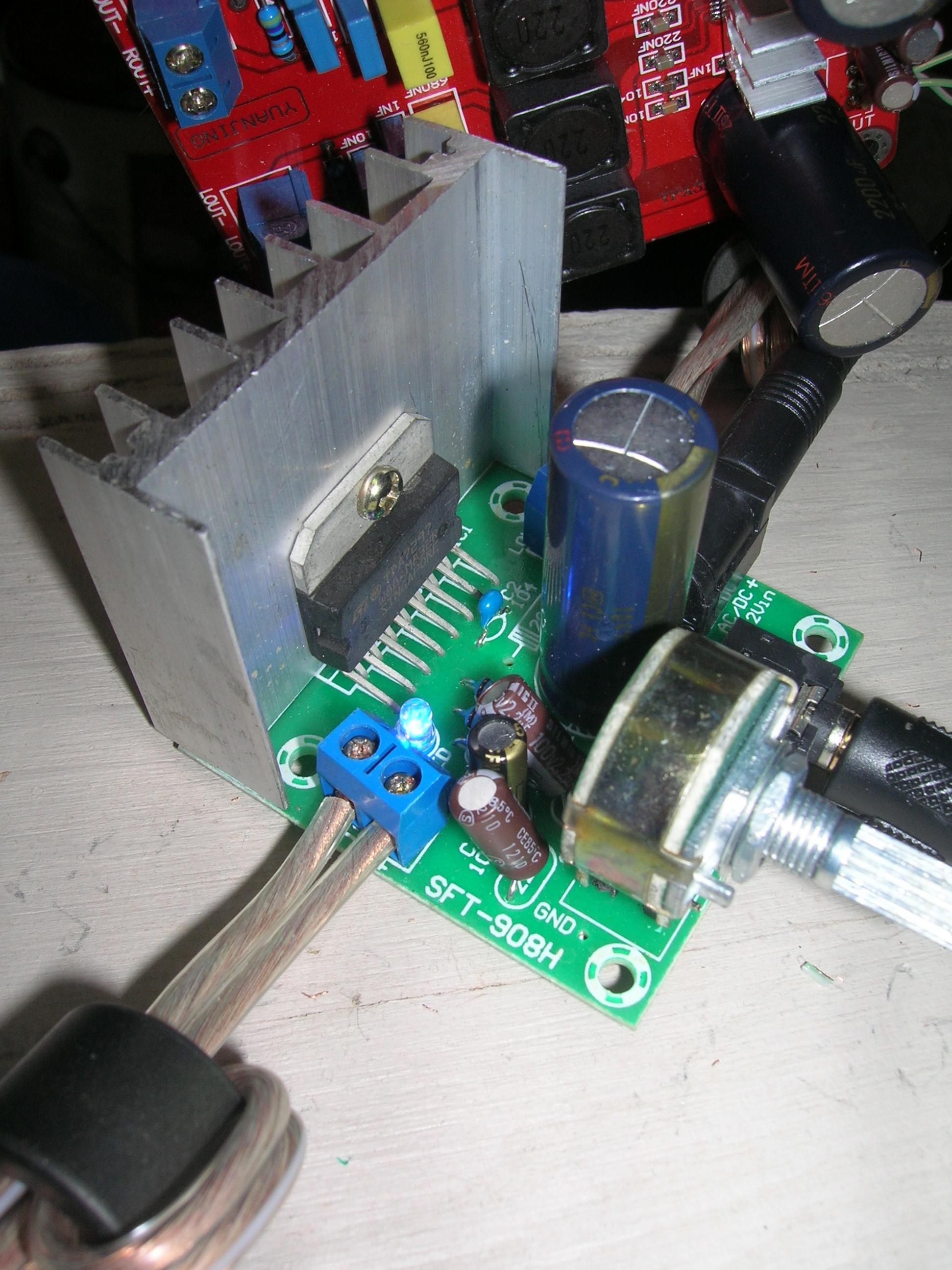

I got the TDA7297 with the SMD devices, the pot works poorly at low volumes. I doxited it, and now it is just sloppy, problem still there. The Alps RK163 series seem to fit, but they are $13 at mouser. Anyone find a good, direct fit replacement pot?
I just found a cheap replacement pot, in case anyone is interested. Not as good quality as the other ones discussed here, but should work as an inexpensive ($1.68) replacement of the non functional original. It would be the Bourns PDB182-K430K-503A available from digikey.

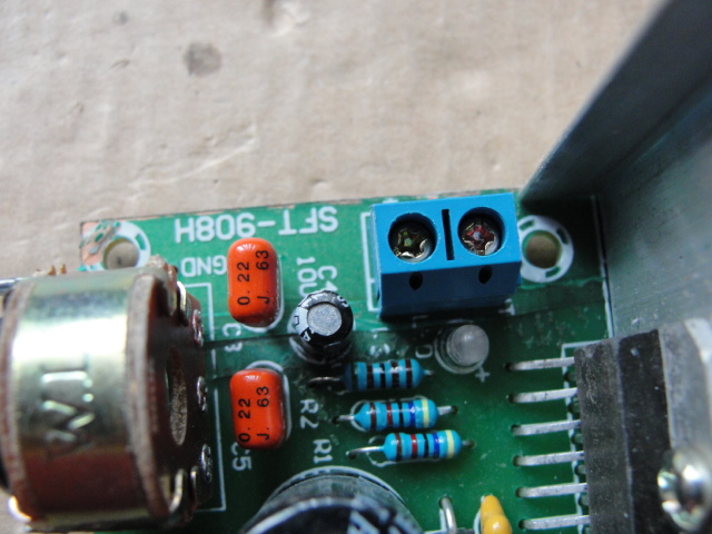

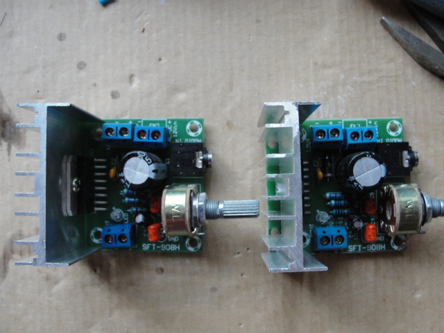

Ok, I have been reading this thread and after I received the amp boards, I decide to chime in....
I bought two boards from another seller that was not mentioned in this thread. But I paid only $4.5 each. The package came from China so it took almost 3 weeks to arrive.
I ordered two and have only tried one board and listening to it while I'm typing this. It was really hard to believe this board can deliver such good sound. It does sound tube like and no where makes you think this is a class AB chip amp.
The volume pot is L/R balanced. I don't notice any side weaker or stronger than the other. Everything is stock now and the power supply is a small uA723 regulated linear supply set to 13VDC. The amp is quiet, not hearing any noise when there is no input signal.
After I tested it out on the bench, most importantly to measure the output DC (15mV/7mV, L/R), I moved it to the living room have it now driving my Tannoy 611 MKII floor. Lots of volume to spare and very enjoying to listen to.

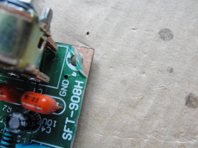

The other board has a kind of problem. The PCB is supposed to be single sided, meaning the component side should have no copper trace. But the PCB has manufacturing defect. There is a large area of copper remains on the component side (see pics). I don't want things to short-out so I haven't test it yet. But I will just put it on test bench using the lowest DC voltage to try out later. If it works, I probably will de-solder some components and drill out some copper so it will not cause a short circuit....

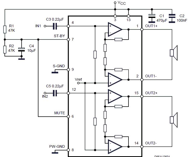

By the way, what are those .22uF input caps. Are they worth keeping ? or better replace them ?
But "What the heck? I paid $4.50 !!!!"
You're doing great! It's fun isn't it!
Those .22 are the input caps and they can be changed.
The other board's ok, that's just the paint/varnish coming off the copper. Just put electrical tape over it and you're good to go!
![TDA7247 schematic.JPG TDA7247 schematic.JPG](https://www.diyaudio.com/community/data/attachments/350/350877-d4df53e37d6172ed8275758488751c6a.jpg)

So what you should do is keep one stock, compare to get a baseline and then start your mods one at a time and listen for any difference. It's a blast, you'll love it! I commend your jump-right-in DIY style!
