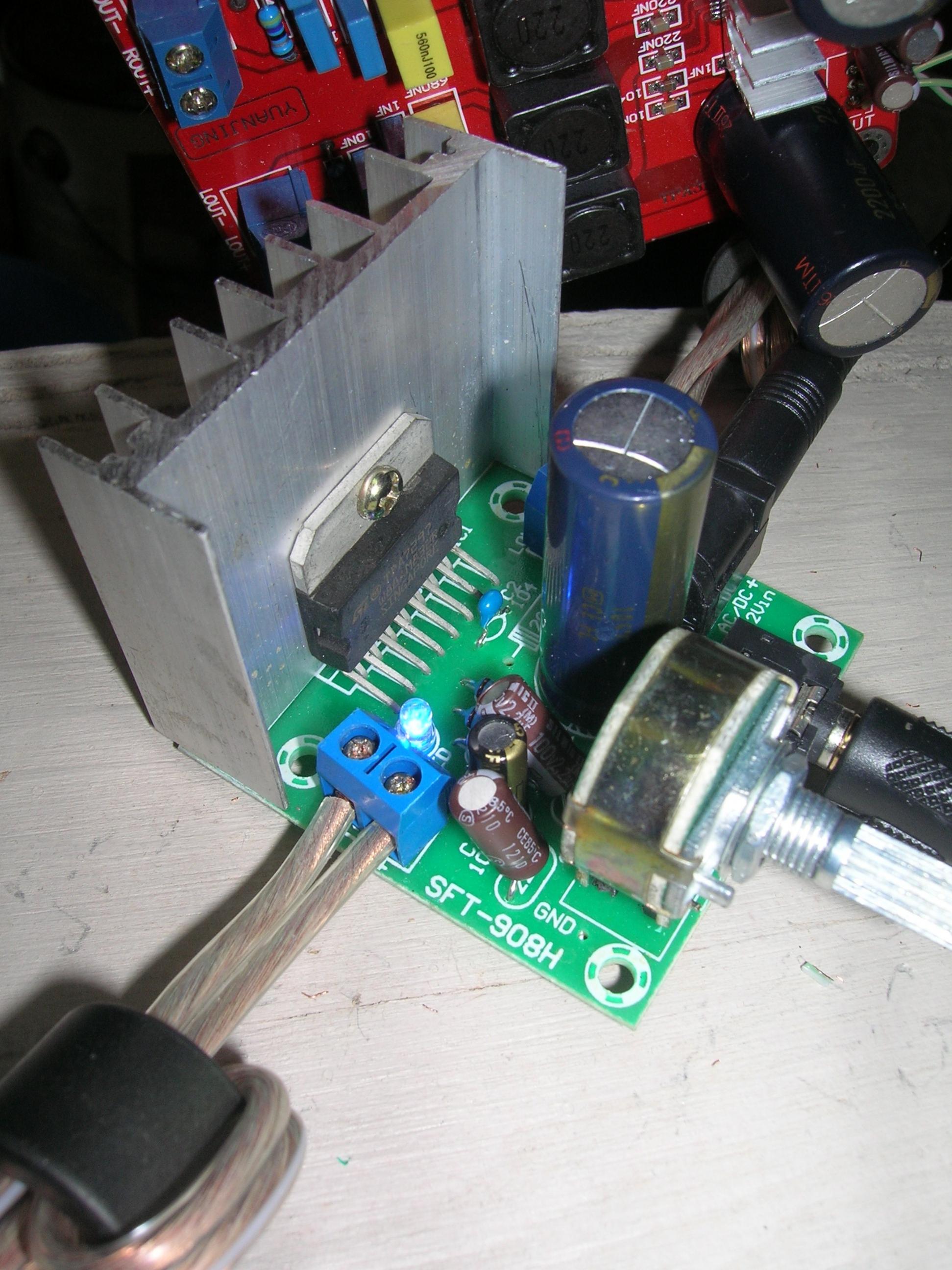

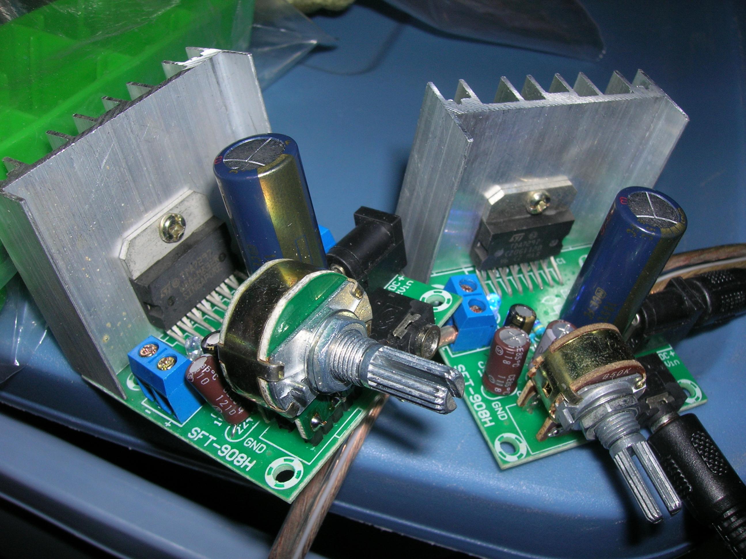

What value of Elna Silmic II caps are you using?
2.2uf/50v, ok so far.
...I'm also interested in the purpose of the Schottky diode. It looks like it's wired across the DC voltage.
Umm, err ... that's why it says "AC/DC 12Vin". I guess you didn't realize the true awesomeness of this little amp!
I'm using a few different AC wallwarts wadapter and a 80V 5A Schottky for ps. (Schottky has quieter reverse recovery spike or some such ...)
Yep, you can use all those old beefy AC adapters--I had one from my old ART DIO DAC. !!
I have a stash of Blackgate N 1uF /50V caps. I may have to try those on another board.
Duh, I thought that was a typo or something on the board -- very interesting.
My speakers only require .085W each to produce serious living room filling sound. What advantage could I expect by changing a component or two (diy?), I'm certainly not lacking in the bass department?But, but ... where's the DIY in that?
I have a stash of Blackgate N 1uF /50V caps. I may have to try those on another board...
Perfect! If they're polarized just make sure the stripes are to the inside.
...Duh, I thought that was a typo or something on the board -- very interesting.
DC wallwarts have crappy diodes in them. This way, you control the AC to DC conversion. Start with one, then try a ... diamond with 4 ... on each side ...
... awesomeness!!!

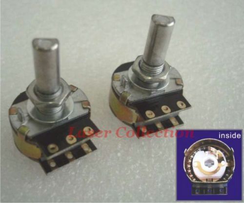

PS cheap ebay sm stepped atten was the perfect addition for me. I have high eff speaks so I was always fiddling with the pre-9 O'clock positions on the stock vol (B50k). I subbed in my 10k sm stepped and ... perfect!!!
Lots of volume choice down low and ... perfect channel matching at the lowest volumes!
Well, since you are low power and have good bass I'm guessing you have high eff speakers (and maybe big ones with a 15")
Do you find you're fiddling with very low settings on the volume? If so, then the pot mod is for you!
Dact Type 21 Stepped Attenuator Potentiometer 50K D | eBay
DACT Type 21 Stepped Attenuator Potentiometer 50K
(I'd go for 20k or 50k not 10k like what I had lying around)
If you use angled pin headers on the inside, it fits perfectly!
Excellent channel matching, many low level settings, repeatable volume settings ...
Next would be the input caps and if you increase the value, also increase C4 so the mute stays on longer.
Then the ps reservoir and high freq cap (max voltage for the chip is 20V so you can use good quality, large 25V caps that fit the 5mm pin spacing)
The diode if you're doing AC (then more advanced diode networks--4) and maybe remove it if you'll always do DC and be careful and then
well there's no more parts to replace!
Ah, but then notice that the chip is really divided in two and has ps for left and ps for right ...
So you want a sweet ps network for each side! AndrewT setup ...

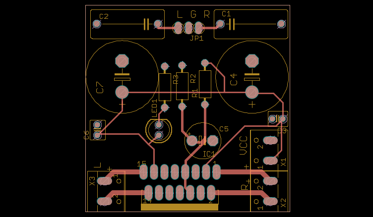

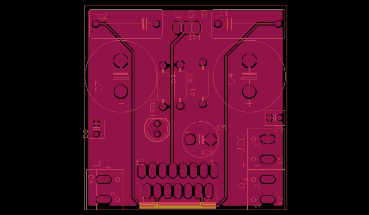

I started messing with pcb designing so, as I have one of this amps and I was a bit bored, due to the simplicity of the schematic I made a new pcb layout using "premium" components. Why I did this, cause I was bored, there is no more...
Here you have the eagle files and gerbers in case anyone is interested in trying it...
I did calculate more or less the cost per board using Jantzen cross 0.22uf cap for the inputs, using 0.1uf Wimas with 4700uf panasonic FC series, and including the cost of the IC and the board it would be around 8€, more or less around $11... Still not bad all...

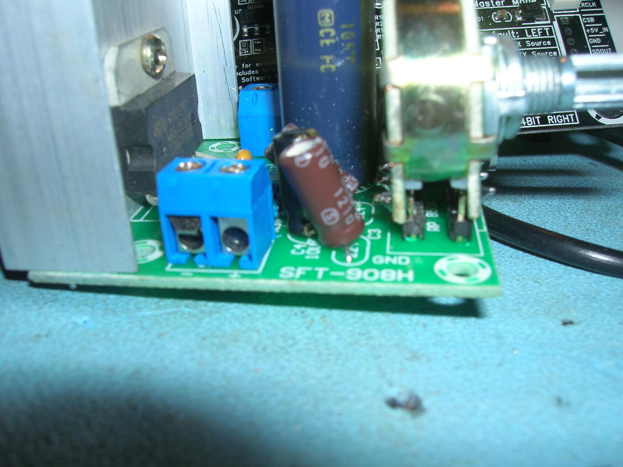

Step atten, sm 24 pos 10k
Silmic II 2.2/100V input caps
FC 2200uF/25V ps cap
100nF, 100V X7R ps cap
increased C4 mute cap
Schottky on the bottom. (That's what she said!)
The 50k log tapered 21-step SMD ("SMT") stepped attenuators from auction sellers lasercollection and tube_buyer will fit nicely on the boards. However, you have to use wire like 20ga solid core wire to fabricate pins on these stepped attenuators to fit onto the board. It's not a big deal if you're handy with needle nose pliers.

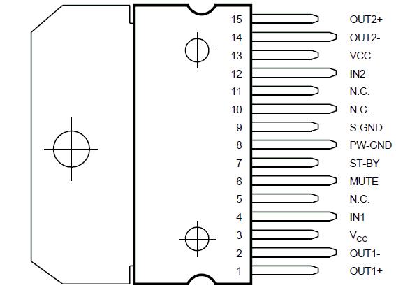

It is possible to connect a 1N5405 to each of those pins and then re-stiffen the power with good quality capacitors (possible range is from 100u to 660u) from Each ps pin to ground. That'll give you dual mono with just one power supply.Ah, but then notice that the chip is really divided in two and has ps for left and ps for right
Added parts:
a diode and a cap for left
a diode and a cap for right
I haven't tried it with this amp yet, so I don't know the optimal amount of forward voltage drop nor the optimal amount of capacitance to follow it.
Typical is 0.65vf with 440u.
