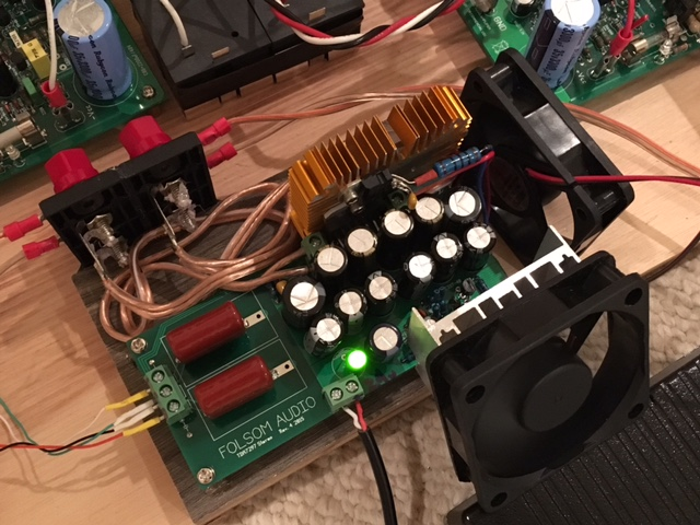

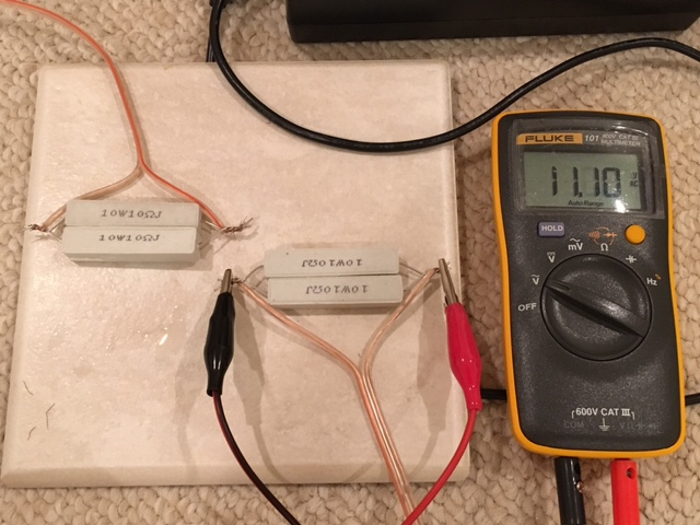

Ok, as promised I hooked up both left and right channels to a 5ohm (10R 10W resistors in parallel for 20w 5R). I was able to get 11.10v before clipping on boh channels so that's 24.6w or about 25w per channel. I had to put some external forced air cooling onto the heatsink for the shunt regulator transistor - it got pretty hot. The power resistors had some moisture in them which started boiling off and pretty soon they were almost starting to smoke. You could smell the heat. The amp itself was fine - I ran it for 20minutes and nothing burned or died. It's actually pretty amazing how much power this little Lunch Money chipamp can put out. If I were to change the resistor network to boost the shunt regulator voltage a bit higher (it's at 17.0v now) maybe 19v or 20v even as the input smps is 24.5v, It can probably do a little more than 25w. I don't have a THD distortion measurement rig yet so who knows how much distortion this is. Just know it can put out power if pressed into it.
Setup with extra fans to keep cool:
Cooking some resistors and clocking in at 25w/ch with 17.0 volt shunt regulated power supply:

If you used my exact specified parts you'd get 17.8v. Anything beyond 18v presumably causes breakdown of the internals in the chip. 20v is the max where it'll play absolutely fine but with a potentially shorter life span. Beyond 20v it could go at any moment. At least that's how the datasheet reads, and how it's suppose to be. Clearly it's not the definitive picture as you've shown.
You may be experiencing a few things differently than people with the spec'd parts. The KMR section may or may not be operating to full capacity. :p Still your test shows us there's no benefit to running 1 channel from 1 chip. You can tie the inputs and outputs however; it might result in very minor smearing, but your application will have more to do with the need for this manoeuvre.
For the record, I once had a chip at 23 volts not knowing it... back before the final design. It sounded wonderful! But who knows for how long...
Oh and are you using a 560R instead of 536R? If you parallel it with a 12k you should get correct voltage.
*Also you could drop the input voltage of an SMPS to 21-22v. They hold pretty steady instead of voltage dropping as much as a linear at 23-24v would do that helps keep the transistor cooler.
The only other person who got so much heat from the transistor (albeit using the correct one, not something else) had it in backwards!
Thanks for the test. That's over 2 amps current per channel, and I assumed the datasheet was indicating a max of 2 amps current per chip. How much current can the PS provide? Seems like with 50% efficiency it would need to supply 8 amps current???
Again, xrk971, thanks for the experiment. I love this chip!
I may also try the TDA7266M, which appears to be the mono version of the TDA7297. Two of these should run cooler than one TDA7297.

I was using a 24v (measured at 24.5v) 5 amp SMPS.
25w in a 5ohm load is about 2.24amps from P=i^2 R, i = sqrt(P/R)
11.1v output and input to amp was 17.0v so that is 5.9v drop across the chip's output transistor. P=iv or P=2.24amp x 5.9v=13.2w x 2 channels = 26.4w dissipation.
The shunt regulator dropped 24.5v down to 17.0v or 7.5v drop for P=iv of P=2.24amp x 7.5v = 15w x 2 = 30w dissipated from the shunt transistor (seems about right it was hot and needed the fan).
So total power generated as heat = 50w at load resistors + 26.4w at chipamp + 30w at shunt regulator = 106 watts
Total power capability of SMPS = i V = 5amp x 24v = 120w
So all this makes sense and we were basically at the limit of the PSU. If the shunt regulator had been set to a higher voltage, less would have been burned off as waste in the shunt and more in the load and chip.
These are so cheap, maybe do a test and run them at 20.5v and see - should still be enough headroom for regulator.
Edit: I made a mistake in the analysis for the shunt regulator power dissipation - it is not in series with load and is actually less than the load current as it burns off what is not needed to leave 17v behind. Perhaps the power would be split by the ratio of the voltages so 7.5v/24.5v=30% total and chipamp has 2.24amp for 70% or about 1amp through shunt. So 1amp x 7.5v x 2 = 15watts.
So more like total thermal ouput = 50w at load + 26.4w at amp + 15w at shunt = 91w
Feel free to correct the above analysis if in error... :)

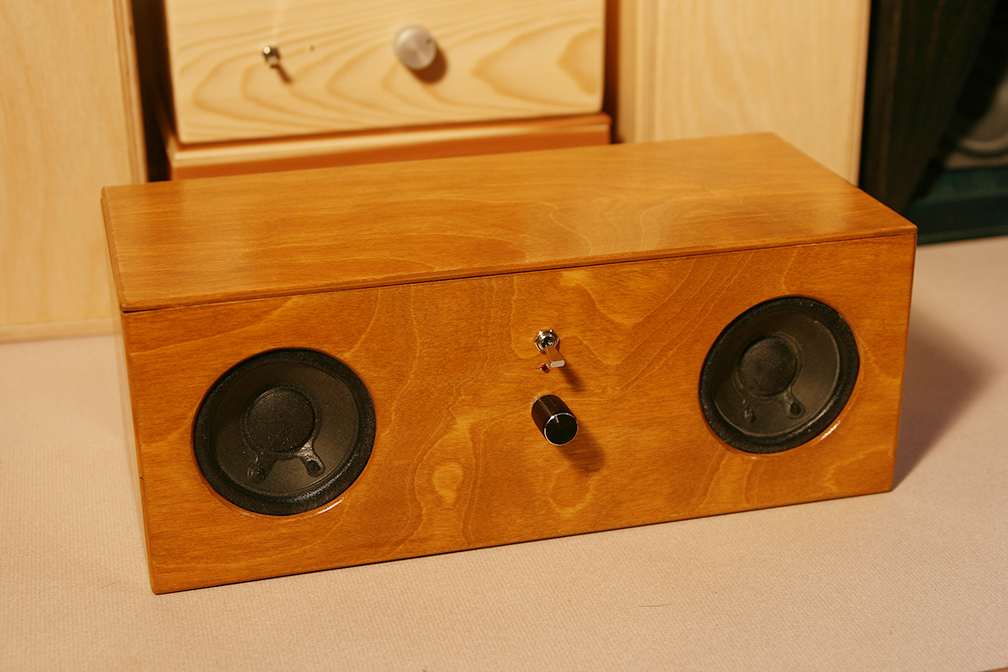

I have been messing around with these little amps and speakers found at thrift stores for a while. I’ve built 12 of them now and having lots of fun. Some of the drivers come from Sony, Technic, Polk Audio, JVC, Cambridge Audio and most recently Paradigm. It’s really amazing how well they perform. Here’s a few of the most recent ones.
The boxes are made of Baltic Birch ply stained and varnished. Hope you like them.
