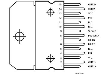

Tantalum capacitors
I have a question. I've read tantalum capacitors have a direction/polarity.
I have this board in use right now and I replaced the two tiny capacitors labelled "224" with larger value tantalum caps.
Here is the board:
AC/DC 12V TDA7297 2x15W Digital Audio Amplifier DIY Kit Dual-Channel Module JKHW 834093921900 | eBay
I question if I installed them correctly. Can someone straighten me out?
Let's assume you are looking at the top of the unit, with the volume pot in from of you. And the larger, 10uF capacitor is on your left. And then, let's assign a number to each of the 4 holes the tantalum caps would go in from Left to Right. Or, in other words, there's that larger capacitor (the 10uF one), then holes for the tantalums are 1,2,3,4.
I order to determine which of the holes were "negative", I used a multi-meter set to beep when I have continuity between a known ground (the ground of the input part of the board) and then I put the other lead of the meter on each of the four holes: 1, 2, 3, 4.
I determined 2 and 3 were making a beep with the ground of the input. Therefore, the negative leads of the capacitors would be inserted into 2 and 3. And, I put the new tantalum capacitors in with the negative leads inserted into holes 2 and 3.
YET, when I looked at my untouched, unmucked with master tda7297 both of the caps were facing the back side towards the chip. If I am not getting confused, this would make holes 3 and 1 the negatives. (And, not the way I have installed my new capacitors).
Could someone help?
I hope this isn't too confusing.
Just tell me:
1) Are tantalum capacitors really polarity dependent?
2) Given my numbering system where hole #1 is (top side view) closest to the 10uF cap, and #4 is the farthest away... tell me the what if the positive or negative lead goes into each hole.
For example:
#1, 2, 3, 4
Some explanation like that would be great.
Thanks,
Mark

Hey Mark
Do the capacitors have any + - markings?
From the Ebay picture of the bottom for the board, The two middle holes are connected to the volume control, not ground. Weird.
If they are polarized, most applications I've seen have the + side of the capacitor facing the chip. In your case that would be holes 1 and 4.
Hole 1 should connect to pin 4 of the chip.
Hole 4 should connect to pin 12 of the chip.
These are the chips inputs.
Mike
Hello Mike:
Yes, tantalums (as I learned after I installed them!) are marked with a +. And the longer lead is the +.
And, yes, the holes I designate at 2 and 3 do go to the middle portion of the volume pot.
I got continuity from 2 and 3 to the ground of the input. That is why I thought those were the negative "holes".
Mark

I see on my unmucked with, "master" board that the writing on their caps faces the chip. Assuming the caps were put in correctly on this master board and, according to my numbering system (when viewing from the top of the board) where hole 1 is leftmost, or nearest the 10uF capacitor, and hole #4 is rightmost, or nearest the large filter capacitor that would make the holes:
#1 +
#2 -
#3 +
#4 -
I did not catch that my capacitors were marked with a +. And I wrongly assumed the longer lead was the - lead. When actually it is the + lead. Also, as mentioned before I thought that holes 2 and 3 were -. (Whether they actually are I still don't know.)
So, in fact, I actually installed mine this way:
#1 -
#2 + (originally thinking this lead was a negative lead)
#3 + (originally thinking this lead was a negative lead)
#4 -
So, I am guessing if I re-orient my first cap in holes 1 and 2 it will be correct?
Mark

I got continuity from 2 and 3 to the ground of the input.Mark
Hey Mark...
Perhaps the term continuity is a little misleading.
If the volume control is turned fully counter-clockwise, there will be around 0 ohms between the input to the caps (holes 2 and 3) and ground. All the signal goes to ground (quiet).
If the volume control is turned fully clockwise, there will be 50K ohms from the input to the caps and ground. All the signal through the caps and into the amp (loud).
There is always continuity, but not always 0 ohms.
Mike
Hi Mike,
So, you are telling me my test for continuity was not valid for determining which of the holes was "negative"? I was trying to determine where to place the negative lead of the tantalum capacitors.
What would have been a better way to determine how to orient those capacitors?
I guess what you are telling me is I need to look at the chip pin out and determine it from there. I will check that but it may not mean all that much to me I have to admit.

Just wanted you to understand that the inputs to the caps are not ground
. If you were to pull out the potentiometer holes 2 and 3 would be floating.
Technically, you could connect a preamp directly to holes 2 and 3 and be just fine.
Although they will work (not sure if the orientation matters for an AC signal), I'm curious why you are going with an electrolytic cap in the first place?
