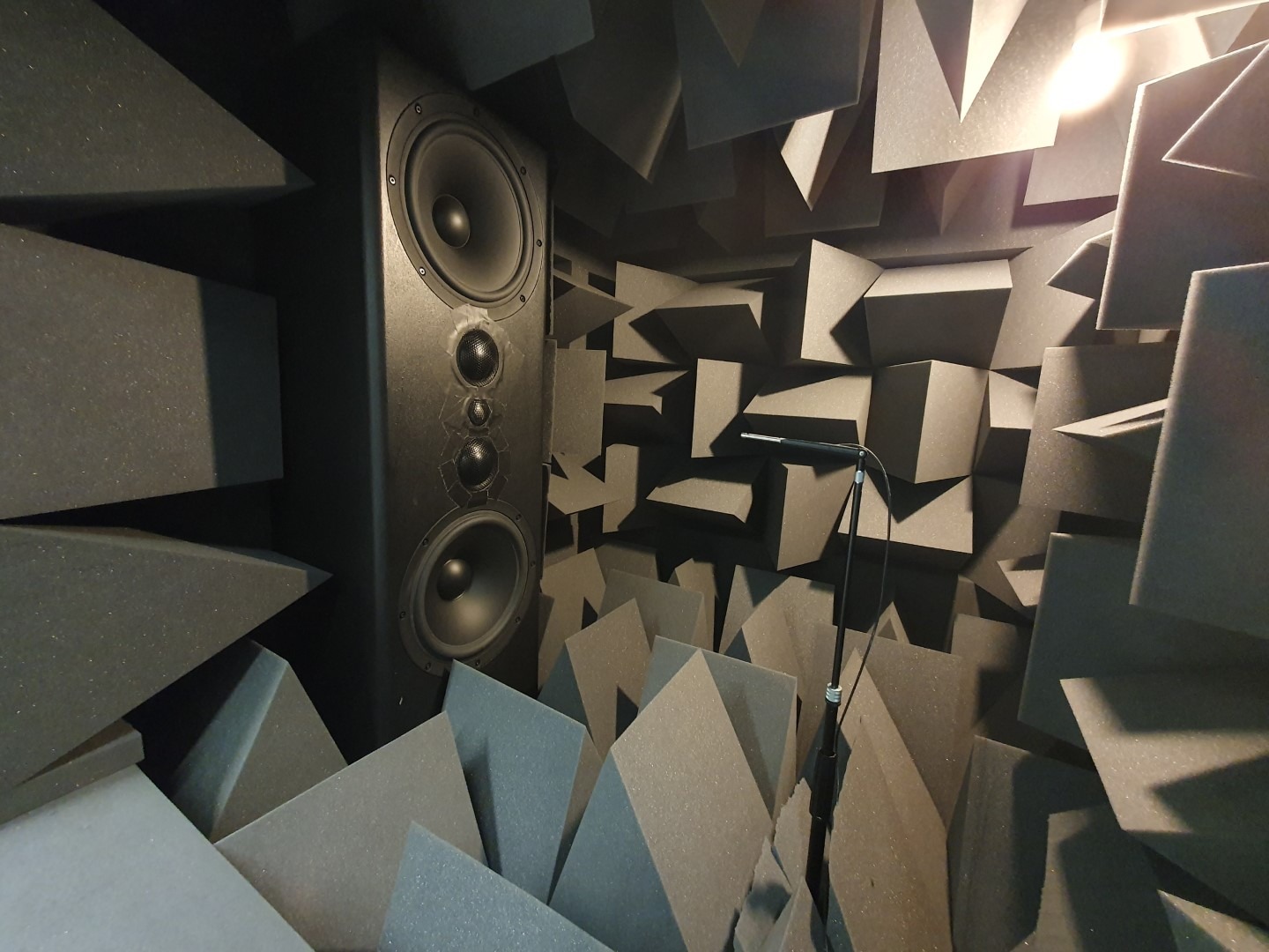

I made a reference speaker for microphone measurements from 10Hz to 100kHz and a little striped down version of that you can see here:
Could you also show us a picture of this one which perfoms from 10Hz to 100kHz?
These chambers are not big, you get pressure chamber behaviour at low frequencies and can go down lower as 10Hz without problems. 100kHz is more tricky ... Level after the membrane resonance does not fall to zero but you have a lot of influences from every little thing on the front panel and from the speakers themself. With quite some tuning you can get 94dBSpl at 50cm up to 100kHz. (of course the speaker get's EQd for a linear measurement)

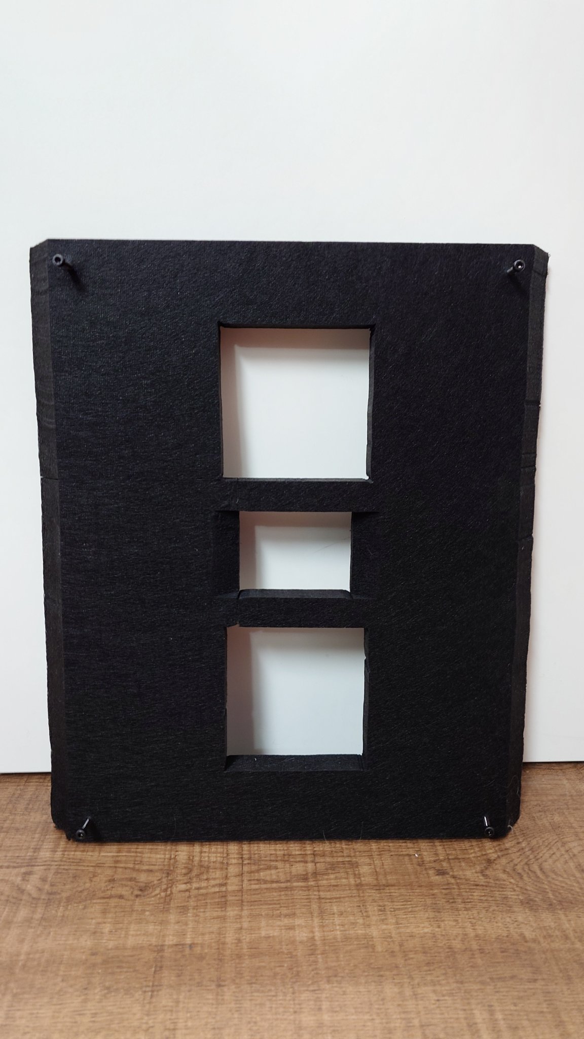

... you have a lot of influences from every little thing on the front panel and from the speakers themself ...
What a nice view! Your foto precisely shows nothing but the average loudspeaker tinkerer's secret dream ...
May I comment about the tapes on the baffle: Well done! It matches my experience that it is worth to even out any irregularity of the ideally plane baffle, as long as possible. And while proceeding in this logic - did you testwise try to even out also the 2 x four centermost screwpoints (centermost related to the center point of the baffle) of the bass drivers? And also the micro-small circular notch between the rim of the drivers and the baffle cutout? These structures are in the direct projection lanes of the Mids and the Tweeters on the baffle plane, and they eventially, as acoustically small as they are, might contribute to tiny, but in search of perfection avoidable diffraction artefacts.

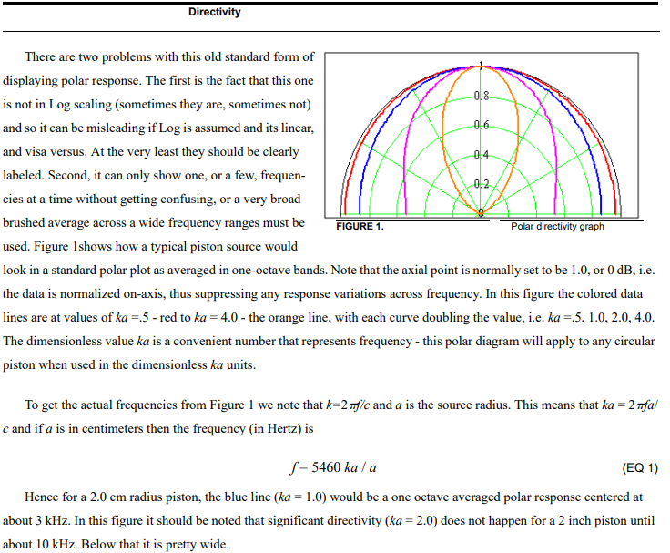

The algebraic structure of the Ka equation is a bit odd, and to me, a bit confusing.
It is often expressed as something like "the Ka=2 frequency for that driver is 1000 Hz". If we work through the math, that driver would have an Sd of 375 cm^2. This is an odd way of expressing an equation, and it is overly complicated.
To the best of my understanding, the "a" in Ka is the wavelength which is equal to the apparent circumference of the diaphragm. So if the Sd is 375 cm^2, the apparent diameter is 21.8 cm, and the apparent circumference is 68.6 cm (pi * diameter). A wavelength of 68.6 cm has a frequency of 500 Hz
So Ka=1 is 500 Hz. Ka=2 is 1000 Hz. As I said, it is an odd way of expressing this math... "Ka=2 is 1000 Hz" is NOT a mathematical expression, it is some kind of jargon shorthand.
I hope this helps your understanding.

http://www.gedlee.com/Papers/directivity.pdf
KA represents a unit/degree of directivity for generic piston.
Thanks @camplo, I had misplaced my documentation and was working from memory.
So Ka is a dimensionless number, like Reynolds number or Prandtl number or Mach number.
Ka = 2*pi*f*a/c, with a=radius and c=velocity of sound
From my point of view, the equation "Ka = some constant" is most useful when we know what value of Ka we want, and we need to find the frequency f.
So making a useful algorithm from this, the first thing I would do is substitute r for a... It is much easier to associate "r" with radius.
Ka = 2*pi*r*f/c.
f = Ka*c/(2*pi*r) = Ka*c/circumference
If we know Sd, we can calculate either circumference or radius... our choice.
edit: since we most often know Sd
Just keep in mind that the units for C and Sd have to match... if Sd is in cm, then C = 34300 cm/s at room temperature.

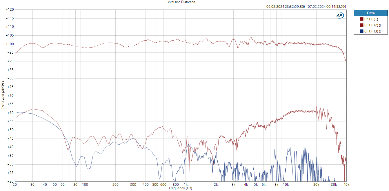

Correct me if I am wrong, but to see meaningful H3 at 20 khz, we need response out to over 60 khz, and a microphone and measurement tools to see this as far as I am aware. H3 at 30khz, would need response out to 90 khz in the same way.View attachment 1271170
H3 goes down from 2kHz. The tweeter is producing even less H3 as the 3" midrange. And we are talking of about 0,03% of H3 ... most setups can't even measure that
So in THIS case the tweeter is producing some more H2 and less H3 as the midrange at 2kHz. Both produce exceptional low THD!
Most home gamers are only able to get meaningful H3 up to about 7khz. Also depending on the windowing applied to the measurement, there may be not enough resolution, in other words the bins may be too far apart.
This is still a prototype setup of the installation - I can not show the complete setup with the ref & DUT mic setup installed. But there is an absorber addition to further minimize interaction between chassis. I will post a complete pic in a few days if thats interesting.What a nice view! Your foto precisely shows nothing but the average loudspeaker tinkerer's secret dream ...
The lf drivers have no influence to the tweeter any more (which was a positive result) and the midranges don't run to high frequencies. I make bigger roundovers of the corners with the actual version of the speaker to reduce baffle step a bit more. Tweeter front mesh produces a notch at 45kHz which is not nice cause we have to compensate fir that and it pushes a lot of power in the tweeter.
There is a lot of tinkering to get these details right - nothing you need for listening at all cause most of these effects are at frequencies out of the hearing range. But it's a really cool project and you learn how to do it right.
The audio precision measurement system runs up to 80kHz and my Earthworks M50 is very linear up to 50kHz. For measureing higher frequencies I use 1/4" mics from GRAS or B&K, depending on the measurement setup.Correct me if I am wrong, but to see meaningful H3 at 20 khz, we need response out to over 60 khz, and a microphone and measurement tools to see this as far as I am aware. H3 at 30khz, would need response out to 90 khz in the same way.

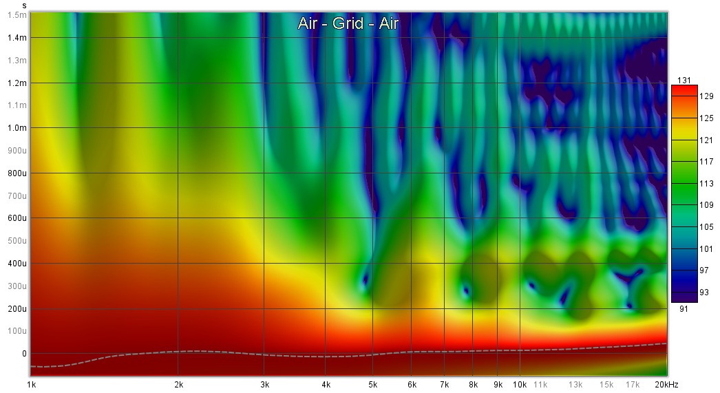

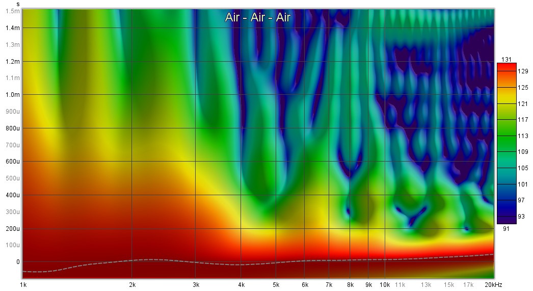

It's the front grid (sorry, no native speaker and it's pretty late hereSorry what makes the mesh vibrate at 45 thousand hz? Does this accentuate 22500hz and 11250hz, or how is this inaudible vibration damaging?
I tried alternaitve grids but always got worse results. It helps a little to move the grid more in front and away from the membrane what is very unpractical in a normal speaker. But I for sure recommend to stick with the original setup! Damaged Beryllium membranes are nothing you want to deal with and repair is not far from the price of a new tweeter.
I guess you know about the REW wavelet spectrogram feature? If not, then give it a try. You won't regret it. It's a fantastic and well appropriate tool for assessing and analyzing even micro kinds of speaker irregularities caused by reflections or diffraction artefacts.
As an example, the two pictures show the effect of the original metal grid in front of a Quad ESL63. To Grid or not to Grid only, e.g. testwise without the additional sock and the dust protection fitted of any regular ESL63. AAA is all air only, AGA is with the grid. In AGA, you see the first distinct unwanted grid effect at 400uS along with a blurred signal augmentation >600uS. I think a vavelet analysis for a metal grid protected beryllium driver would show a similar result.
Despite of intrinsic bad manners of any kind of metal grid partially obturating acoustic pathways, I would never ever place neither an ESL, nor a beryllium dome without theirs protective metal grids outside of a lab/testing/protoyping setup. And by the way and a bit off-topic here, my ESL63' are of course (re-)fitted with the complete set of dust protections, grids & socks for theirs safe and hopefully longterm daily use.

This is - by far - the lowest distortion speaker on the internet to date!You stay <0,1% from 60Hz to 5kHz at 90dBSpl - that's already LOUD in a room!
And it covers the entire frequency range, without any Helmholtz magic!
are you joking? there is plenty of loudspeakers doing those numbers at 90db/1mThis is - by far - the lowest distortion speaker on the internet to date!
No seriously lol! These numbers are typical amongst high efficiency design or no? My horn/driver combo has similar performance if I stay above 2x cutoff like I'm supposed to. I would think the same is true for anyone else using compression drivers on horns. The low end would suggest that anyone using Sd=(2 12" drivers) or more are also in the same boat. People don't share these types of measurements often enough so...
