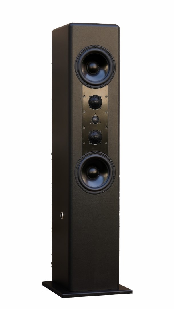

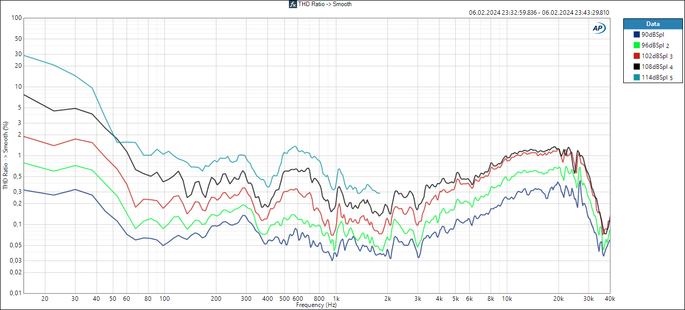

As the origin of this speaker is a measurement reference speaker that was one of the design goals. And there are not many components on the market which can meet these goals, so I'm sure it's one of the lowest distorting speaker available.This is - by far - the lowest distortion speaker on the internet to date!
And it covers the entire frequency range, without any Helmholtz magic!
Compression drivers often have high H2 values, even at lower volumes. And even well known chassis have somtimes high THD at low volumes - people don't test for that or have noisy measurement mics. Like the 18Sound 8NMB420, it has 0,5-1% THD at 90dBSpl. And never get's <0,1%.These numbers are typical amongst high efficiency design or no?
But of course it should be possible with the right components and design! You postet some measurements of your system when I remember right - can you put a link here then we can discuss there to not clog up this thread.
High sensitivity systems have a lot of potential for home use! They just need some care to behave well at low levels and take care of the resonances.

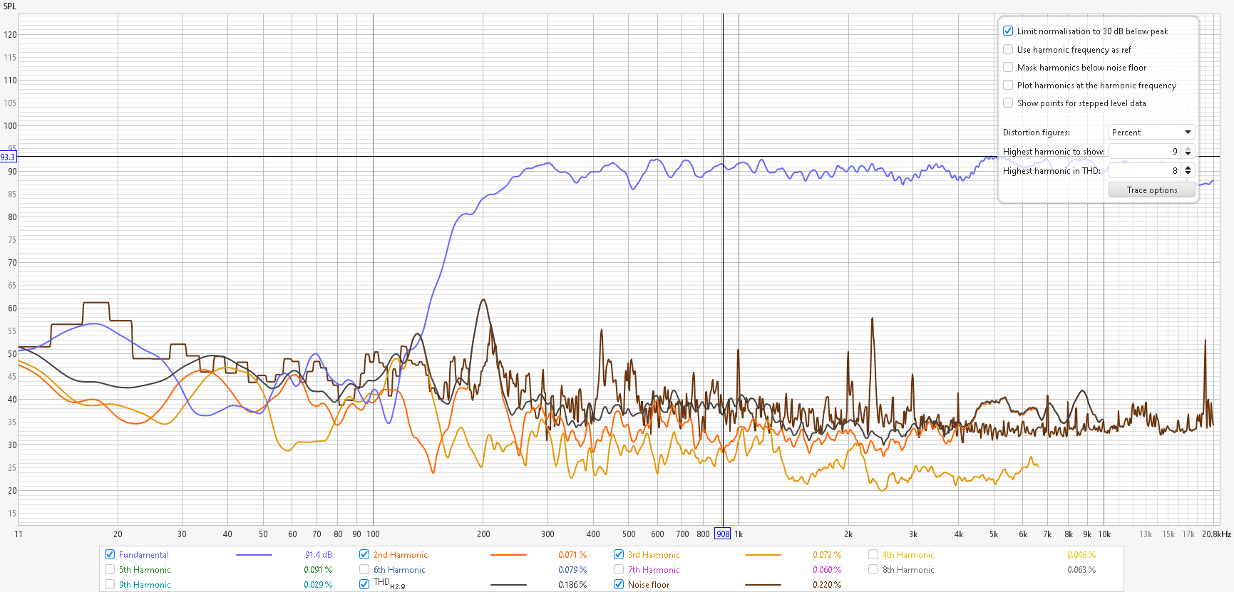

I know these features of REW - sadly Audio Precision is very inconvenient in doing similar analysis (as good as they are in all other regards, waterfall and similar analysis is not their strength).I guess you know about the REW wavelet spectrogram feature? If not, then give it a try. You won't regret it. It's a fantastic and well appropriate tool for assessing and analyzing even micro kinds of speaker irregularities caused by reflections or diffraction artefacts.

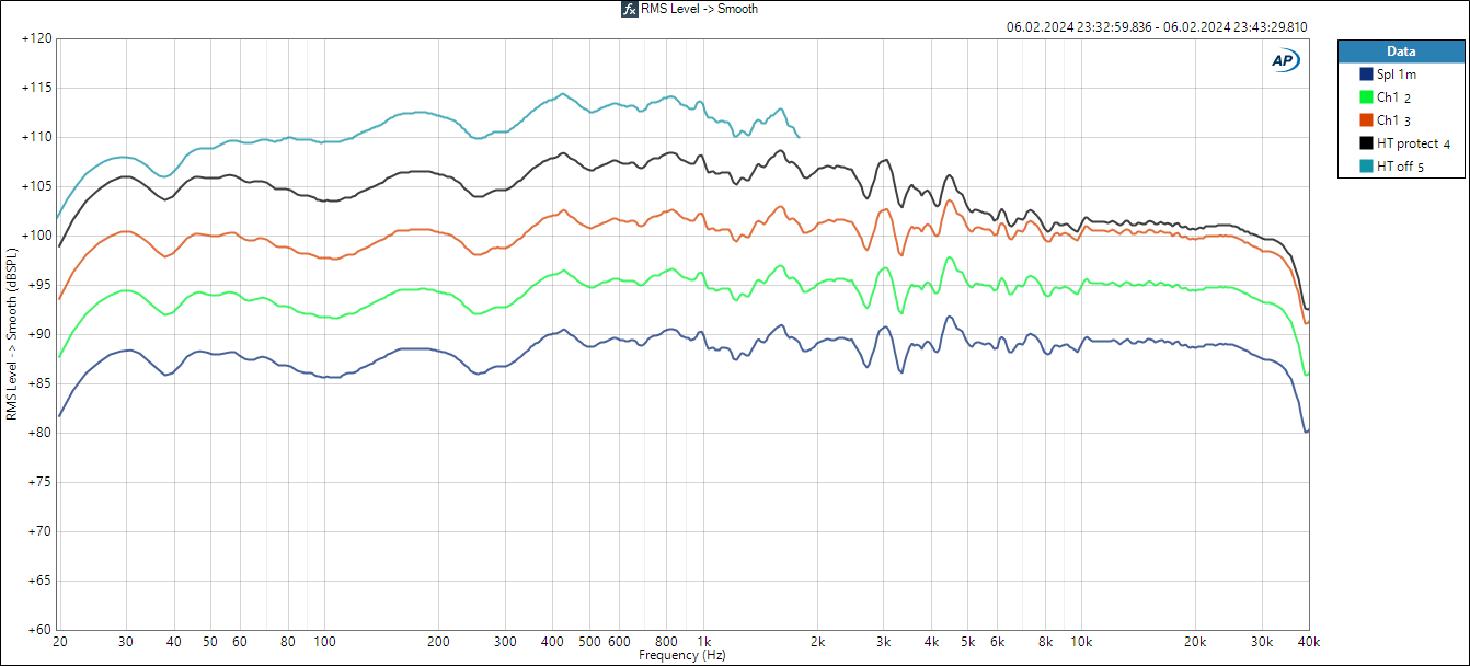

Let's consider a pair of SB34RNXL. Max SPL is 120dB. Suppose you want to measure distortion.
How do you do it? If you measure at 1m you'll get all dips due to room modes. If you take it outdoors to measure, you need to get off the ground as high as you can do get a long gate eg. 10ms. Can be challenging to hoist such a large and heavy speaker a few meters above the ground. So then there's the ground plane - but of course if needs a large open space. If you do a nearfield measurement eg. 1cm you'll likely overload your mic- 120dB @1m is 160dB at 1cm.
If you measure at 31.6cm the it's not clear to me which is responsible for the distortion - is it the mic that "sees" 130dB, or the twin 12" woofers that are reaching their limits. ]

What's with the rest of the speaker? It looks like your THD is burried in noise - so it's likely your real THD is lower.View attachment 1273510 Unfortunately I don't have a low level measurement outdoors but this is indoors, with obvious weird things in the measurement. I guess I see your point about <0.5% H2. One might debate that no one will hear the difference and point towards transient peak measurements. @IamJF what is your headroom goal? 90db/1m? which would suggest a listening level of maybe 75db/1m?

When using STEPS, I find it helpful to smooth the fundamental before calculating the percent distortion. 1/3 or 1/2 octave smooths the response out quite a bit. Many people do not like STEPS because it is slow, but I am not bothered by this.

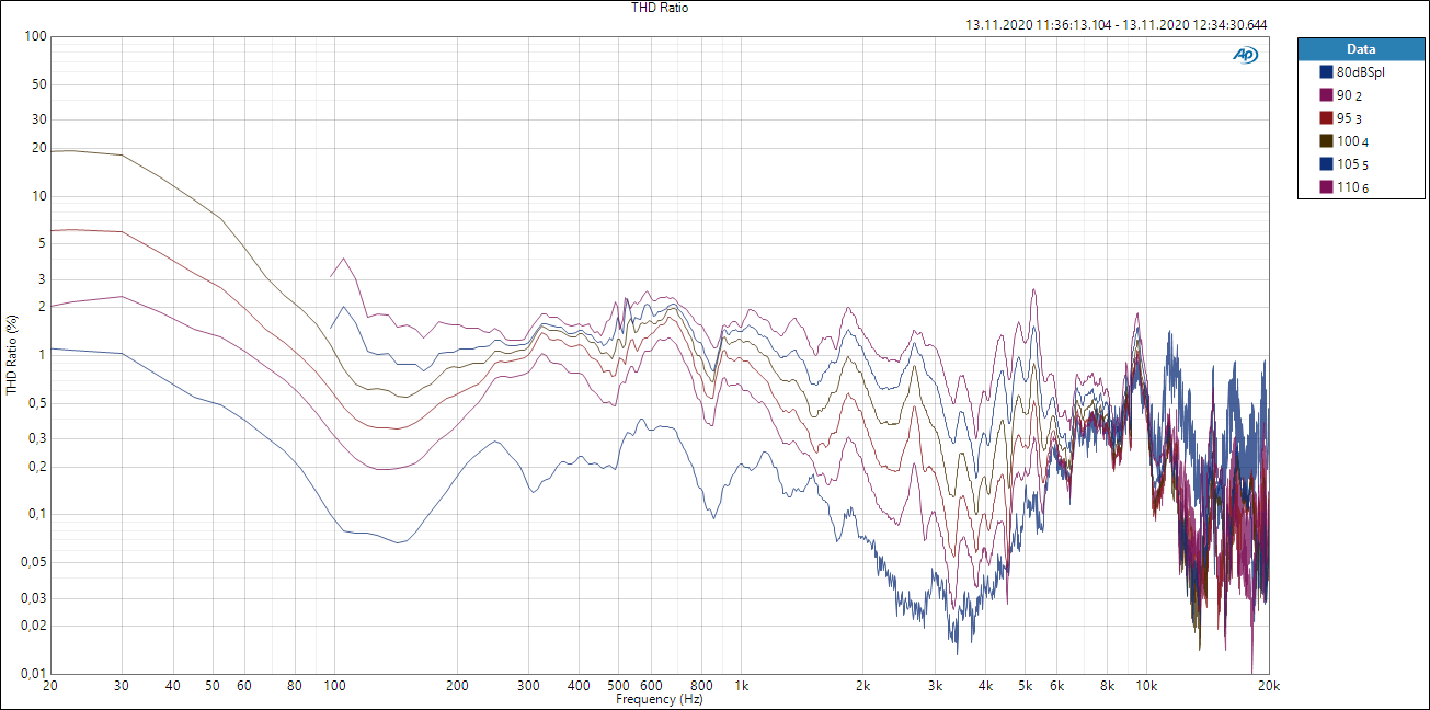

I am wondering what your THD looks like at 105db/1m in this case. I know THD is complicated topic but I am curious is all. In my 1m indoor measurement above is a large exponential horn with the Axi2050.SPL goal is ATMOS - 105dBSPL at listening position! That's pretty hard for a direct radiating speaker ...
at that point why not just measure at 1cm and do the same?I measured this speaker at 50cm distance to reduce room influence and recalculated SPL levels to 1m
When you have a look at the graphs on the first page ...I am wondering what your THD looks like at 105db/1m in this case. I know THD is complicated topic but I am curious is all.

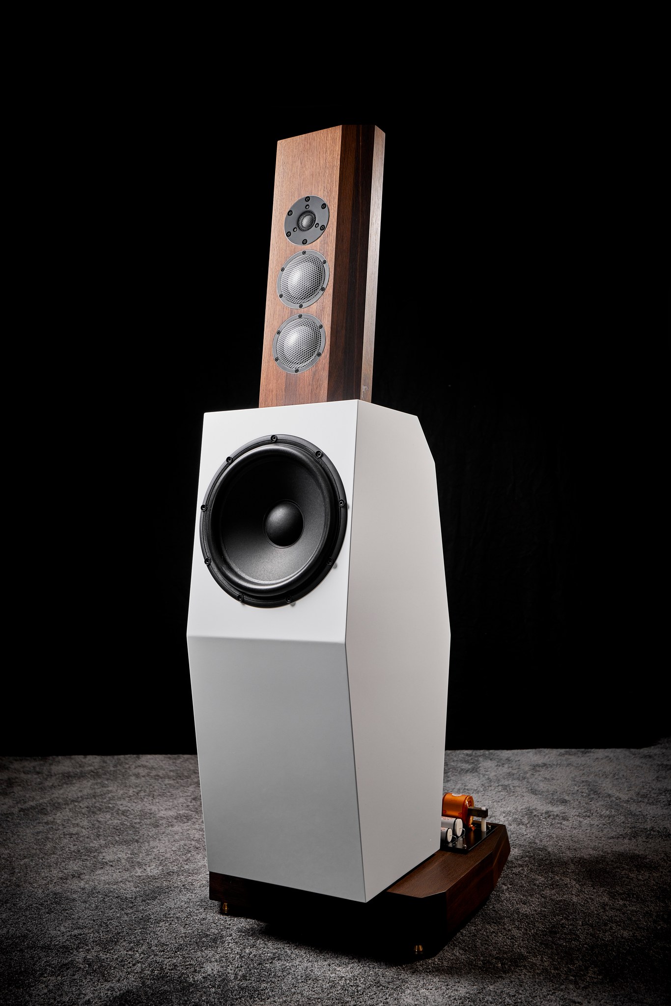

Found this speaker on FB just yesterday!In the light of discussion what is possible with 3 inch midranges...Joachim Gerhard made new speaker with two beryllium Bliesmas. Interesting that he chose ScanSpeak 6640 tweeter instead of Bliesma brothers...and only one bass unit...
There is a 2nd woofer on the backside. These ScanSpeak units are as good as the SB Acoustics I use - as long as Purify doesn't make a 12" the best units available ;-). It's actually a good idea to put it on the back but my speaker is designed to be installed at the wall - backside woofer is not a good option there. Actually I planed 4 12" for a free standing speaker ... but this get's massive.
It's probably a 3.5.5 design - the backside woofer can't go to high and the 2nd 3" also acts as a .5 way. With a wider baffle it wouldn't be needed but is still nice to keep THD even lower.
I used this ScanSpeak tweeter in a custom faceplate in my old reference speaker design - also a very good driver! It can go lower as the Bliesma, takes more power but has less sensitivity, so about the same output. For my use as measurement speaker the Bliesma is superior >30kHz. And I dislike the big front baffle, I used the smaller neodym Version before the T25B was available - but the faceplate is not removeable on the small one.
As I know these drivers - this is for sure a top notch speaker. I really dislike the hard edge close to the lower midrange and design is a matter of taste it seems ;-) Price of this speaker is interesting ... I really need to charge more
