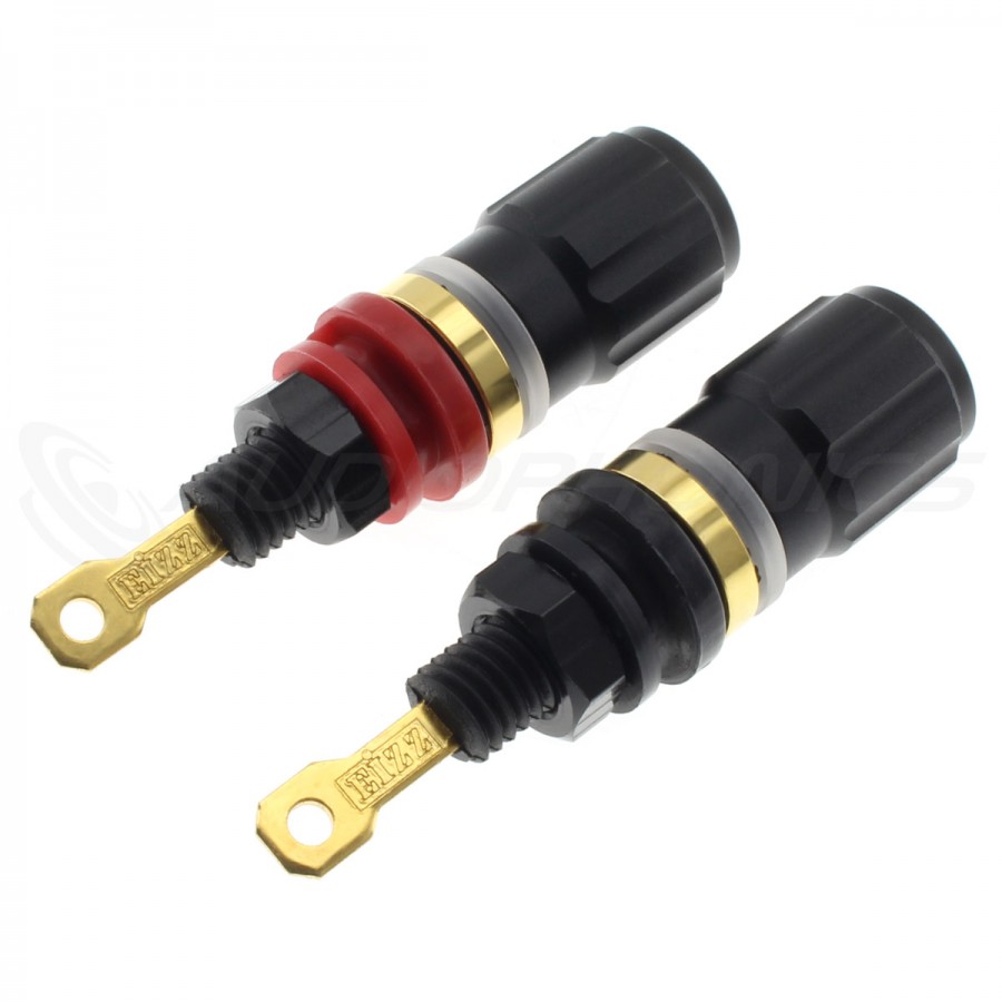

EIZZ EZ-301 Gold plated OFC Copper Binding posts Ø16mm x 61mm (Pair) - 11.90 €
https://www.audiophonics.fr/en/bind...r-binding-posts-o16mm-x-61mm-pair-p-9899.html

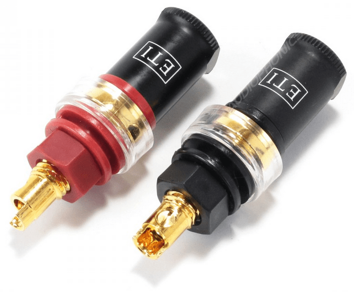

ETI BP-20C Binding Post Gold Plated Pure Copper Ø19mm (Pair) - 64.90 €
https://www.audiophonics.fr/en/bind...ld-plated-pure-copper-o19mm-pair-p-12786.html
I also think the EIZZ is great and have already bought it a second time. What you should bear in mind, however, is that the plate where the connection is to be installed is at least 2mm. In the Modushop housings, for example, the steel is only 1.5mm, so you have to do some tricks. I find that a bit annoying with the EIZZ..

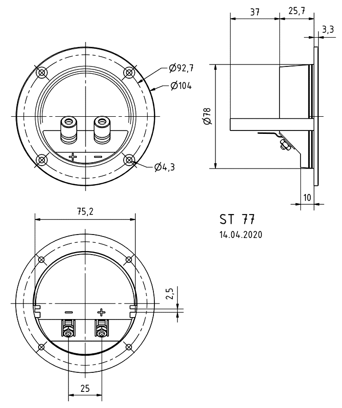

Visaton is offering ST77, a solidly built single wire terminal. It holds a x/o pcb.
Reactions: GM and friendly1uk

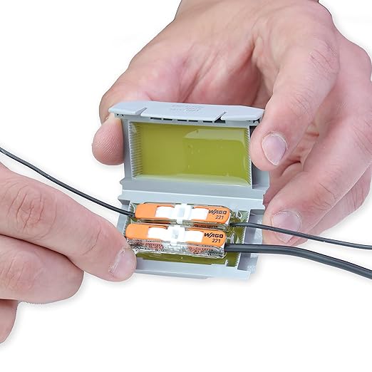

They also have Wago gelboxes if exposed to humid enviornments. for example the 207-1372 for the 221 series, gets you IP8X rating.
