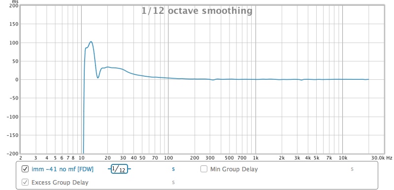

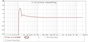

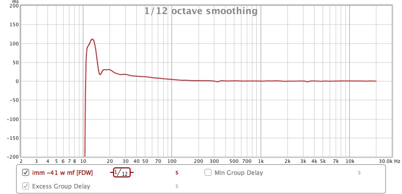

Geez, nobody but motional feedback fans care about Group Delay? I was fooling around last night with MF and ran REW with my mic hanging a few inches over a gross car woofer with a convenient dual voice coil*.
Here are GD's, one with a few dB of feedback from the second voice coil and one without. Which do you like better?
B.
*parts count for device needed to create feedback circuit (if you already own a mic mixer): zero
