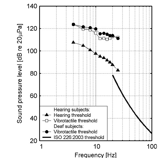

We did a lot of work on the relationship between what we hear and what we feel at LFs while I was at Ford in Noise control. Turns out that starting at about 100 Hz., the lower you go the more important the tactile feel becomes until about 20 Hz you only feel the sound, almost nothing is airborne. Without a tactile feel the perception of bass is never right.
That is an interesting observation. There's been an increase in research in low frequency perception the past few years over concerns regarding health and low frequency noise pollution from wind farms and I've chanced to read some of it. Some of it has noted that at your mentioned 100Hz, the ear shifts from being dominated by sound pressure and inner hair cells to particle velocity and the outer hair cells as frequency decreases with particle velocity becoming the dominant mode roughly an octave above your mark of 20Hz (with ten times to voltage output on the nerve to boot, though there does seem to be a blanking phenomenon that occurs when much higher frequency content comes back into play). Perhaps that has some relation to the tactile sensation you mention?
I wonder about that as, again, with the more recent studies there have been findings that, in fact, the audible signal is the more important in perceiving low frequencies. There was one study in particular I found that is especially interesting in that it compares low frequency audibility between hearing test subjects who would both hear and feel the bass and deaf test subjects who would be limited to pure tactile perception. The results? The hearing subjects heard 20Hz bass 30dB lower than the deaf testers could feel it and could still hear 3Hz roughly ten dB before it could be felt. (Measured at SPL only.) When tactile perception was looked at, the hearing subjects still "felt" the bass a few dB before the deaf subjects. I've attached a graph of the results to better visualize it.
So, low bass is definitely heard, not merely felt, but it does seem to be "felt" when heard just a little perhaps through some sort of synaesthetic bleed over between the senses. Given how many times I've "felt" a bit of low bass when listening to music on my IEMs, I'm not surprised at that at all.

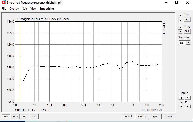

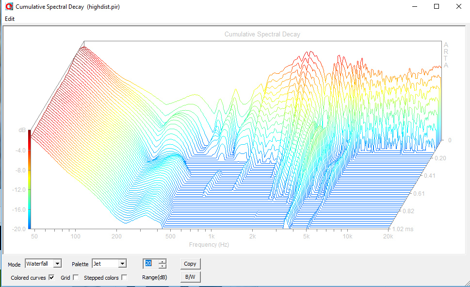

Earl, you should know this and I am sure that you do so I am puzzled. The FR and the CSD are indeed derived from the same impulse response, but they contain different information. The reason is that the FR is the impulse response with the window starting at t=0. For each subsequent slice of the CSD, this window slides over the impulse response with a fixed time interval. It thus shows the decay of the original impulse response.
For good measure I include two plots where the same impulse response is processed first into the FR, and then into the CSD.
![freq.jpg freq.jpg](https://www.diyaudio.com/community/data/attachments/588/588687-3aaf90a867e5ff6bd47bcc9ac9233e7c.jpg)
Frequency response
![csd.jpg csd.jpg](https://www.diyaudio.com/community/data/attachments/588/588686-f4395a7a5a598ef2287de64441583292.jpg)
Cumulative decay
There is no predicting the CSD plot from the FR. With the same FR, the CSD plot could stop on a dime or go on forever. Only correct processing from the impulse response will subtract the cumulative decay information from it. This information gets lost in the FR because it only looks at the impulse response with the window starting at t=0.
I would have loved to post this immediately after reading yours, but I was travelling, sorry for the delay.

Vac, what you show is rather amazing.
Firstly, the FR is 1/3 smoothed, whereas the waterfall is unsmoothened.
Such heavy smoothing makes narrow band dips and peaks disappear.
Secondly, the waterfall O dB line stops providing usefull FR info below 1000 Hz, which info is in the FR plot, running to 20 Hz.
Basically the 0 dB line in the Waterfall should be identical to the FR plot, although the graphic presentation of the FR usually looks a bit smoother, because of somewhout different scaling.
And now you want us to believe both plots are derived from one and the very same impulse without touching the windowing markers in ARTA, in other words with the markers in exactly the same spot?
Eelco
