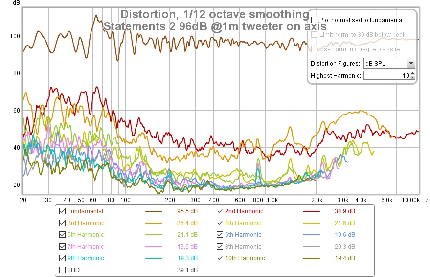

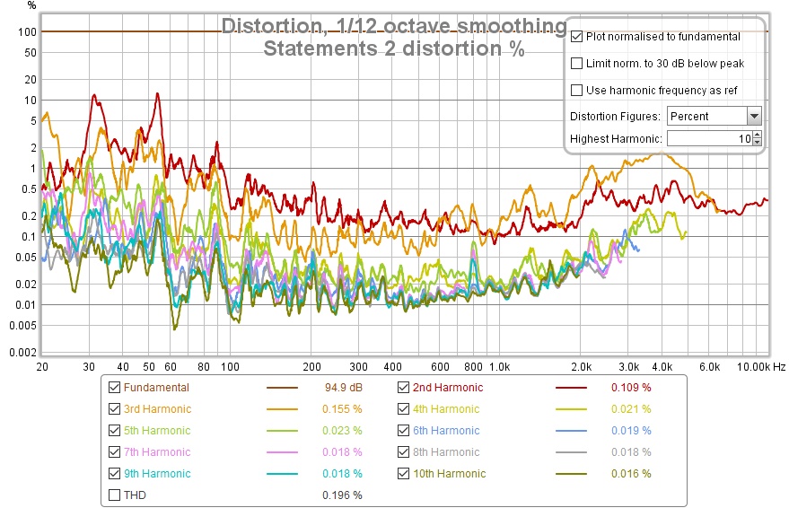

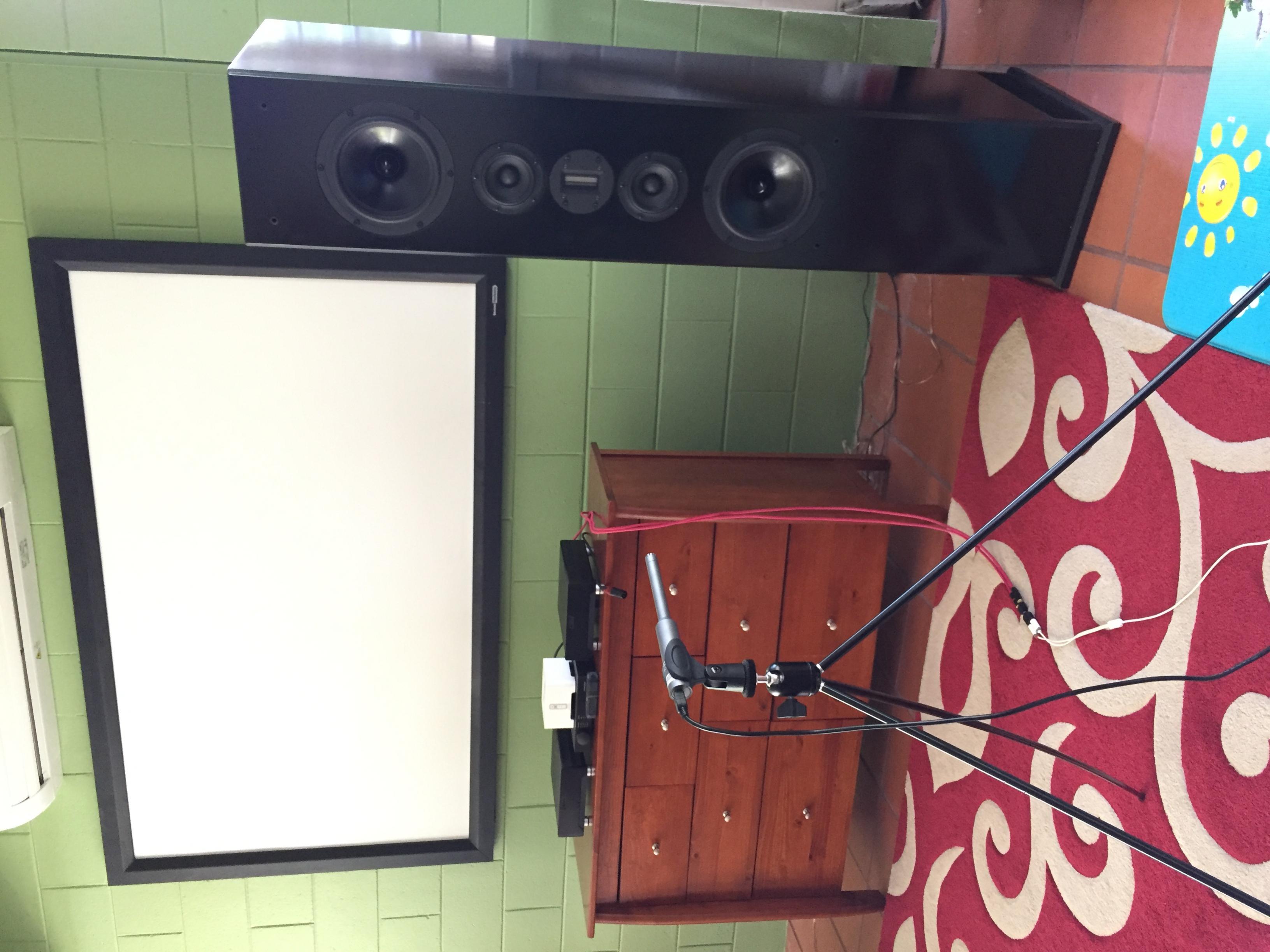

Sooooooo not to get off topic but who does make the lowest distortion loudspeaker drivers?
I think it's VERY relevant. Because how low do we want it to be?
Today I took a measurement at 1m.
And the natural background noise of my room is around 50dB during the daytime...
