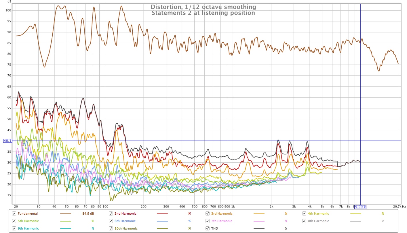

Here's a measurement of a single speaker in my room.
Room size- 8.2 x 6.4 x 2.6 metres (27' x 21' x 8.5')
Measurement distance- 3 metres (10')
SPL values are absolute, not relative.
The blue marker represents my average noise floor, which is around 35-45dB(A), depending on time of day (night-quieter; day- noisier) or environmental noises (AC, fan, outside birds or rustling of leaves)
Can I, or can't I hear the distortion?
Very low distortion. Well behaved 2nd and 3rd harmonics (3rd stays under 2nd) that helps SQ.
Although sort of near-field, very flat FR north of 300 Hz to as far as HiFi for humans needs to go. But bass still oddly variable at 1/12 smoothing.
What're the components, esp the speakers and crossover parameters?

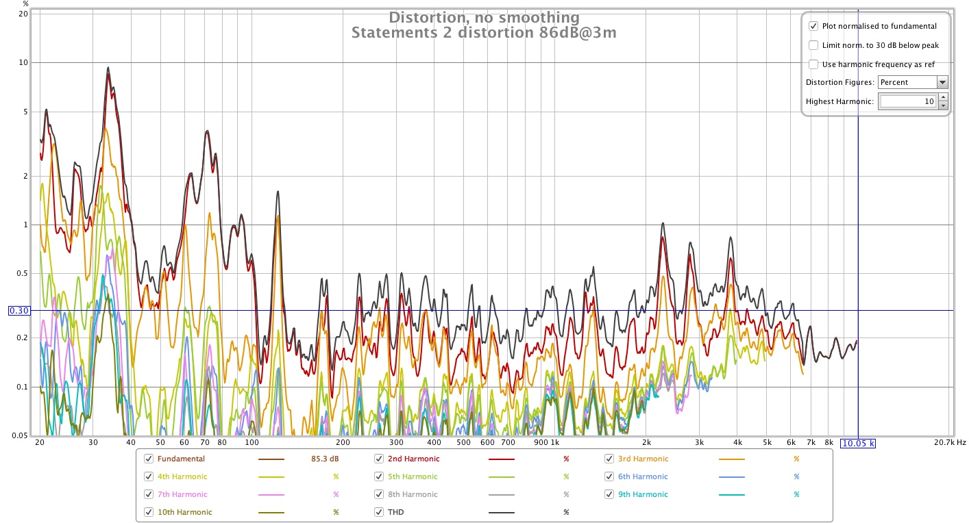

(REW now can plot HD re fundamental. Can't make up my mind if that's more meaningful to my eye than traditional plot.)
Yes, I don't think there are many speakers in the world without some form of audible distortion. The cone has mass and can never perfectly reproduce the signal. Speaker distortion is much more complicated than electronics.
As far as non linear distortion goes I don't know, because a lot depends on the type. I've heard around .5% is very good, esp if its mostly 2nd harmonic.
They say with amps around .1% is a good target, but keep in mind that the transistor distortion in amps is relatively more audible than other types.

Thanks for posting the normalized HD.
Actually, it nicely illustrates what's a problem with that display. Your FR has a giant dip at roughly 32 Hz, likely mostly due to an artifact of measurement rather than a speaker dip*. But the normalized HD has an enormous peak due to that illusory dip. All a good reason to use cosmetics in the form of some smoothing since the fine-grain of HD isn't meaningful.
Again, really nice results. Again, what is the gear?
B.
*even if it is true speaker dip the absolute level of distortion products are low and the critique to follow still applies

It appears to me that the distortion is dominated by 2nd order which is heavily masked, so I would say that in all likelihood this amount of nonlinear distortion would not be significant. But again, its hard to tell since we have no perceptually valid metric for nonlinear distortion.
As an aside looking at the graph I wonder when did it become acceptable to mix terminology?
Technically there is no 'fundamental' in a harmonic series but there is in the overtone series ie what is called fundamental and 2nd harmonic in the graph should be called either 1st and 2nd harmonic or fundamental and 1st overtone.
Technically there is no 'fundamental' in a harmonic series...
Yes, been wondering about that myself for a while. But like many evolutions in living language, it might work fine within the REW world.
I've taken it to mean the recorded sound less the crap. In practice in the loose world of eyeballing charts with less than monumental distortion, that would be the same as simply thinking of the recording as the "fundamental" and so the exact definition, to me, becomes moot.
