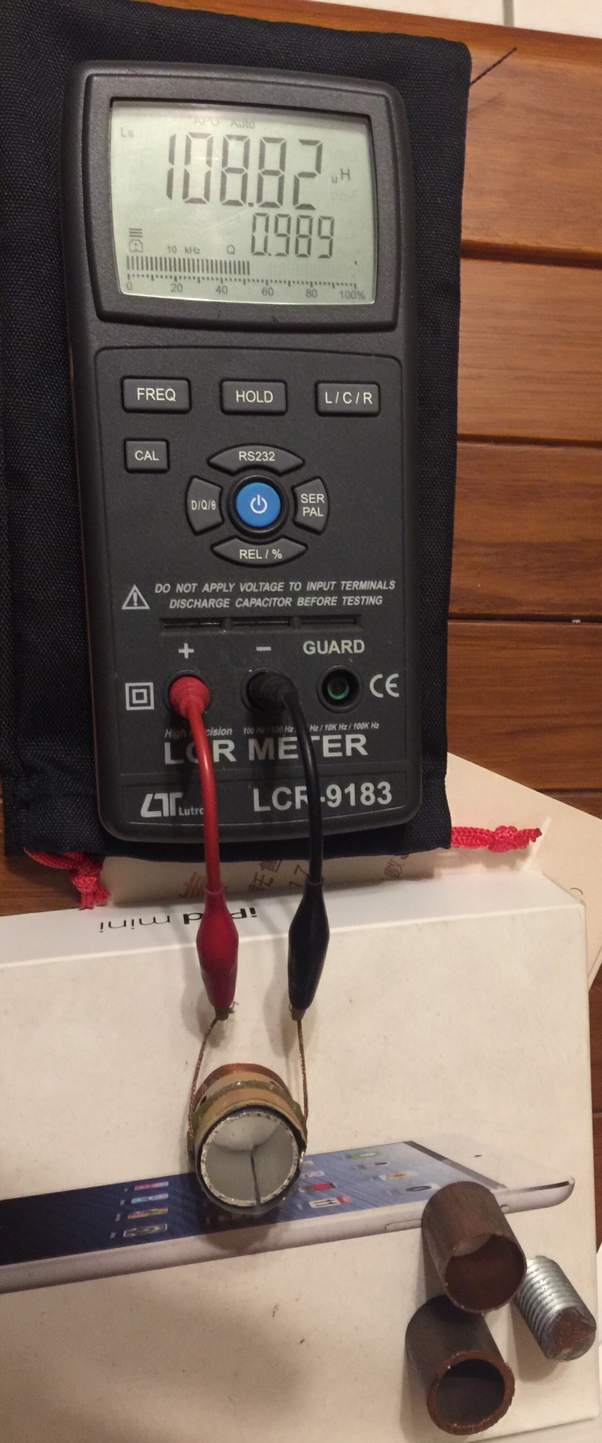

I saw photos with an inductance meter, but variation of inductance with materials appeared primarily a function of cylinder diameter. If I am missing other photos could somebody provide a post# or link?
I was thinking at first that it was just a cg=hange in materials, but it now seems like the entire shape changed and that makes the whole test invalid. Except the inductance going down with a steel core - that's completely wrong.

Here is the right simulations
(and sorry for the sauron eye look simulation... i've found it fun on the moment)
With the coil
![](https://nsa39.casimages.com/img/2017/11/21/171121065554844977.png)
Without the coil
![](https://nsa39.casimages.com/img/2017/11/21/171121065555214069.png)
But IMHO if the gap gets larger, the coil and the gap height get longer, or the Q get higher.
