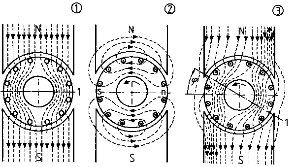

Regarding armature reaction in motors, most has been written about rotating motors, not linear motors such as in loudspeakers. However, maybe a few links worth looking at to help develop some intuition on the subject:

Also, an illustration of the effect below:

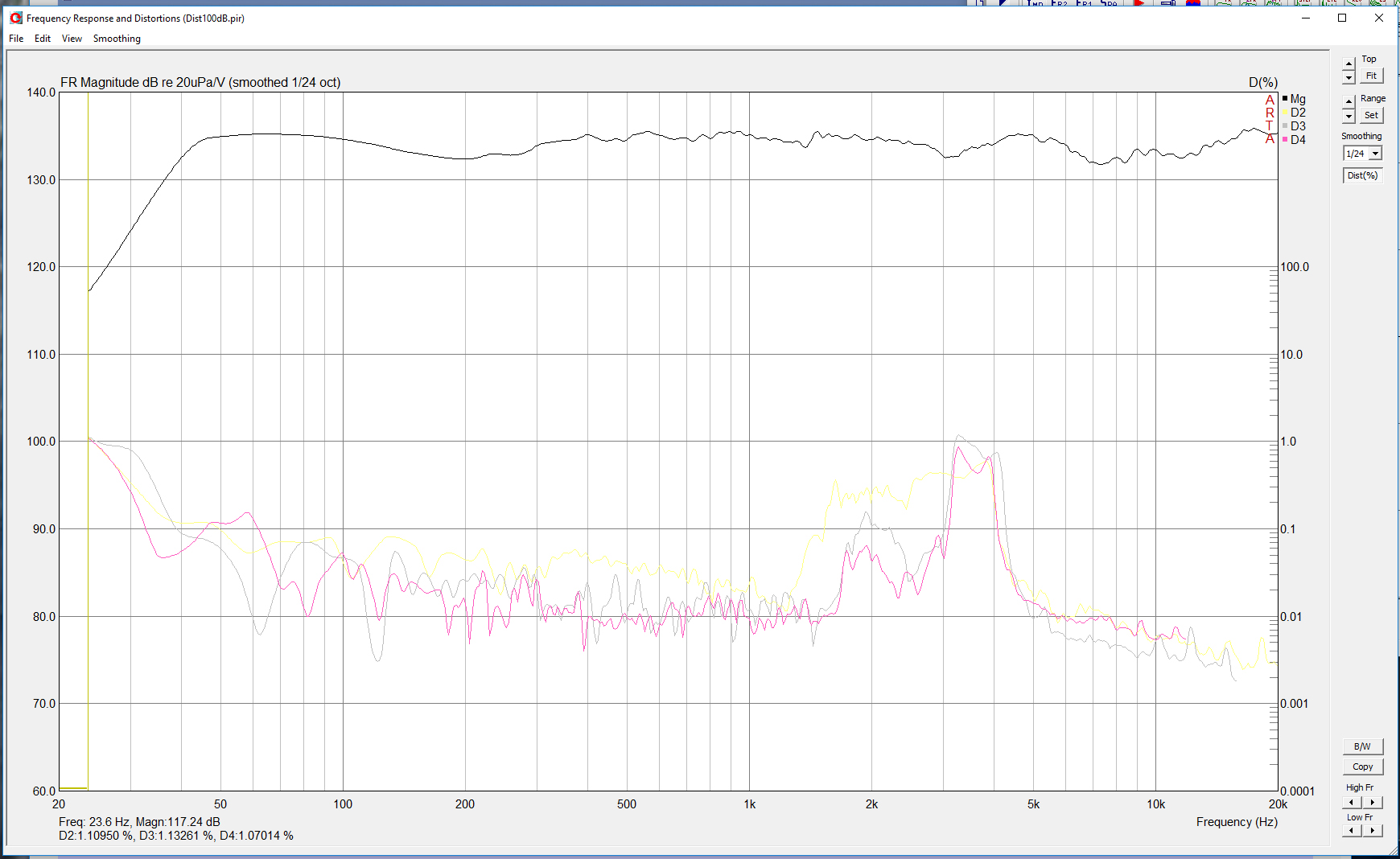

Hi Barry,
What I would like to see about the M2 drivers are the distortion figures at let's say 100dB/m,... Vac
Here ya go!
Please look carefully at the notes as the distortion levels are raised 20dB to retain some resolution on the graph.
I am interested in what conversation this will bring as I don't recall anyone else posting any real driver distortion measurements on this thread yet.
In my own comparative listening tests this driver flat smokes the good old revered by many JBL 2235 in every way. When you turn it up, it just gets louder, the sound quality doesn't change.
Barry.

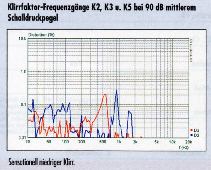

Interesting.
So, the 2nd harmonic peaks at 55dB @ 60Hz, which - relative to an SPL of 95dB at the same frequency - means -40dB = 1%
The 3rd harmonic peaks at 55dB also @ 500 and 600Hz, which - relative to an SPL of 100dB at the same frequencies - means -45dB = 0.56%
My own 15" woofer of choice, the Fostex FW405N, was measured by the reputable independent German magazine "Hobby Hi-Fi" - see attachment.
The 2nd and 3rd harmonics were measured to peak respectively at 0.3% and 0.2% (in both cases above 500Hz), while both components remain below 0.1% at all frequencies below 500Hz. (The figure caption reads: "Sensationally low distortion")
These measurements were carried out at a lower SPL of 90dB, so they are not directly comparable. But I think they still tend to indicate a better objective performance overall, especially w.r.t. the 2nd harmonic, which is lower by one full order of magnitude (0.1% vs 1%) in the low bass frequencies.
Be that as it may, it remains doubtful if any of this is really meaningful from the point of view of our listening perception. Published evidence seems to indicate that once a woofer's distortion is below a few %, then it no longer makes any audible difference...
Marco

You're right - they are not comparable at all. It is plain wrong to deduce that Fostex FW405N is better performer than JBL looking at these measurements.
In HobbyHiFi they haven't wrote at what frequency that 90dB is - if it is at say 1KHz, JBL is 102dB there and fact is that distortion doesn't have linear rise so 2nd and 3rd harmonic would be much lower than -45dB and -55dB if measured at 90dB. I wouldn't be surprised if JBL turns out a much better performer in distortion test done in same conditions.

Hi Barry,
Those figure look pretty good and thanks for the challenge to show distortion measurements. I posted this earlier in a different thread (?), but here are some anechoic measurements @ 100 dB of a 5.2 kg speaker I designed with over-the-counter drivers:
![distlow.jpg distlow.jpg](https://www.diyaudio.com/community/data/attachments/603/603594-dfc5de73cf81c5c3aac896dbf2d6071d.jpg)
As to the point of the importance of harmonic distortion in speakers, I must have met different folks from Harman than Dr. Geddes.
The holy triad to develop better speakers is improving linear distortion, sound power distribution and harmonic distortion. In that order. HD is the least importance of the three, but still does figure on the list.
