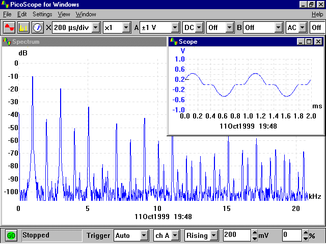

What are you referring to? It would depend on what aspect, for example it could have a linear frequency response (not likely) But it wouldn't be a linear speaker, there's no such thing, that's why I ask.back to distortion... how can a driver/loudspeaker having high harmonic distortion still be considered linear?
i don't care if it's an amp or a speaker.
the greater the linearity the less the harmonic distortion is, unless there some form of exceptional case that someone can show me that's how it works that's why it's expressed as a percentage.
What about crossover distortion?unless there some form of exceptional case
as in amplifiers or loudspeakers? while where at it let's not exclude active filters they are no exception or are they...as i understand it the steeper the filter the greater the distortion.

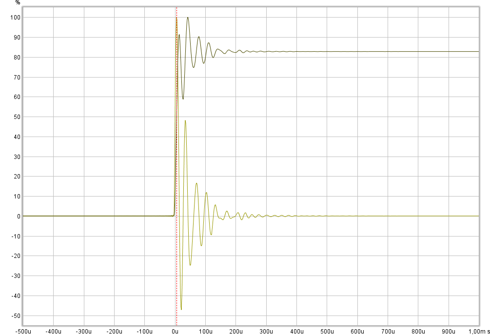

The main disadvantage of a high order filter though is the ringing that it introduces at the crossover frequency. The higher the order the more it rings, and of the classic minimum phase filter topologies only the 1st order doesn't ring.
So if the drivers were perfect the ringing of the crossover would be undesirable. However you have to weigh up any potential ringing of the crossover against resonances of the drivers themselves.
A lower order crossover may ring less at the crossover frequency, but if it lets a lot more high frequency cone breakup resonances (which are arguably more objectionable) through, and perhaps buzzy distorted tweeter fundamental resonances, the end result can actually be a lot worse than just using the higher order filter.
Then add in increased distortion, worse polar response, and most likely, a less flat frequency response, and that slightly reduced ringing at the crossover frequency has come at a big cost.
In my opinion the ringing of a crossover should be treated on equal footing with any driver resonances to keep it in context - look at the CSD of the total summed response and see how the crossover resonance compares in severity to the cone breakup resonances... if you can greatly reduce audible cone breakup resonances at the expense of slightly more ringing at the crossover frequency (but still considerably less than the driver resonances that remain) then I'd say that's a good tradeoff. You also have the possibility of using linear phase filters to improve matters while still achieving higher order slopes.

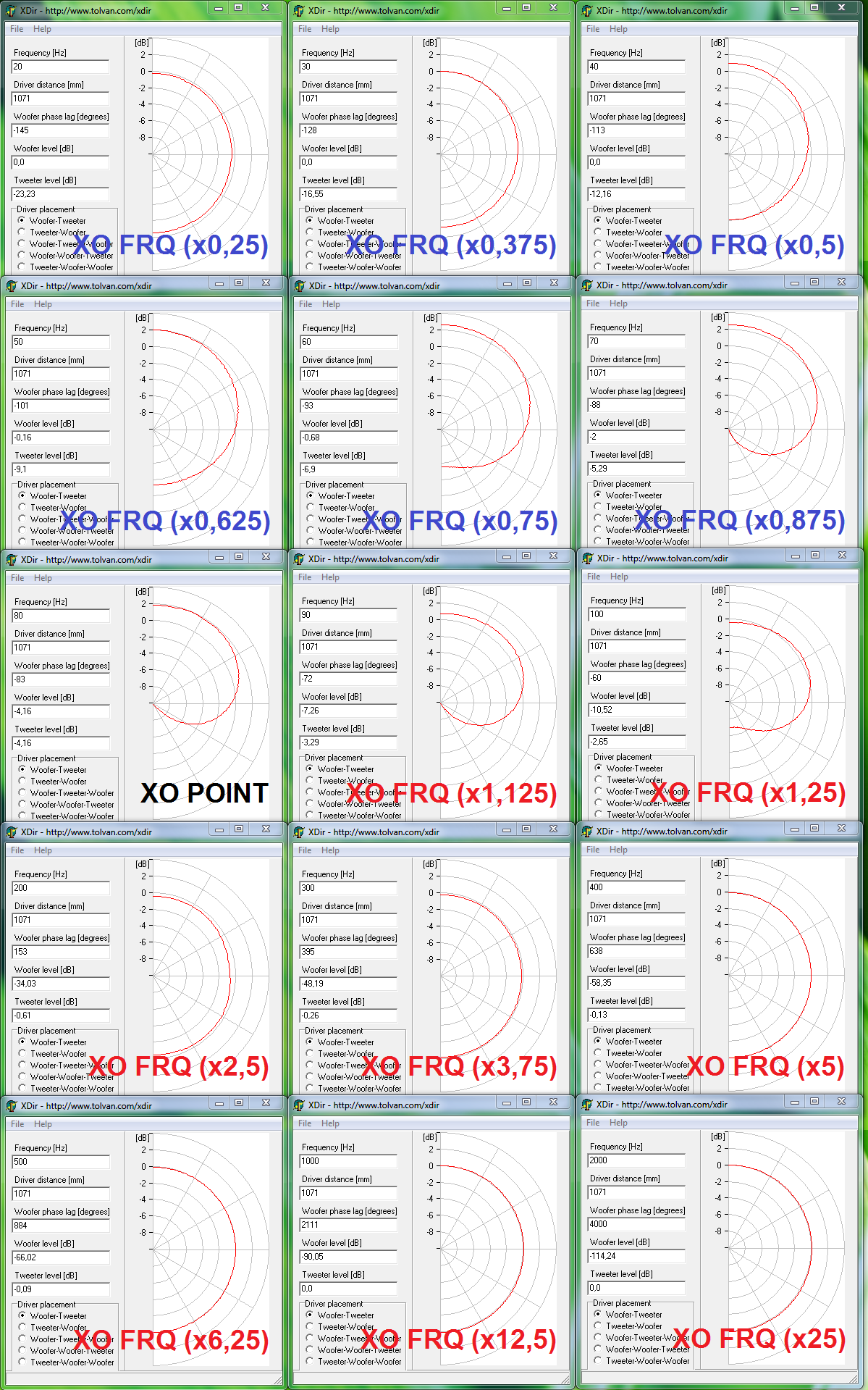

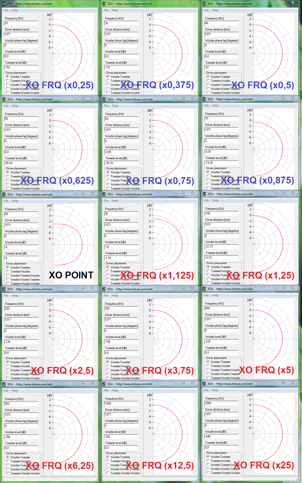

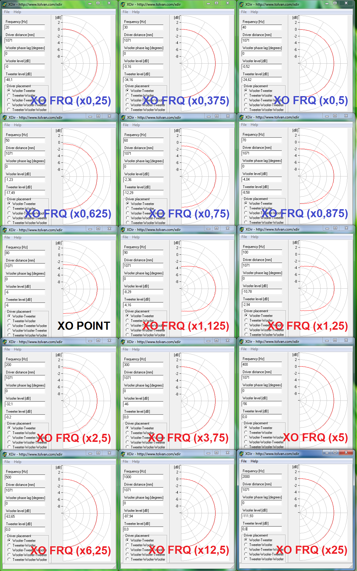

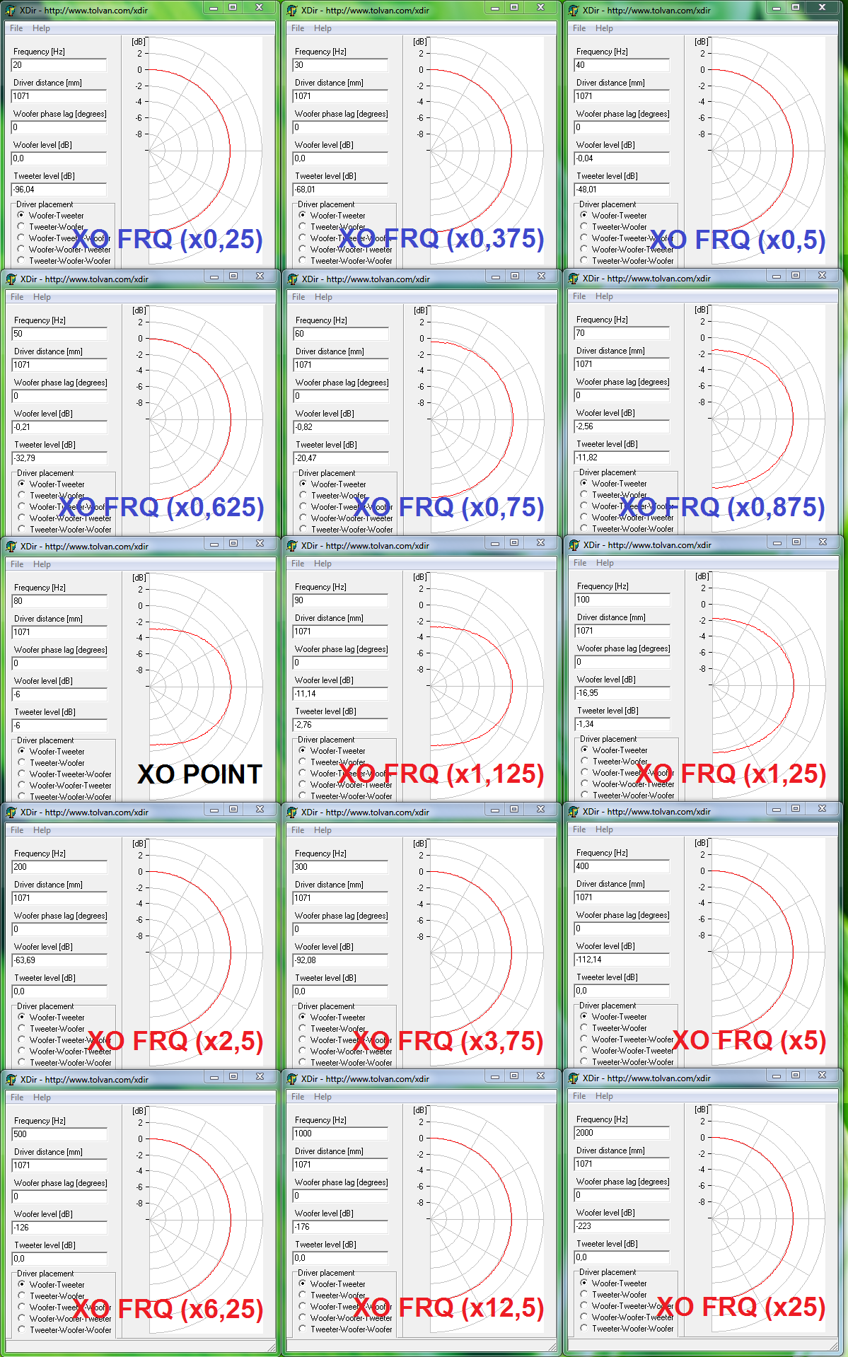

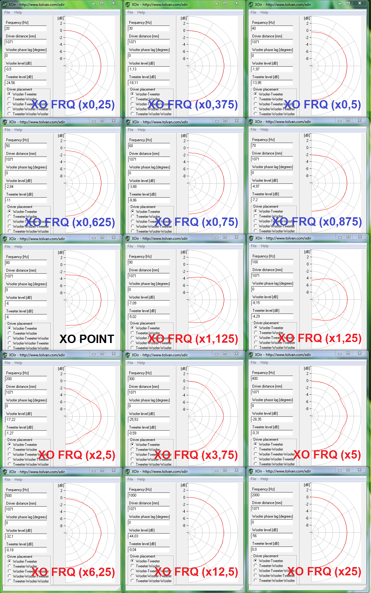

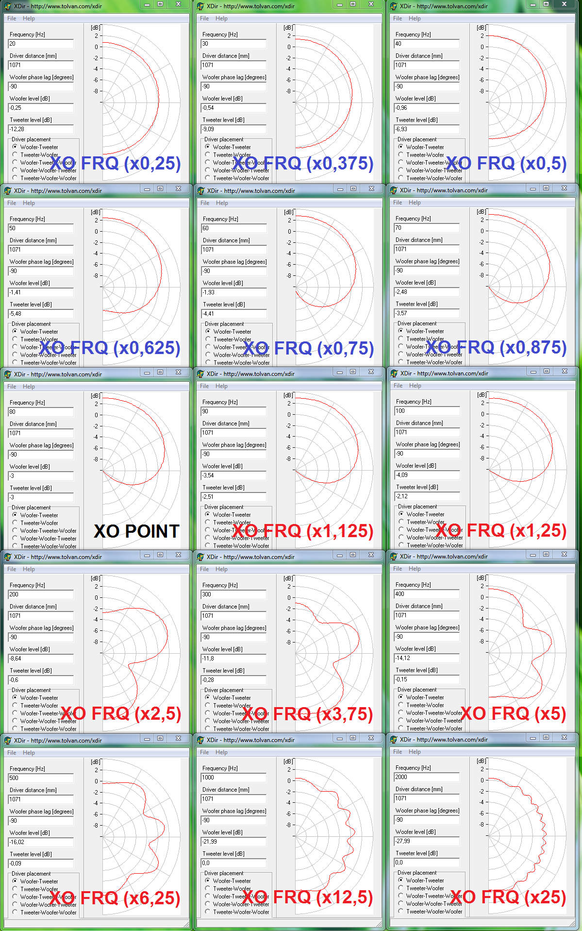

Thanks a good write up there, below visuals for vertical summing using free XDir will support the written words, spacing in all examples is a same relative low 1/4 wave length so if real spacing is larger it gets worse and if using coxial it will improve to a perfect polar in XO region.
First is BW1, second Harsch, third LR2, forth LR4, fifth LR8, and sith LR16

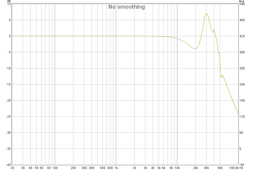

Yes DAC have high order filters and some of them can have filters that on paper looks like a mess, guess that's one reason we want own reproduce DAC and system to dynamical support all the various track material sample rates they are mixed for.
But also good old analog looks can distort into those areas, below is a previous generation B&W tweeter response measured at stereophile site that is translated here to a impulse response to se how that looks isolated on its own.
Think if measurement chain support it and a DSP is used running up at 96kHz or higher it should be possible system wise to correct for some of those high order ringing.

This is new to me, please tell more about ringing! How does it sound? How does it show up in measurements? My guess is that this is some interference. How can we test it, playing sine at Fxo?

Thanks for posting that, it's great to see it fully visualised. 🙂Thanks a good write up there, below visuals for vertical summing using free XDir will support the written words, spacing in all examples is a same relative low 1/4 wave length so if real spacing is larger it gets worse and if using coxial it will improve to a perfect polar in XO region.
1/4 wavelength spacing between a midrange and tweeter is pretty low and hard to achieve unless you use small drivers and a rather low crossover frequency that I would not be happy using.
I would suggest 1/2 to 1 wavelength would be more typical of real designs for midrange to tweeter spacing.
Even at 1/4 wavelength, the destructive interference in the vertical polar response from the 1st order filter is pretty bad at high frequencies, and non existent on the higher orders.
My speakers have unusually wide centre to centre driver spacing of 1.75 wavelengths at 3Khz so would be even more sensitive to filter order off the vertical axis.
I'll have to download that app and try some simulations at 1.75 wavelengths. I'm sure it won't look pretty, even with 4th order! 😀
(Edit: how are you entering the filter type into the app ? Or are you calculating the phase and amplitude of a given filter response elsewhere and manually entering it ?)
The centre to centre driver spacing is 20cm purely due to the large size of the drivers. (8" full range with a somewhat bulky frame and a ribbon tweeter with a largish face plate) I could have reduced that by maybe 3cm at most, except there is a front to back panel strut between the midbass and tweeter that I don't want to remove that was there since before the speaker even had a tweeter in the cabinet. (And another one just below the midbass driver)
I don't think reducing it by 3cm would make a significant improvement to the relatively large spacing, but the removal of a strut and weakening of the panel by cutting the holes much closer together would have a detrimental effect on the cabinet's structural performance. (There's those pesky compromises and trade-offs to be weighed up again. 😀 )
I've tried different orders filters with these full range drivers with various tweeters over the years, including 2nd, 3rd and 4th. I used it with a 3rd order filter for years with reasonable results but I think the 4th order sounds better and absolutely measures better.
It could well be that part of the reason I'm favouring the 4th order crossover with these speakers is that it helps to minimise the effects of a relatively wide driver spacing and make it a lot more workable. Despite the large driver spacing the subjective vertical off axis response is surprisingly good - I notice the top end off axis roll-off of the ribbon tweeter more than I notice any holes in the presence region near the crossover frequency.
