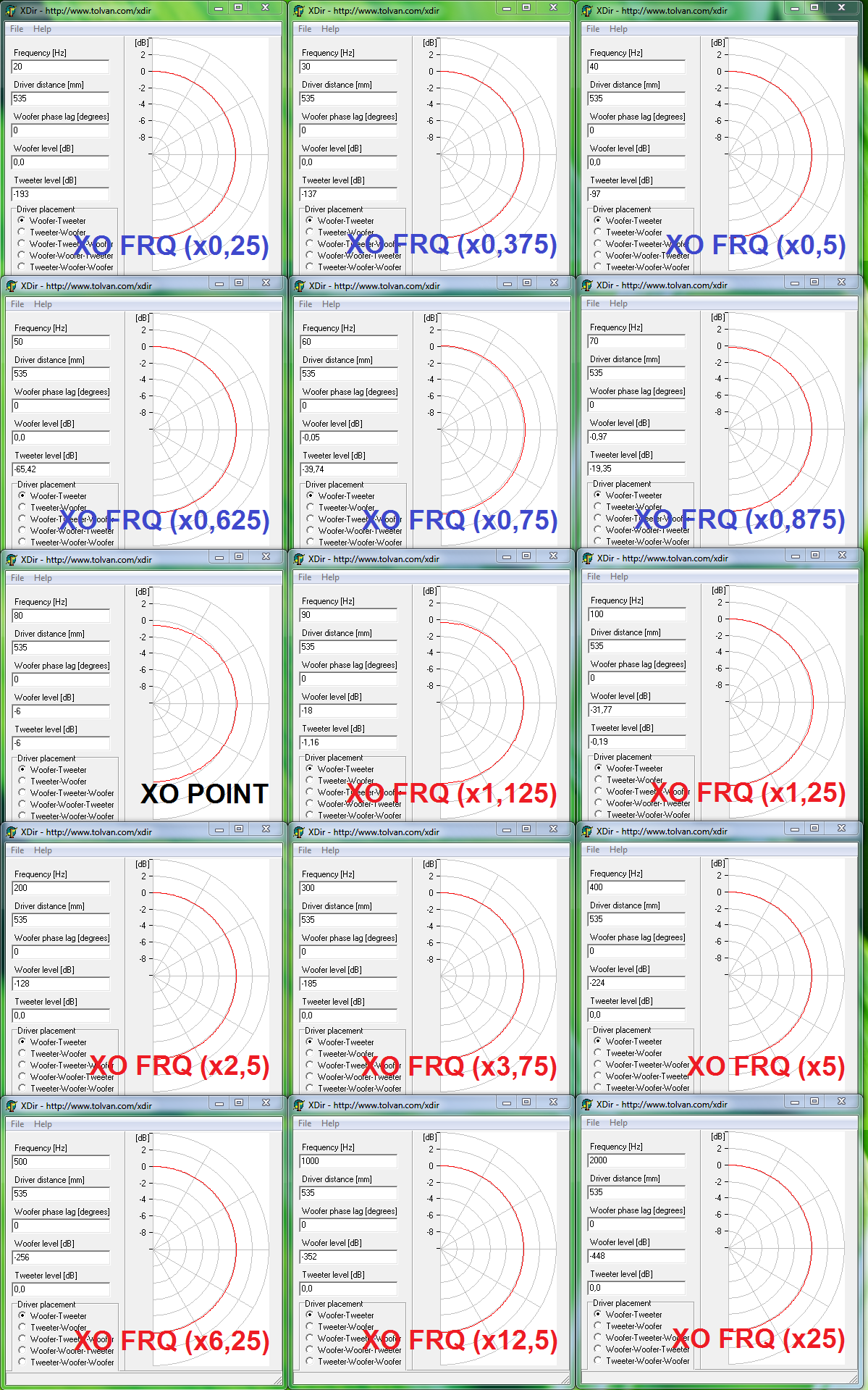

...I'll have to download that app and try some simulations at 1.75 wavelengths. I'm sure it won't look pretty, even with 4th order!
(Edit: how are you entering the filter type into the app ? Or are you calculating the phase and amplitude of a given filter response elsewhere and manually entering it ?)...
Admit it was a lot of work but its free tool so can accept that and its interesting stuff to get a feel about vertical acoustics. For task luckily i have a dual flat screen desktop with two 24 inch panels where one is in landscape mode and the other is tilted to portrait mode, then have XDir open up fifteen times on portrait mode screen and free Rephase maximized on landscape screen where slopes are set and one can read out the various points of amplitude and phase and type them numbers into those fifteen XDir windows. If you haven't any dual screen computer suggest run Rephase maximized on one computer to read out slope numbers and some multiple XDir on another computer and end assemble all the XDir windows into a photo editor. That said a thought is it looks new XSim from bwaslo in 3D have some new polar features that maybe is better or easier than above method, but at present can't say because haven't tried out that 3d version yet.
It was from same XDir exercise discovered that a LR16 (96dB/oct) slope combined 1/8 wavelength would give close to real coxial performance polars as seen below

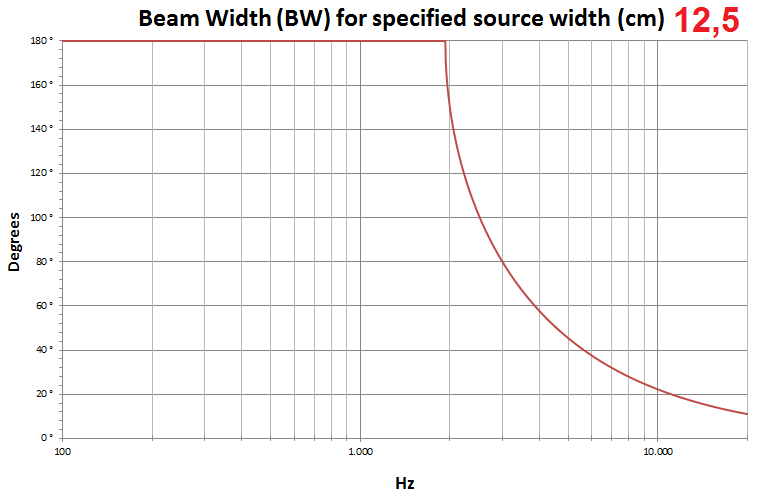

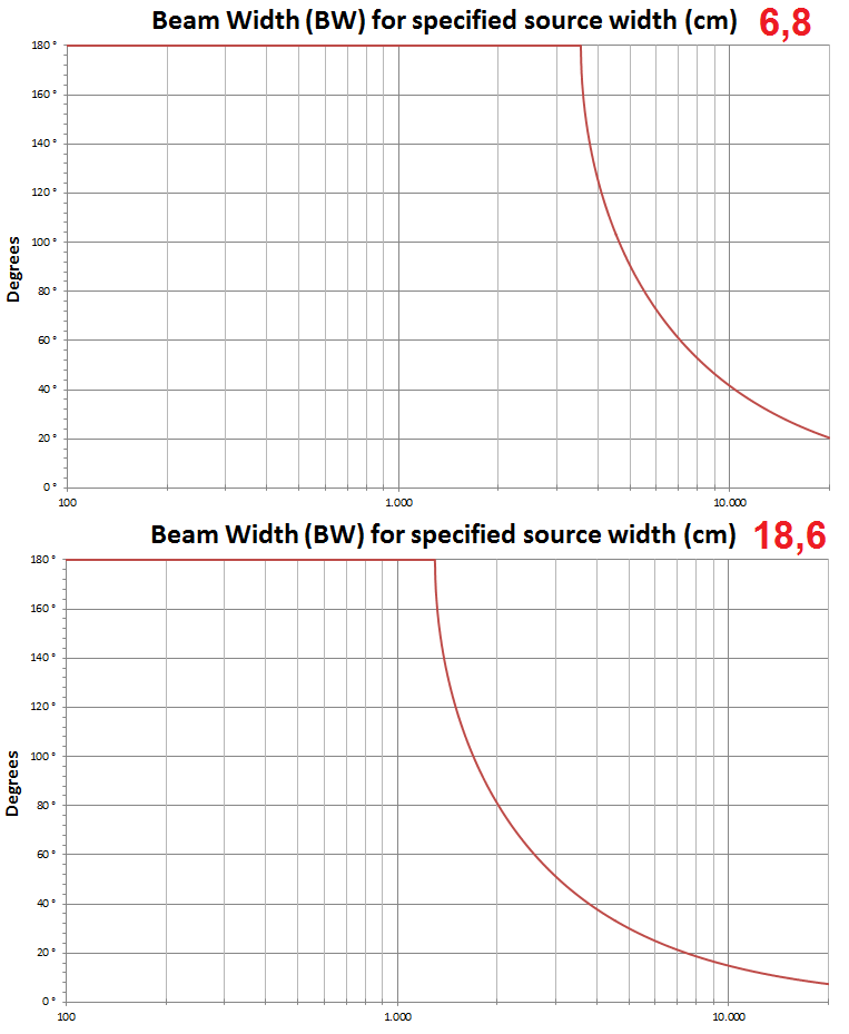

Good question. Actually, you can't hear ringing (FR plot) any more than you can hear beaming (polar plot). Both exist as visual aberrations on plots.
B.
I beg to differ! Since 80-90% of the sound reaching our ears is from off-axis angles, it seems absurd to believe that polar response would not be audible. Ringing could be masked, but polar response is not simply a "visual aberration"!!!
I think you are having trouble separating the bird's eye view (engineer) from the worm's eye view (with apologies, the listener).
Easier for me to try to explain about polar response and beaming than about ringing. A person can say, "Golly, when I sit in middle of room, the sound is wonderfully bright but duller when I sit at the sides." And they can sometimes correctly THINK that's due to beaming.
But no person can say, "Golly, I hear beaming" except as a kind of unhelpful shorthand for what I said in the previous paragraph. Well, they can say it, but it doesn't mean any more than saying, "Golly, I hear aluminum in the cone."

A lot of people are having trouble understanding the simple point I am making: you don't hear beaming, you hear sound.High frequency beaming of a driver is easy to hear - from one specific listening location you may not notice it ...
When you sit in your chair, the speaker is playing at you, not beaming at you. If you like the sound it also possibly measures flat, assuming your house curve is flat. If you change chairs, the treble might change due to a poor polar plot (AKA beaming).
Beaming per se isn't a problem. In devising a system, you make a call about how much beaming works well for you and in terms of the size of your listening audience, room acoustics, furnishings (and how they are distributed around your room and esp. on walls), how loud your speakers can play, ability to EQ, etc. and in terms of the trade-offs otherwise (such as complexity, cost, fuss, WAF...).
At one extreme, you can choose to accept a lot of beaming if it results in good sound at your chair, even if nowhere else in the room. That's not uncommon for people using large panel speakers or horns.
In practice, when fine-tuning your system, you set up your mic and run REW. What is, is what is.

If the driver is truly beaming at high frequencies (we're talking about less than about 20 degrees coverage here) then the on axis response to get a subjectively balanced response is neither flat, nor a sloping down "house curve", but requires the treble to be tilted up quite significantly - on the order of around 6dB or more. This can become fatiguing over time.When you sit in your chair, the speaker is playing at you, not beaming at you. If you like the sound it also possibly measures flat, assuming your house curve is flat.
I think you may have a different definition of beaming than other people. We're not talking about somewhat reduced dispersion of say 90 or 60 degrees, we're talking about tightly focused dispersion <20 degrees or so.Beaming per se isn't a problem. In devising a system, you make a call about how much beaming works well for you and in terms of the size of your listening audience, room acoustics, furnishings (and how they are distributed around your room and esp. on walls), how loud your speakers can play, ability to EQ, etc. and in terms of the trade-offs otherwise (such as complexity, cost, fuss, WAF...).

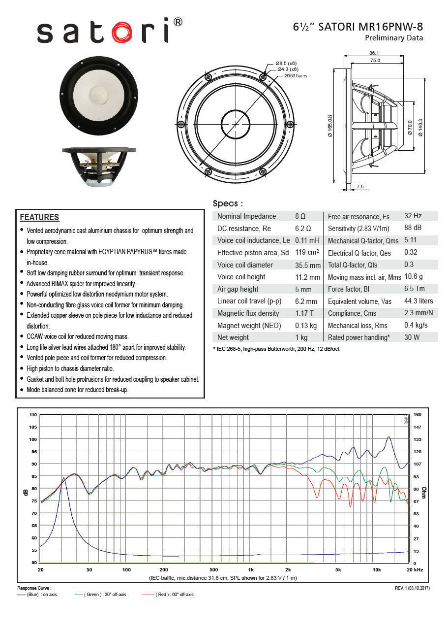

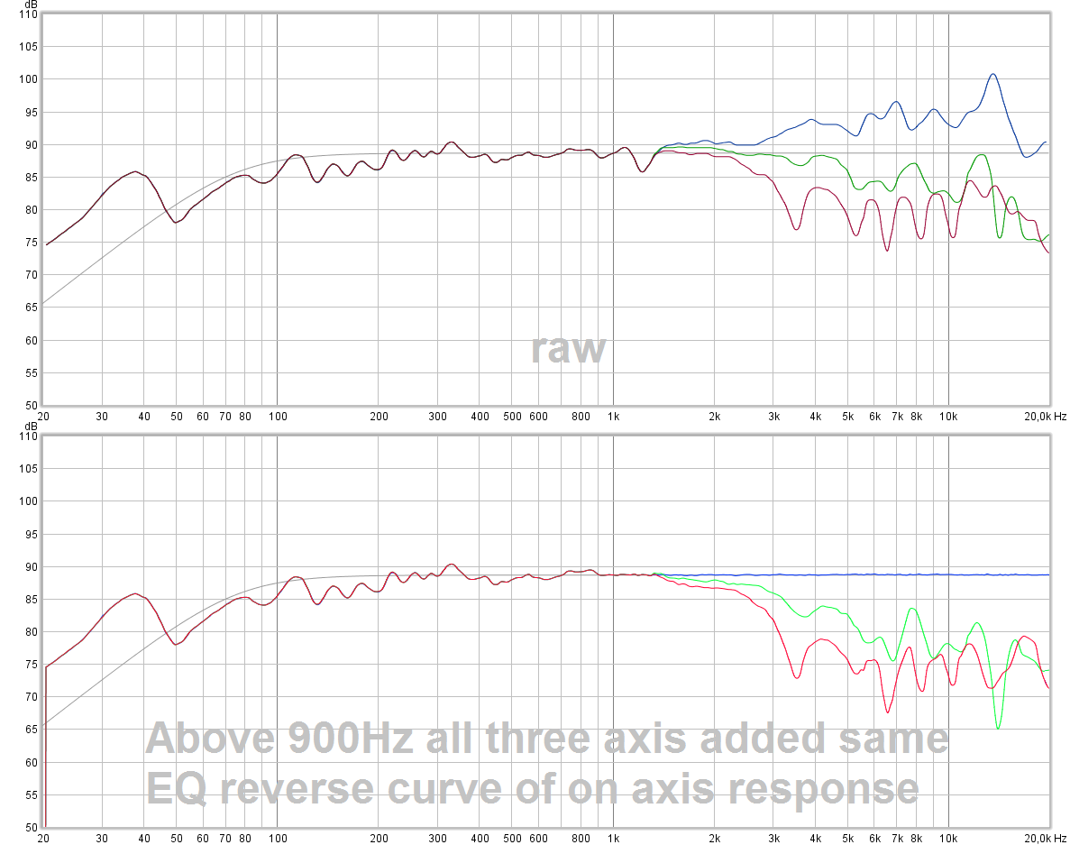

In second below had some fun in Rephase EQ raw curve flat on axis above 900Hz and see how that same EQ looked for 30º and 60º axis and in third below theoretical it looks pass 60º point a little lower than 4kHz and below 20º looks happen above 11kHz.
