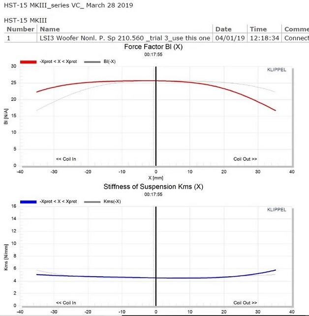

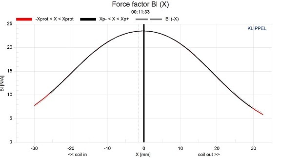

A couple of years ago, there was a lot of marketing wank about the Peerless STW 350F 15" subwoofer, with it's massive 7.4"coil, and an employee from Tymphany, Mr. George Bullimore was purveying fallacies about the product.
Nick from Stereo Integrity purchased one off the shelf and had it sent to Warkwyn for Klippel testing. It's suspension was the limiting factor for distortion, at a whole 5.95 mm one way. Nick sent one of his own drivers at the same time for Klippel testing, the HST 15, - it mopped the floor with that POS Peerless product.
Mr. Bullimore tried in vain to prop up his product, but he ran and was never heard from again.
Ad copy read - capable of 45.5 mm of cone excursion before any major loss in motor strength. ( Bl )

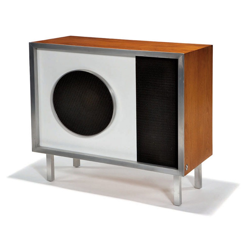

Aside from your personal insult attack, can you actually name any way in which a 15-inch driver today has features which make it audibly better than a Stephens 150W (woofer) made in 1965 with a resonance of 20 Hz, a very light cone, substantial alnico magnet with hole in the middle, cast frame, edge-wound rectangular coil wire*, and accordion surround.

Audibly better..... Well since flat native FR is not a necessity these days with the advent of DSP and FIR correction, modern 'stoves' of a couple of KW's worth of power, the only things left are suspension linearity and longevity, cone strength, and motor topology.
Split inside/ outside wind coils these days have much flatter Bl curves, drivers that are machine assembled have the same unit to unit consistency in terms of adhesive quantities. Shorting rings ! Le/x curves that are flat.
Neodymium and Ferrite do not have the same issues that Alnico does. A large mechanical shock from shipping could render your 1965 Stephens a paperweight. Also, a large burst of energy can cause partial demagnetization. It's likely down about 10% in gauss in the gap or more from age, unless you have had it recharged.
With a 20hz Fs and a light cone, ( how many grams? ) that is a very, very weak suspension, but don't worry, I am sure the doping on it has caused the suspension to become almost rock hard in the past 57 years since it was born.
Since you always love analogs, and deify Lotus, have you ever driven on a race track with a soft suspension vehicle and next to zero damping? Regardless if you put your beloved carbureted Stephens in a sealed box to give it some restorative force, it's still not going to track an input signal like a modern driver. Be sure to set the points first and sychronize those carbs. Maybe even pull out the bleach to give your bias plies a good burnout first.
Anytime you want to wax poetically about your Stephens, just pull out the Klippel results for it.

OK, I admit it: it was a trick question. I was wondering if the Stephens 150W is audibly and visually distinguishable from a couple of top of the line JBL drivers today (and for a real good reason, as some with a grasp of audio history may know)?
