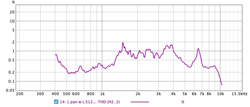

Since you ask, here's my ESLs and a Foster ribbon (XO around 3500 Hz). Domestic volume. Lotsa DSP. I would get lower THD+N readings, but I'd have to figure out how get all the cars off my street and the lawn mowers too.Besting electrostats, certainly at slightly elevated SPL.
Your turn.*
B.
*actually, no way to reliably compare one amateur REW plot with ancient equipment (like mine) to another plot. But I think mine looks pretty good.

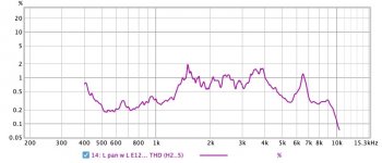

Your turn.*
B.

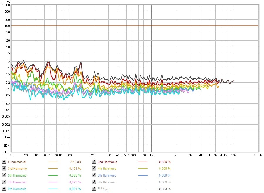

I'd say an array of the Rice and Kellogg drivers doesn't have to be ashamed of their results...
Also a DIY attempt with REW with a calibrated microphone. And a busy road messing with the results! 25x 3.5" drivers running full range.
Measured at the listening spot at 2.7 m in a functional living room with DSP.

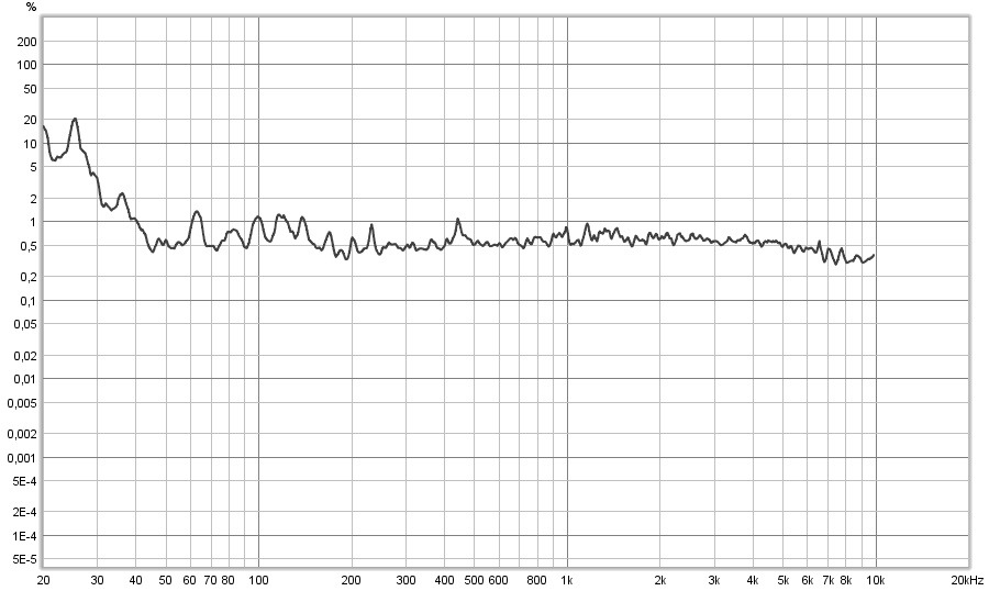

Browsing around in my many measurements from the origins of my project do show very similar results taken at a later date....
SPL calculated back to the standardized 1m distance is 86dB/1m.
Again as measured at the listening spot in my living room at 2.7m distance. 2 years later and those same silly small 3.5" drivers.
I'm pretty sure others could present even better results using Rice and Kellogg drivers.

Distortion measurements don't say much on an absolute scale without a whole lot context to the testing besides just SPL. And when you think about it, not a lot that audiophiles do about THD. But it is a tool for an individual to use in their home comparatively.Distortion measurements don't say much without information about the SPL.
My THD+N measurements get better the louder the test - because of the residual level in the testing context... which I can't usefully assess.
Frankly, I don't think THD is much of an issue today and with music systems. On the other hand, I have never found any measurement that helps assess transient performance ("fast bass") as with motional feedback R&D.
B.
Those speaker curves are fabulously better than anything I have ever seen before on any occasion ever.True,
B.
Very nice results. However, for comparison reasons I would like to see figures for 94dB @ 1 meter. It appears to be some sort of convention. For example, AudioXpress always measures domestic drivers at that level. I will take some of my own system over the weekend.True,

Why is speaker distortion measurement very high? Maybe you use high distortion amplifier?
In this forum @xrk971 made some measurement:
https://www.diyaudio.com/community/threads/virtual-audition-of-very-simple-quasi-mosfet-amp.295286/
The measurements I've shown in this thread are taken at the listening spot in a room at 2.7 meter distance. They includeWhy is speaker distortion measurement very high? Maybe you use high distortion amplifier?
the room effects.
In contrast, XRK's measurement was semi anechoic and most probably taken about an inch from the cone or even less.
