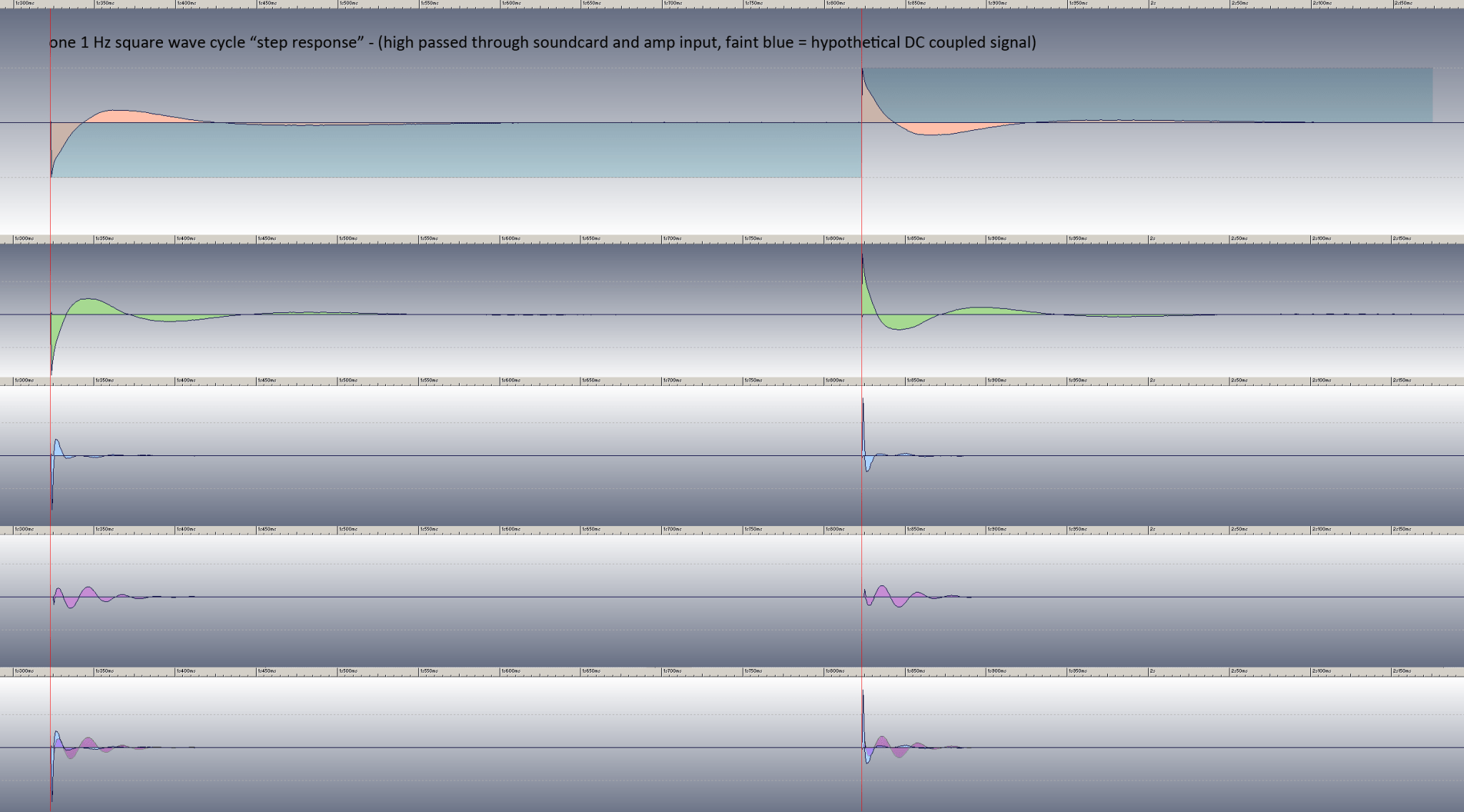

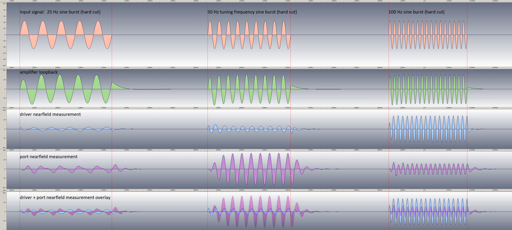

here is a (very big, zoom in to view details) image with these signal traces:
(image split up due to forum max image width restriction)
some remarks:
- source signal: 25 Hz sine burst (1 octave below tuning), 50 Hz sine burst (BR tuning frequency), 100 Hz (above tuning), one cycle of a 1 Hz square wave (quasi step response, note that the soundcard output is not DC coupled, so a strong highpass effect is visible! theoretical output as overlay
- loopback signal taken from the amp output
- driver output nearfield measurement
- port output nearfield measurement
- driver and port output overlay

some remarks:
- polarity should now be correct for the speaker!
- port has a lower surface than the driver Sd, can be seen for the 25 Hz signal: port is slightly stronger, 180 out of phase.
- the 25 Hz port signal is not symmetrical and somewhat distorted. but it's not audible anyway - cancelled out by driver and port being 180° out of phase. the harmonics however are probably audible!
- all port signals show a roughly 2 cycle tuning frequency trail, mostly visible at the "step response", but also at the end of the 25 and 100 Hz burst.

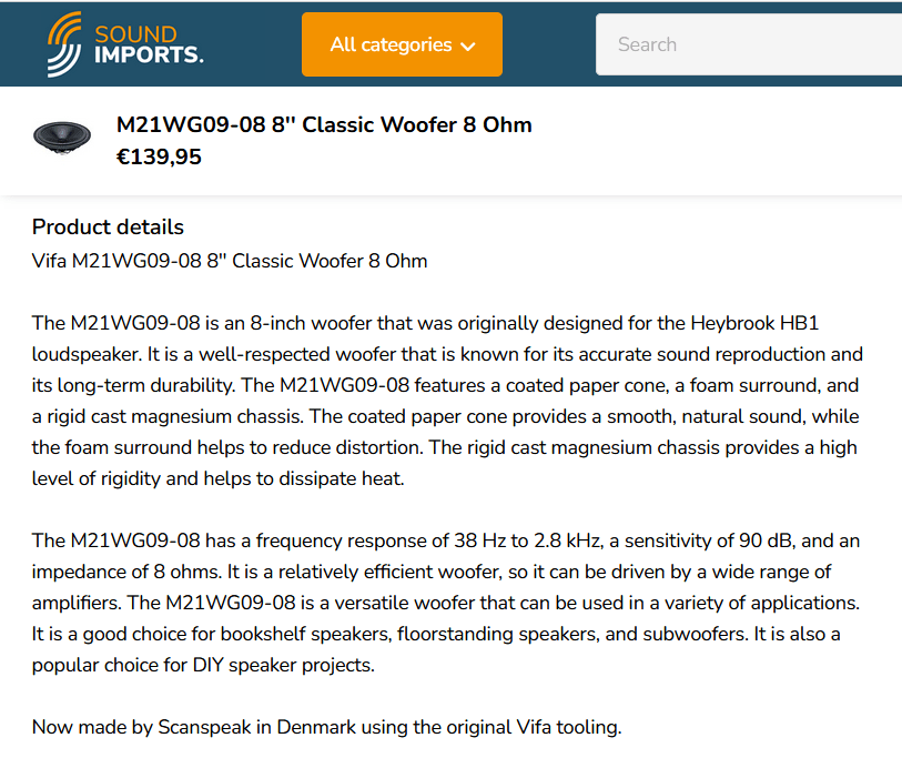

OK, Amazing that a woofer designed before 1988 is still in production, or is it available as old stock? Regardless, not a viable driver for putting in a modern design. I would really like to have a driver with a modern linear BL motor, shorting rings and, a nice oversized spider with high compliance. I want the best of both worlds, old and new. Nobody offers that. M21G-09 Data Sheet

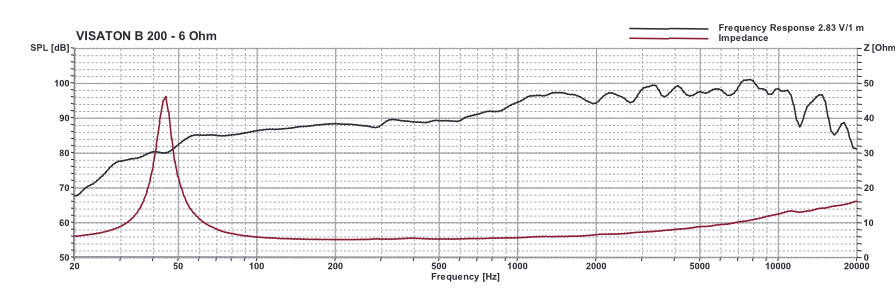

Arthur,Visaton have one that totally blows the sealed aren’t efficient trope out the window. B200 with 96db efficiency. https://www.parts-express.com/pedocs/specs/292-664--visaton-b200-spec-sheet.pdf
You are confusing on axis sensitivity with efficiency.
The Visiton B200 nominal 6 ohm "full range" loudspeaker is only four ohms over much of it's usable range as a woofer.
2.83v is 2 watts into four ohms.
Disregarding the 2-3dB gain over a 2volt input equivalent to 1watt/1m, it's sensitivity is ~96dB at 2000Hz where its dispersion "beams" at 60 degrees.
It's 2.83v sensitivity drops to only 80dB at it's Fs of 40Hz.
Reaching its (over..) rated Xmax of 3.42mm and power rating of 40 watts it could max out at ~90dB at 40Hz in a large sealed enclosure.
Not bad for a sealed 8", but not blowing any windows out

The manufacturer says it’s the “mean sound pressure level”. I’m assuming that’s at the standard 2.83V at 1M on a standard baffle. Put it in a box and you will get some lift an octave up from resonance which brings it back to 90 db.Arthur,
Art
