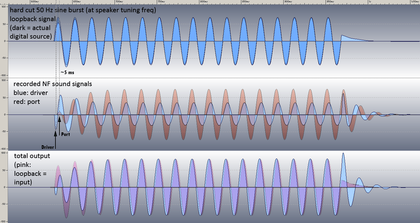

After closer examinationwell ... I was just doing something very similar!
here are my graphs, recorded with my current investigation loudspeaker, as shown here.

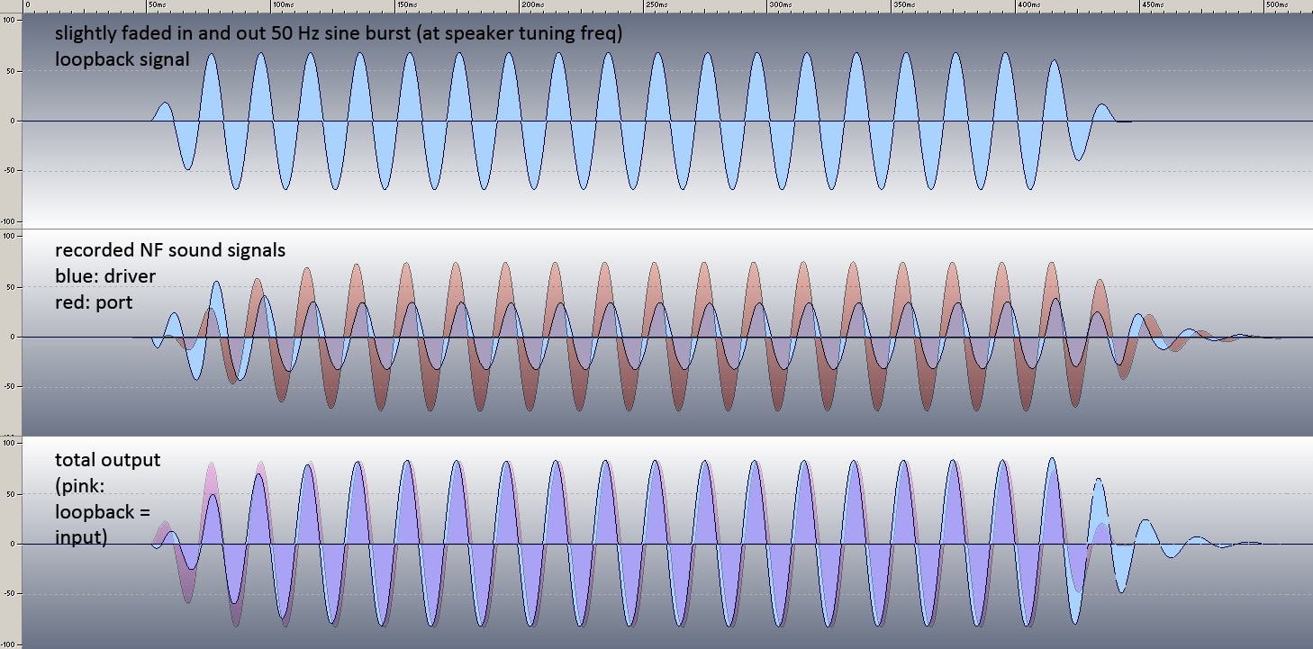

I used two sine burst signals at 50 Hz (bass reflex tuning frequency of my speaker), one with short fade-in and fade out cycles and one with hard start and stop (of course this includes high frequency contents, but the midwoofer has quite some frequency extension).
bass reflex measurement with faded-in and out 50 Hz sine burst:
To give another interpretation I see a driver to port delay of about 5 ms. Maybe @stv can comment on how much of that is propagation delay from the distance between driver and port exit?

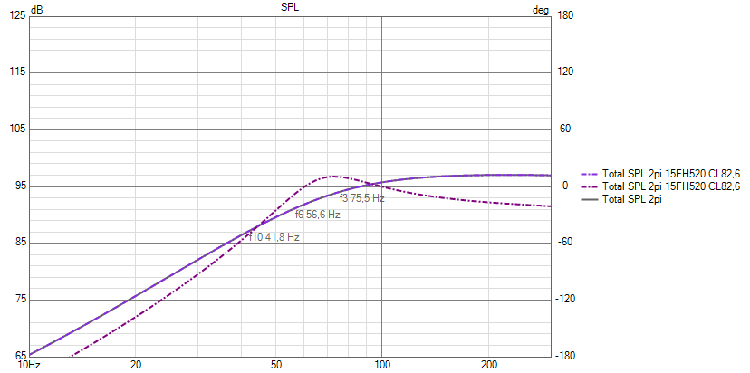

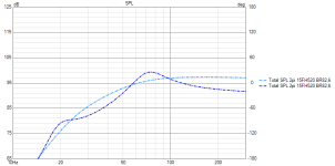

This is fun experiment with box simulator to vary the driver TS parameters. And while one is at it why not modulate Sd, Cms and Le as well

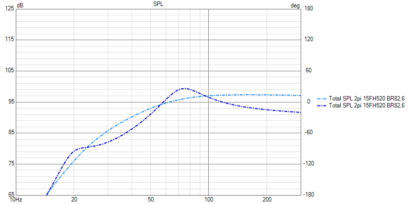

Dramatic BL drop makes this kind of graphs with system I had open in simulator

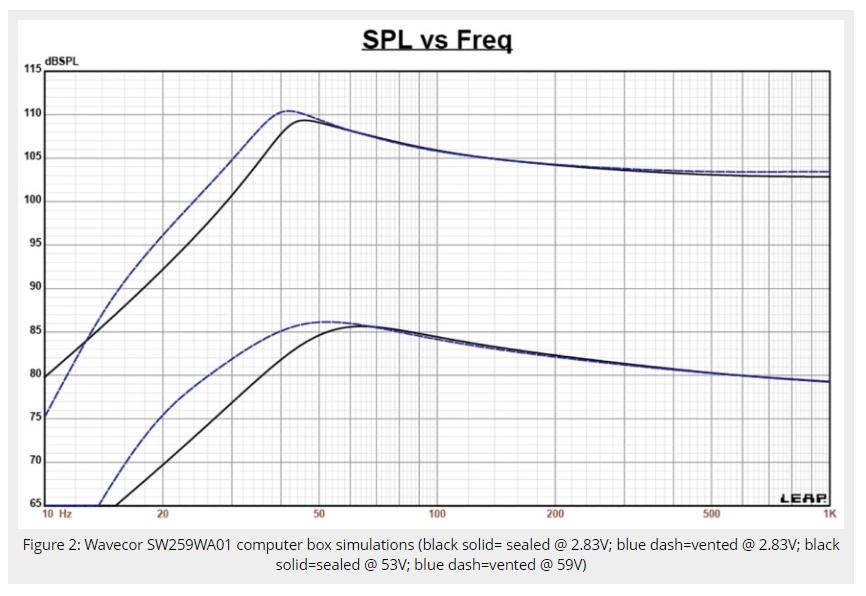

edit. Test bench actually has this kind of graphs already visible, FR simulated with low and high drive level, I assume it includes at least some of the variable parameters.
![high-level.png high-level.png](https://www.diyaudio.com/community/data/attachments/1219/1219144-a242093674a9da4d63422b7520221828.jpg)

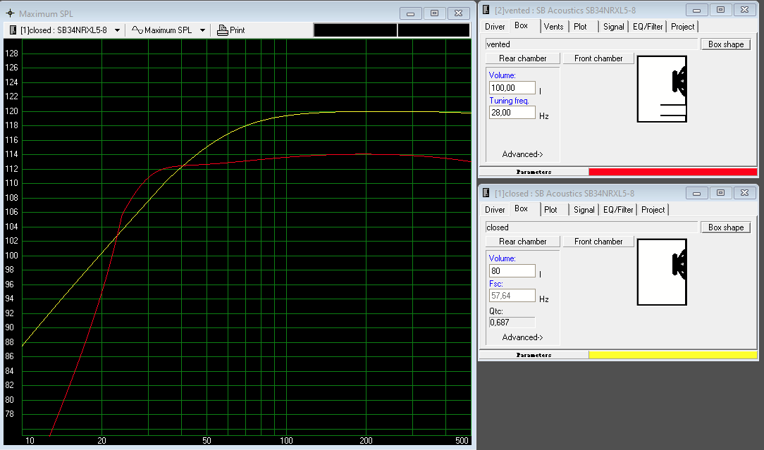

WinISD has a nice function Maximum SPL, here is the simulation 2x 12" vs 1x 12" ported.
Conclusions:
With "normal" music and peak content at 60Hz (kick drum) the 2 12" have significant more SPL to deliver. Around the resonance frequency of the port the single speaker still "outperforms" the closed setup (in terms of SPL ;-)). When you want 20Hz in ATMOS reverence level ... 2 12" are not enough.
The nice thing with closed speakers is that you can adapt it per EQ to your room and listening position as you want - you "just" need to be careful with your maximum listening level. So put enough of them in your room.
