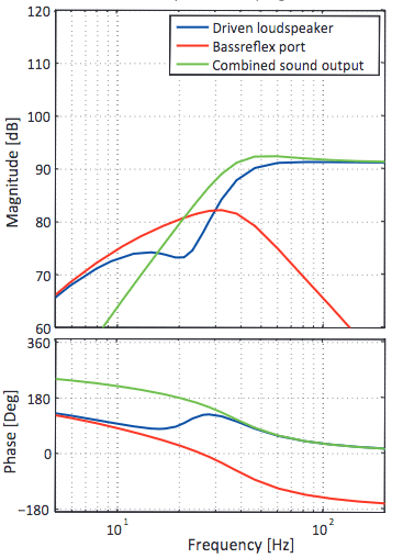

The data presented by @Tenson and @stv demonstrates that the BR system has minimal ringing. When the forcing function is removed, the output drops to nothing within 1 cycle. Thanks !
What's always with this whole ringing thing?
(rhetorical question, please don't answer)
In a minimum-phase system, ringing means a high(er) Q , which MUST result in a boost in the freq resp and a jump in the phase response.
Nothing more, nothing less.
There is literally nothing more to it from a minimum-phase point of view.

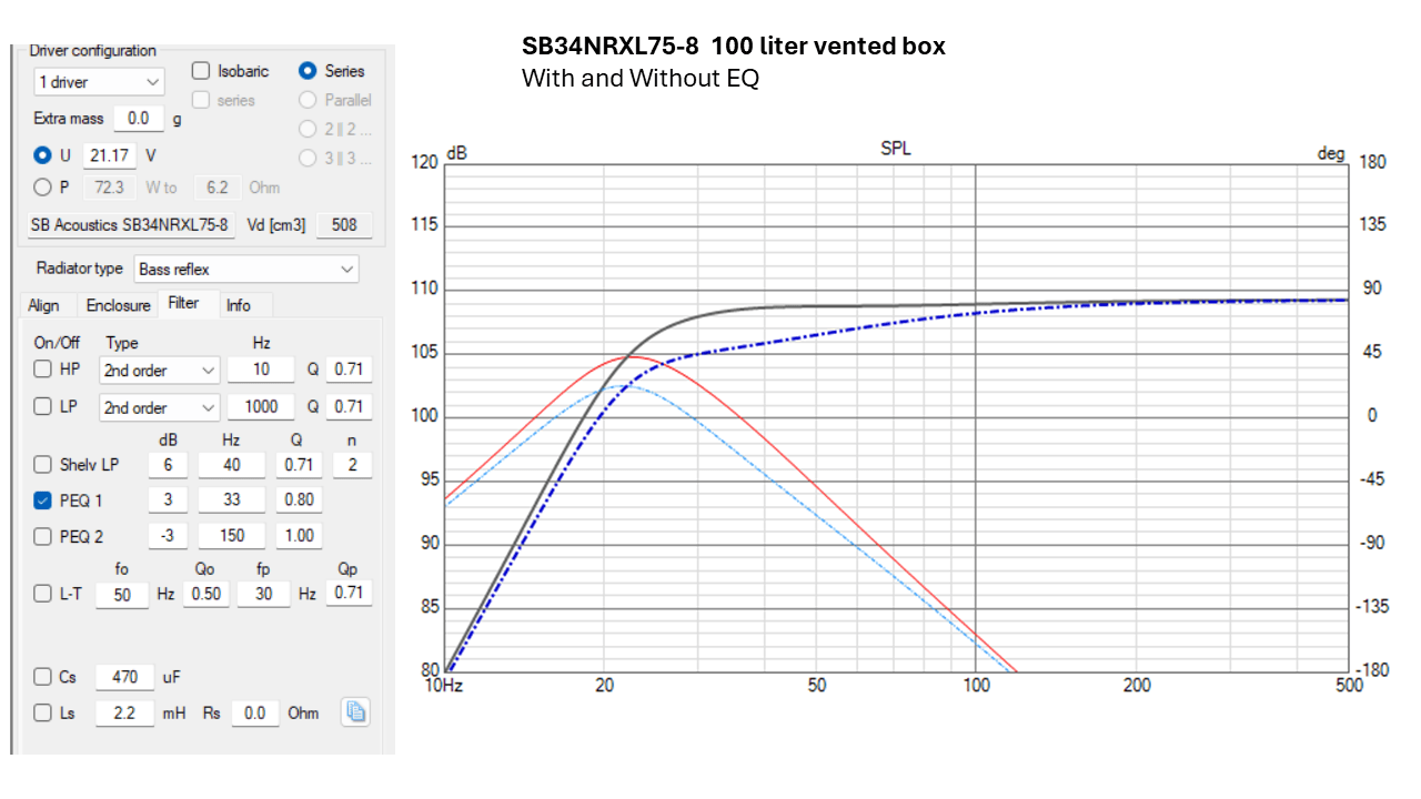

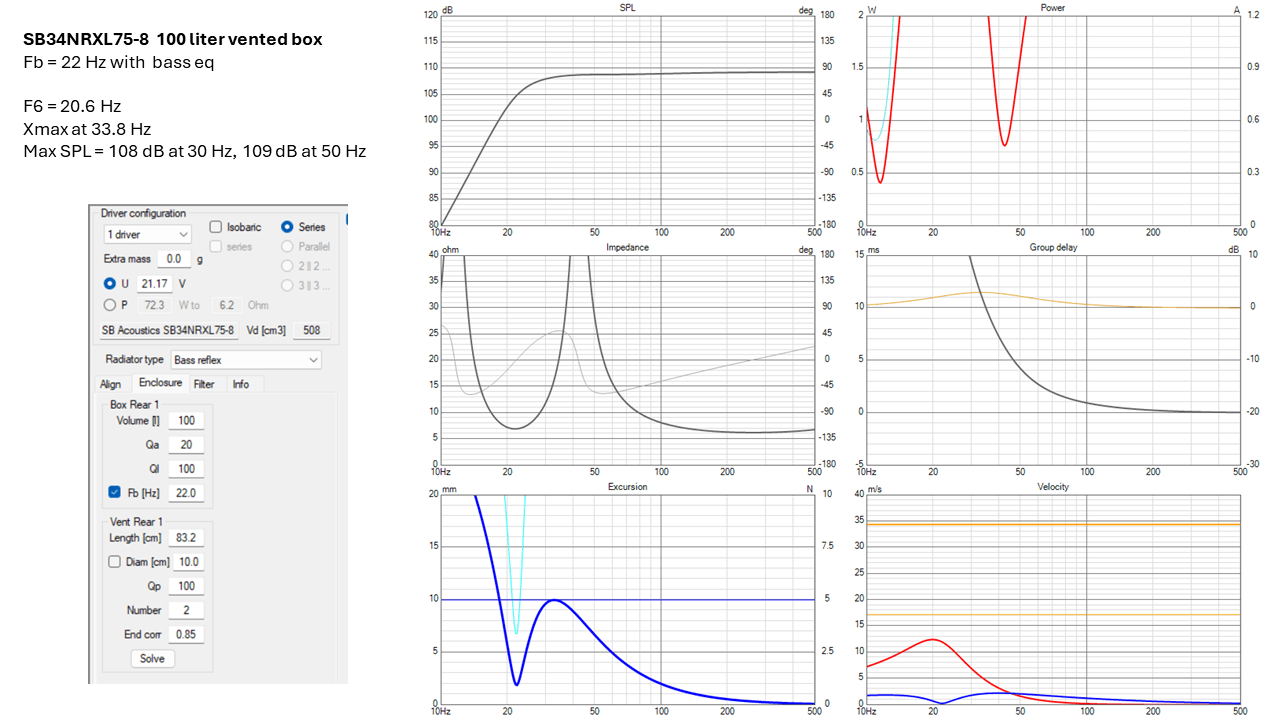

I would like to explore the idea that @DSP_Geek put forth in post # 58. Tuning a BR very low, and using EQ to make it flat. I occurred to me that in my sealed box systems, I always use DSP to EQ the bass, so a fair comparison to BR would allow the BR system to also use EQ.

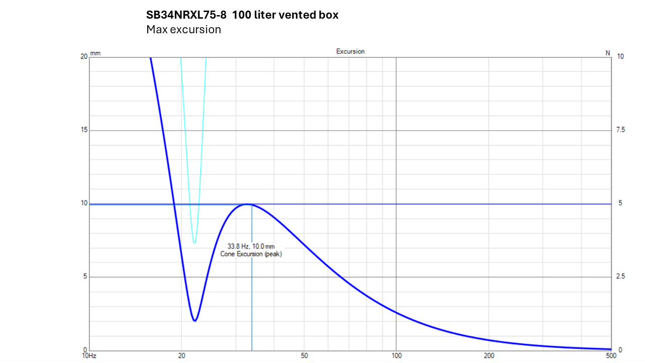

Here is an SB34NRXL75-8 in a 100 liter vented box, tuned so that Fb=Fs=22 Hz. It results in a shelved response, but a 3 dB PEQ brings it back to flat. The F6 is at 21 Hz, and we hit Xmax at 34 Hz with 21 Vrms. At this drive level, we get 108 dB SPL at 30 Hz, and 109 dB SPL at 50 Hz. Since the tuning frequency is so low, group delay looks pretty good.

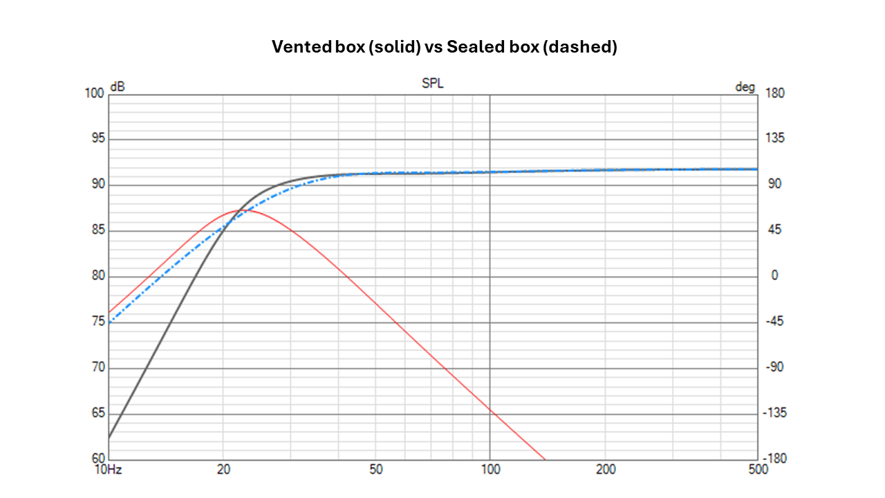

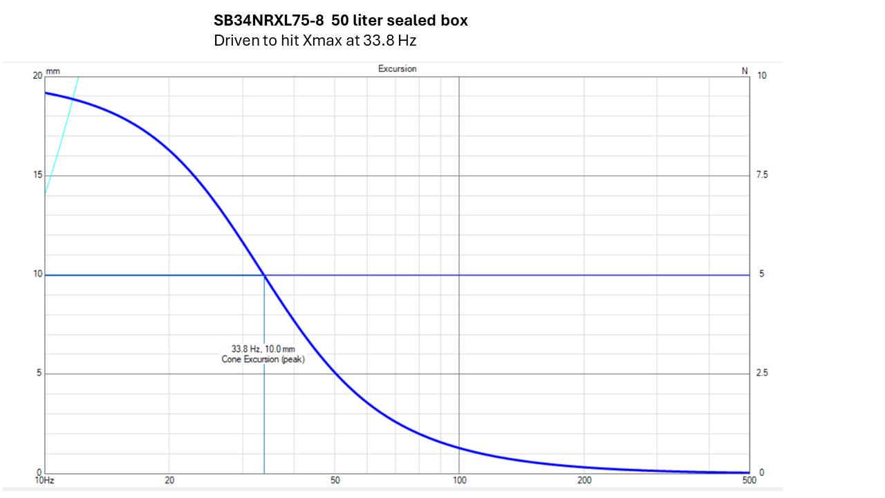

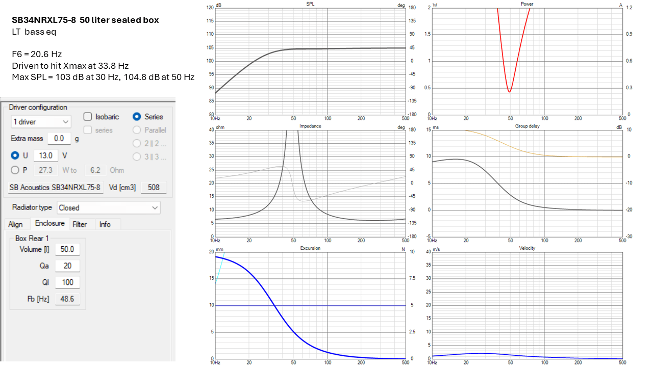

To compare to a sealed box, I used the same woofer in half the volume (50 liter). To be honest, this is not an ideal woofer for a sealed box application, the Qts is less than 0.3, so it needs more EQ boost than I would normally be comfortable with. The sealed box could have been made smaller, 40 liters would have given almost the same result. But this is a simplified theoretical comparison.

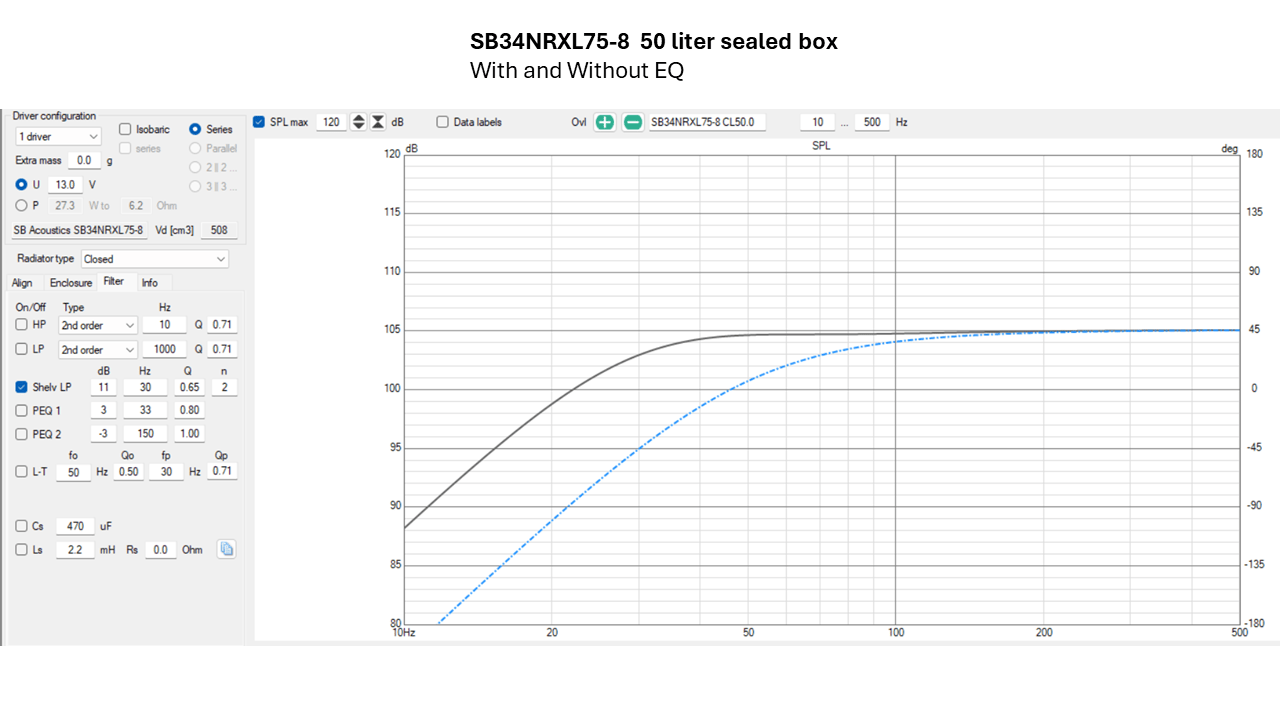

In a sealed box, we get an Fb = 49 Hz and Qtc=0.59, so this is a highly damped sealed box with a very gentle rolloff. I applied an 11 dB shelf EQ to get the same F6 as the vented box, 21 Hz. I increased the drive level until I hit Xmax at 34 Hz, just like the vented box. Drive level was 13 Vrms, where we got 103 dB SPL at 30 Hz and 105 dB SPL at 50 Hz.

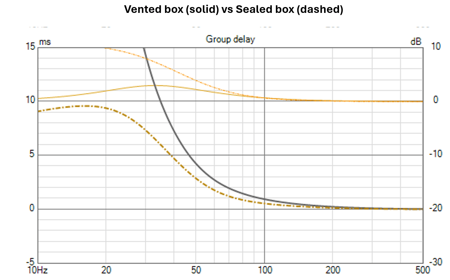

So in this case, the vented box has a 5 dB SPL advantage over the sealed box. In terms of group delay, the sealed box has marginally better performance above 40 Hz. It is only below 40 Hz that the difference becomes significant. I have my doubts that group delay below 40 Hz is important. I was surprised at how close they were, and I don’t believe that the sealed box has a meaningful group delay advantage over the vented box.

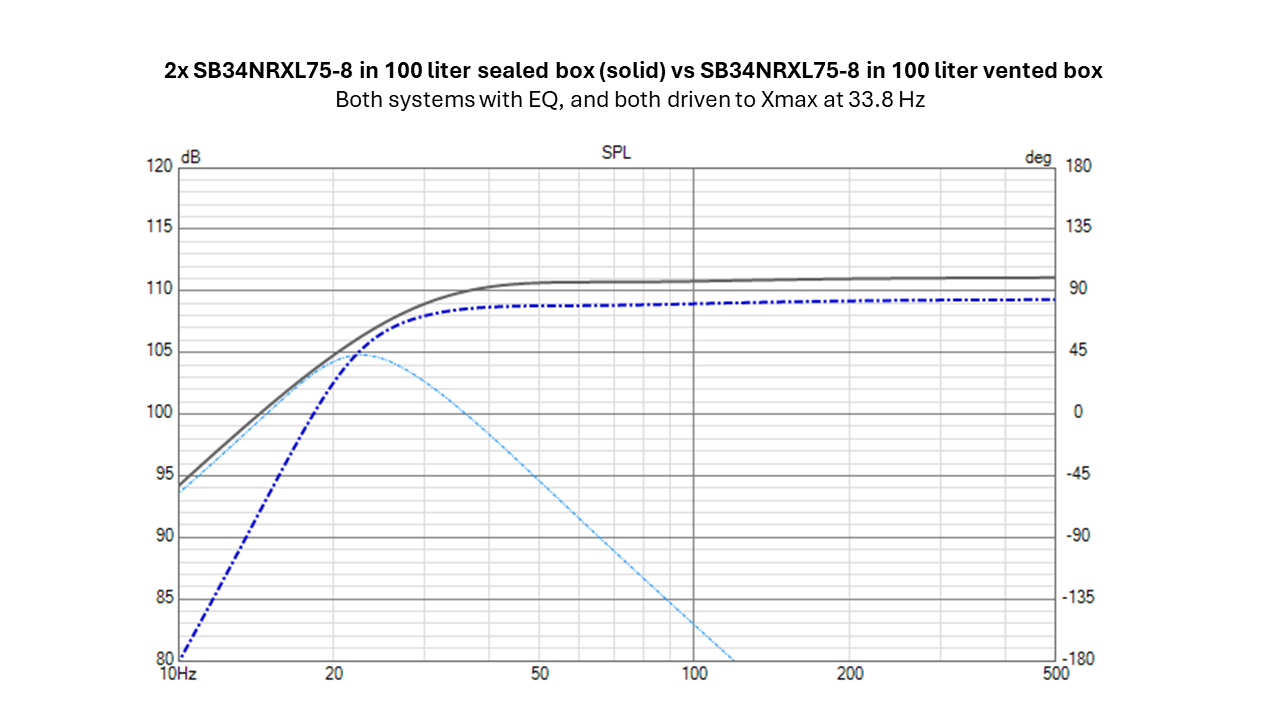

Now assuming we have the space to fit a 100 liter box, what kind of sealed box system performance could we get? Putting two of these woofers in parallel now gives us a significant advantage over the vented box. Sensitivity and efficiency both go up, and max SPL under the same conditions is now 109 dB at 30 Hz and 110.8 dB at 50 Hz. As I pointed out before, the box size could be reduced without impacting performance. The only downside is the need to buy another woofer.

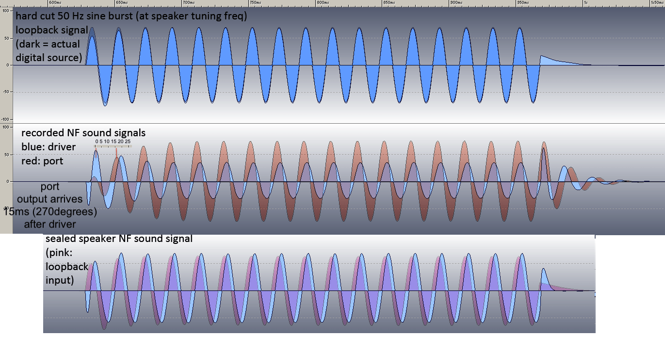

well ... I was just doing something very similar! :giggle:
here are my graphs, recorded with my current investigation loudspeaker, as shown here.
I used two sine burst signals at 50 Hz (bass reflex tuning frequency of my speaker), one with short fade-in and fade out cycles and one with hard start and stop
Really appreciate the detail you have put into documenting your port research.
50Hz is a nice number to work with, 1000ms/50Hz=20ms being one cycle (360 degrees) duration time, each 90 degrees of phase 5ms.
At Fb (bass reflex tuning frequency) your "hard burst" test clearly shows the first arrival of the port output delayed by 15ms, (270 degrees) from the driver output:
We hear complaints about the amplitude level "ramp up" time of the port and it's decay time, seeing the ported compared to a sealed in this manner shows clearly shows what a static phase and frequency response chart can not:
The trend towards more compressed and "boomy" (little dynamics, slow decay) bass in pop music tends to mask the transient difference between enclosure designs.
as can also be seen in @Tenson's graph, during the first cycle of bass reflex speakers the driver has an increased excursion, because the resonator does not yet provide the counteracting air pressure.
I also observed something similar with my test bandpass enclosure, see here.
apparently the well known excursion limiting effect of resonator enclosures cannot protect a driver from transient high excursions.
Since the driver's excursion at Fb is at it's minimum between the two impedance peaks, a transient peak centered at Fb shouldn't be a problem compared to one on either side.
That said, it's a difference I was not aware of, and would explain problems I've heard in some bass reflex alignments not designed to be maximally flat in the pass band.
Thanks for posting the test results!
