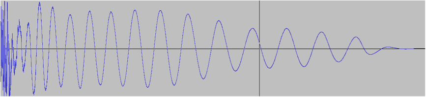

These graphics show transient behaviour since the waveform starts from zero.Again, the confusion stems from faulty methodology. You simply can’t look at time/delay and draw conclusions with a steady state signal. Plse redo with a transient, f.i. a step, and get back.

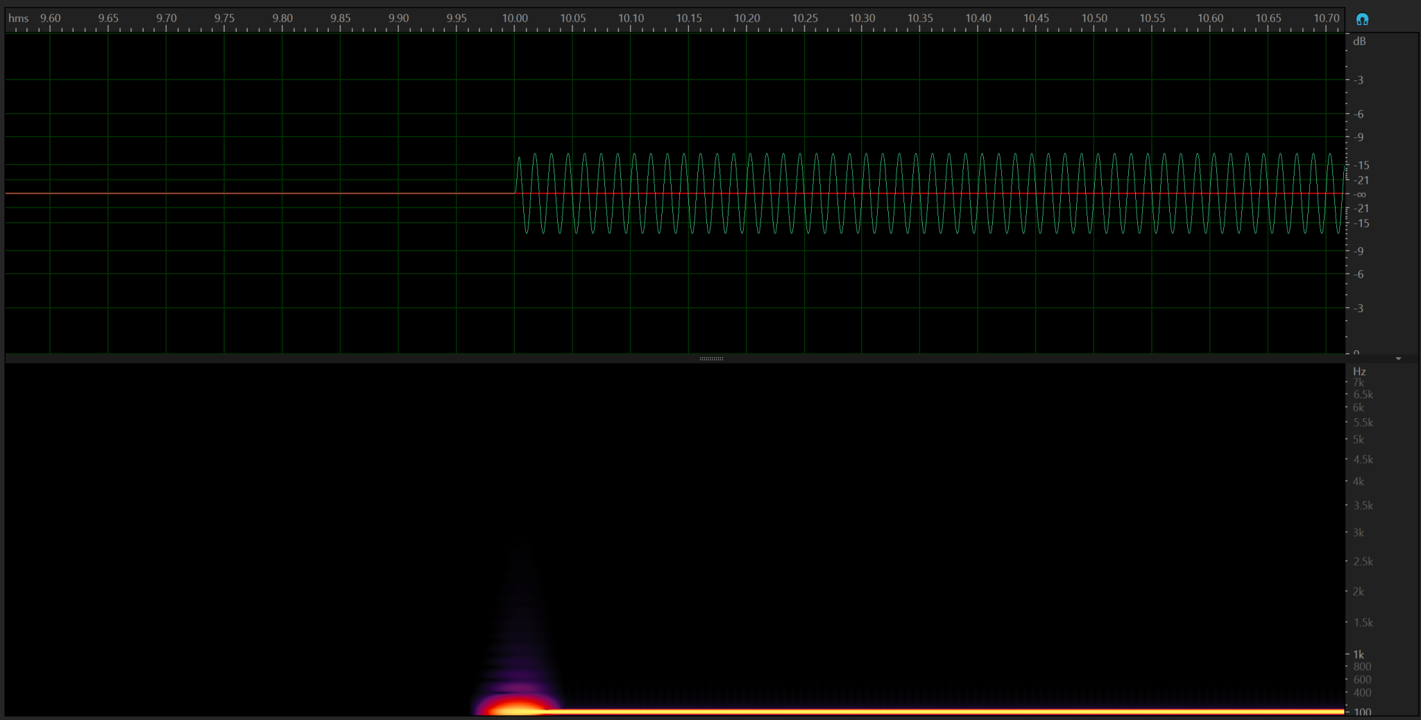

Do you mean an impulse response? I don't think that would show much we don't see more clearly with the graphics provided. What did you want to see?And just when I thought I’ve seen the bottom of the barrel, a sine is now a transient.
Laplace and Fourier be damned!
Any change from zero to a non-zero velocity includes a transient. Have a look at the spectral display here.

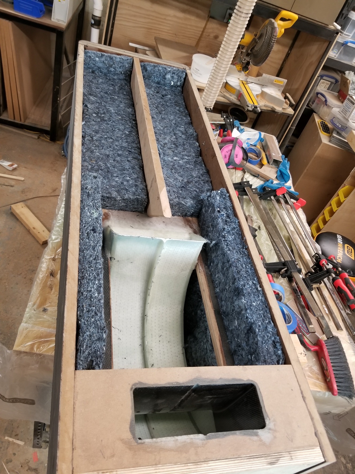

I stole a page out of Genelec's book when I build this port. They have their "Laminar Spiral Enclosure", and I made a radius port:Ok guys I admit being a bit arrogant! I'm aware of problems with small sealed and open baffle speakers too. Some issues can't be avoided at all but in general the designer always has some constraints as limiting freedom of choices. Annoying, even frustrating... Finding ways to eg. effectively reduce port noise can be difficult, please try to find a pic of Genelec small 2-way monitor's reflex tube! I have seen those at the factory...

That's basically just what a Q-factor is.Do you mean an impulse response? I don't think that would show much we don't see more clearly with the graphics provided. What did you want to see?
