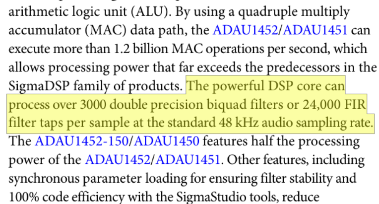

Coincidently I counted how many bi-quad filter I could run on an ADAU1701 at 44.1khz a few days ago! It was 100 bi-quads, limited by memory, while CPU was about 80% utilised. At 96khz I guess it would be 50 biquads. The ADAU1452 handled over 3000 biquads at 44.1khz.At higher sample rate smaller DSP IC's like the ADAU1701/1401 have only a very limited amount of filter blocks available.
Yes, because a ADAU1701 has 1024 instructions @ 48kHzCoincidently I counted how many bi-quad filter I could run on an ADAU1701 at 44.1khz a few days ago! It was 100 bi-quads, limited by memory, while CPU was about 80% utilised. At 96khz I guess it would be 50 biquads. The ADAU1452 handled over 3000 biquads at 44.1khz.
A little less when we include some overhead.
A second order double precision filter block, costs 10 memory blocks.
So yeah that leaves us around roughly 100 bi-quads
For 96kHz that's half.
A 100 taps FIR blocks will take about 103 memory instruction with one additional instruction for each additional tap.
Many years ago I found a great excel sheet to calculate the MIPS usage.
See if I can find it again.
The ADAU145x and newer ADAU146x series are a LOT more powerful.
They can do 20k FIR taps no problem.
Not that will be practically very usable, since it will give you a whopping 40ms delay!
Anyway, one might think that 50 bi-quads is plenty for just a speaker crossover.
But this goes down very fast in a multi-way system, even more so with additional dynamic filters (compressors etc) as well as some additional preset choices etc.
It makes zero sense, since they actually use a ADAU145x (I forgot which type exactly)I agree. I wanted to compare the Sigma DSP to the Hypex amp modules as their quoted 15 biquads per channel seemed very limiting.
This is even very clearly stated in the datasheet of the DSP IC.
So I have no idea why they build in an artificial limit.
Btw, I found the excel sheet again;
https://ez.analog.com/cfs-file/__ke...5F00_Sigma_2D00_100_5F00_MIPS_2D00_Usage.xlsx
source:
https://ez.analog.com/dsp/sigmadsp/f/discussions/65644/adau1701-instruction-usage-table
https://ez.analog.com/dsp/sigmadsp/...ctions-can-be-executed-per-sample-in-sigmadsp
