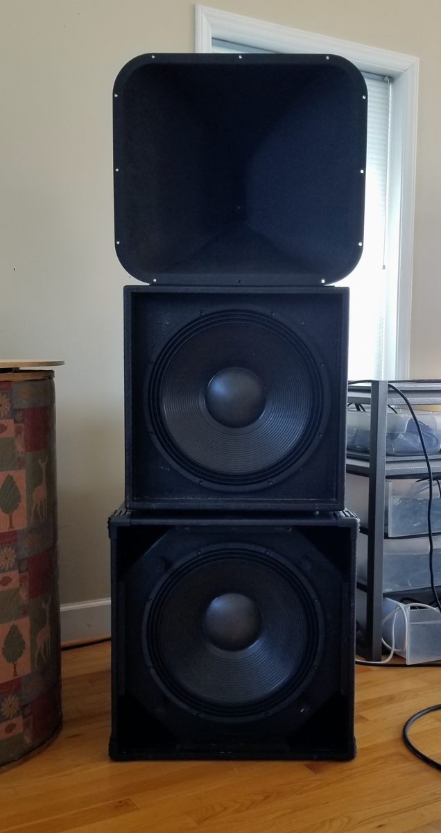

Could you guys comment on this stacked fullrange, in principle or concept, with respect to this discussion of so-called minimum phase and linearity?
https://www.diyaudio.com/community/threads/full-range-speaker-photo-gallery.65061/post-7675238
I had posted it over there because it used only fullrange drivers without crossover, though obviously a 2-way (there being no suitable multi-way gallery). While I cannot produce graphical and more technical measurements due to not having a "man-cave" setup that can be left overnight on weekdays -- I have done this "design and test by ear" dozens of times (since covid) to be reasonably confident of my method, simple as it is. (I have a Radio Shack sound meter too but not the space to use it for bass.)
BTW the micor55 "LX" in cabs cost me about 900 renminbi or $130 ;-) Over the range upper-bass to mid-treble (ears too old to judge directly above 12.5khz) easily the most realistic and detailed I've heard to-date.

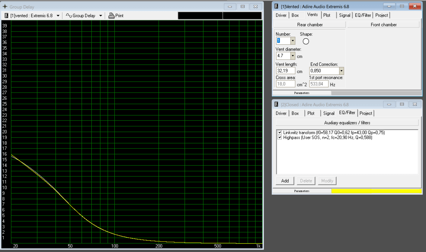

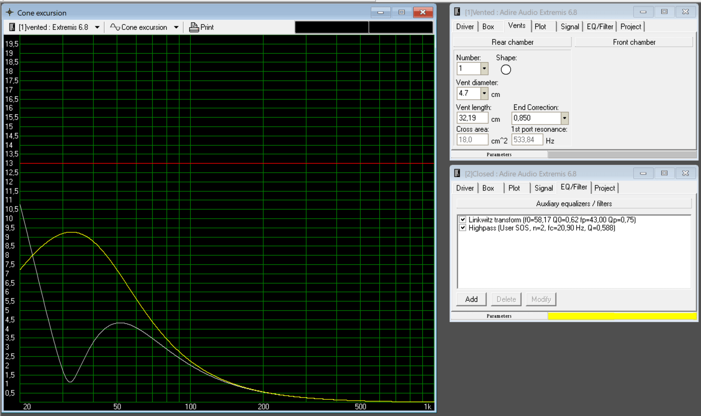

Just an arbitrary random driver (because it's the first in my database), and certain volume for no particular reason.
Both at the same sound pressure level (exact value not relevant)
Right of the bat, you already see a couple of these practical limitations.
They have exactly the same system response, therefor same group delay.
The cone excursion for the closed system is significantly higher.
Also the apparent power is higher (not shown here)
In this case the system response was fitted to the ported system.
So in reality we can probably have a "better" system response.
Meaning a less steep curve (lower f12 point) while maintaining roughly the same peak cone excursion.
Which also results in a better group delay (if that is your thing)
While the ported system has a 32cm long port with a resonance around roughly 530Hz
Not only that but it also adds an additional 0.58 liter to the system, that you have to compensate for in the cabinet dimensions somehow.
Not to mention the practical issues to try to fit a 32cm long port with a Sd of 18cm² (which is even on the small side) somewhere as well.
So yeah, pick your evil....
