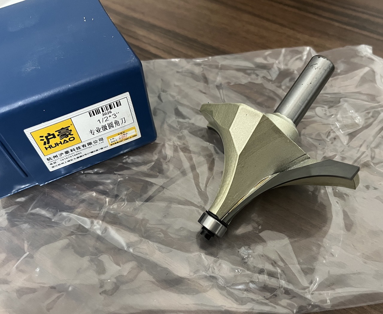

The brand is Huhao, seemed to get pretty good reviews
https://www.aliexpress.com/item/328...o.order_list.order_list_main.5.21ef1802MTdmDa
3026 is the code for the one I ordered
