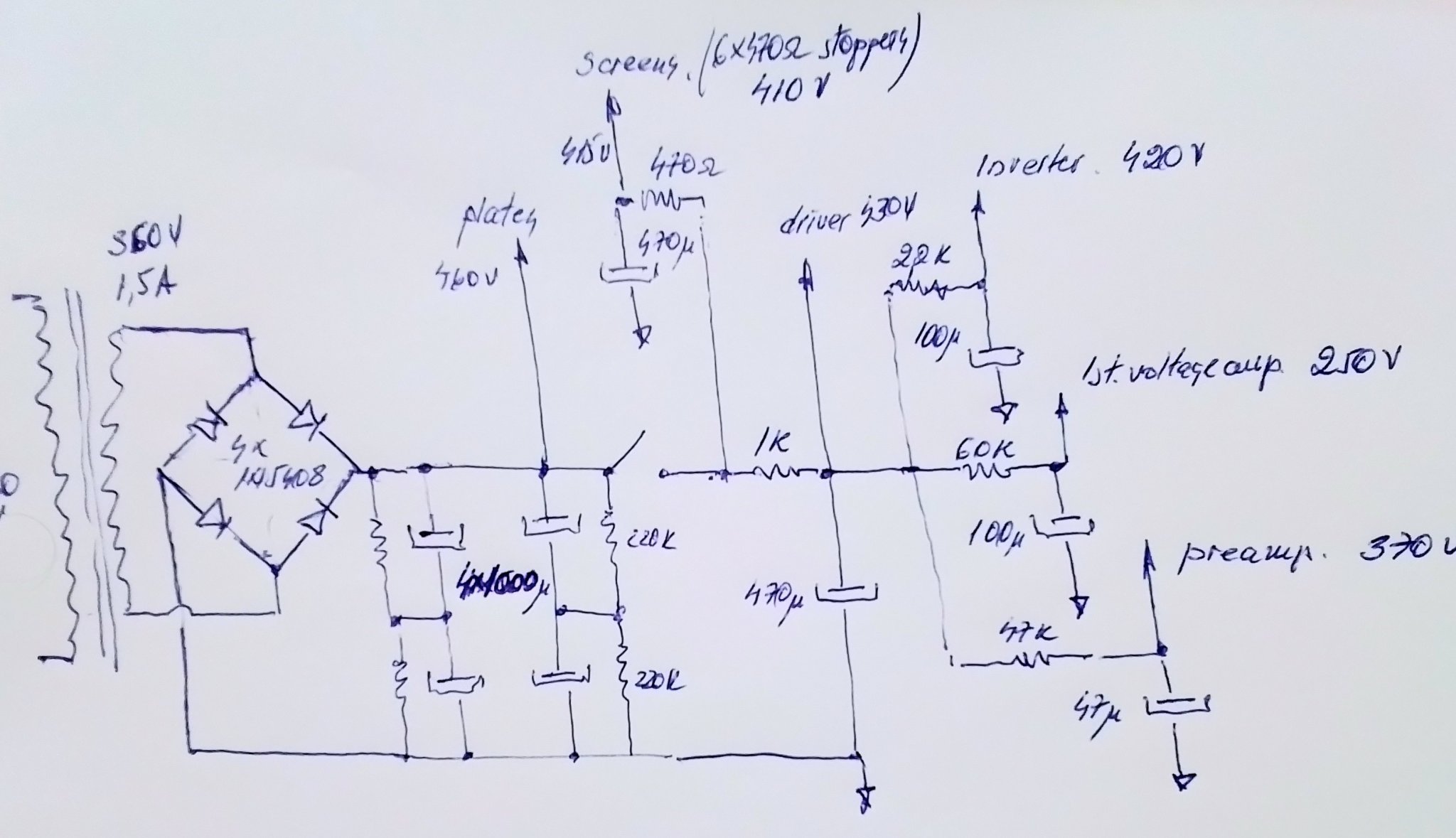

Ok. Did a test with new PT. primary: 230V , 1.2 ohm DCR, secondary 4 ohm DCR, 1.5A rated I get the follow measurements: mains 233V , secondary 363Vac, first cap 483Vdc iddling with 6x54mA = 6x2.7mA scr = (308mA) plates + 58mA screens and the rest of circuit = total iddling current 366mA.

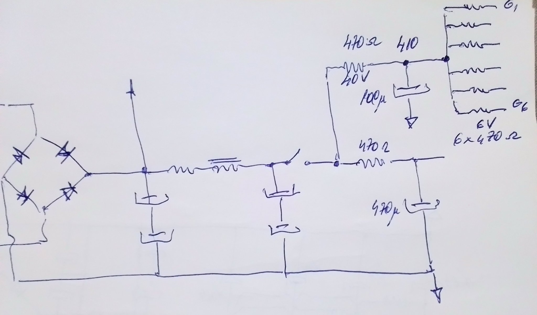

At onset clipping 36Vpk/4ohm- 160W output- the voltage drop at first cap from 483V to 470V and in the screen node cap from 476V to 456V. My only concern now is screens dissipation: dimmed with 12.5V over 470ohm stoppers meant 26.6mA x 444V= almost 12w - no good, should be reduced by half...and the start-up problem of course

If you can generate the peak cathode Current (and audio power) you require with a screen voltage lower than B+ it’s usually a good idea. Vg1 ends up being biased less negative for a target current, which means more gain and less chance of thermal drift/run away.
Regulated tends to be better, rather than using dropping resistors. Most of us cheat and use mosfets, or use a lower voltage tap on the supply that’s the right value without regulation or dropper resistors. Sand-o-phobes can make a regulator out of tubes. It doesn’t need to be perfectly regulated - you just want to avoid wild swings with signal level which introduce IMD.
Easiest thing in the world to do. You kill the king.
Take your string of zeners and shove a source follower after it. Use a gate stopper of 100 ohms. Clamp vgs with a 15 volt zener, and vgd with a reverse bias UF4007. Put a power resistor in the drain circuit calculated so VDS falls to zero at whatever current you want to start limiting at. RC network between the zener string and gate stopper if you need to get rid of zener noise for powering a preamp - unnecessary for a screen supply.
Sone designers prefer the screen to track the main B+, having it sag by the same %. This tends to maintain the same Iq as the supply varies when fixed vg1 is used. In that case, just use a resistor divider in place of the zener string. For those that go all tube, a cathode follower is used instead of a mosfet. It gets a little messier, as you usually need an isolated heater winding for that tube. Triode/pentode or dual triode combos can be used if you go to the trouble of doing real regulation with an error amplifier.

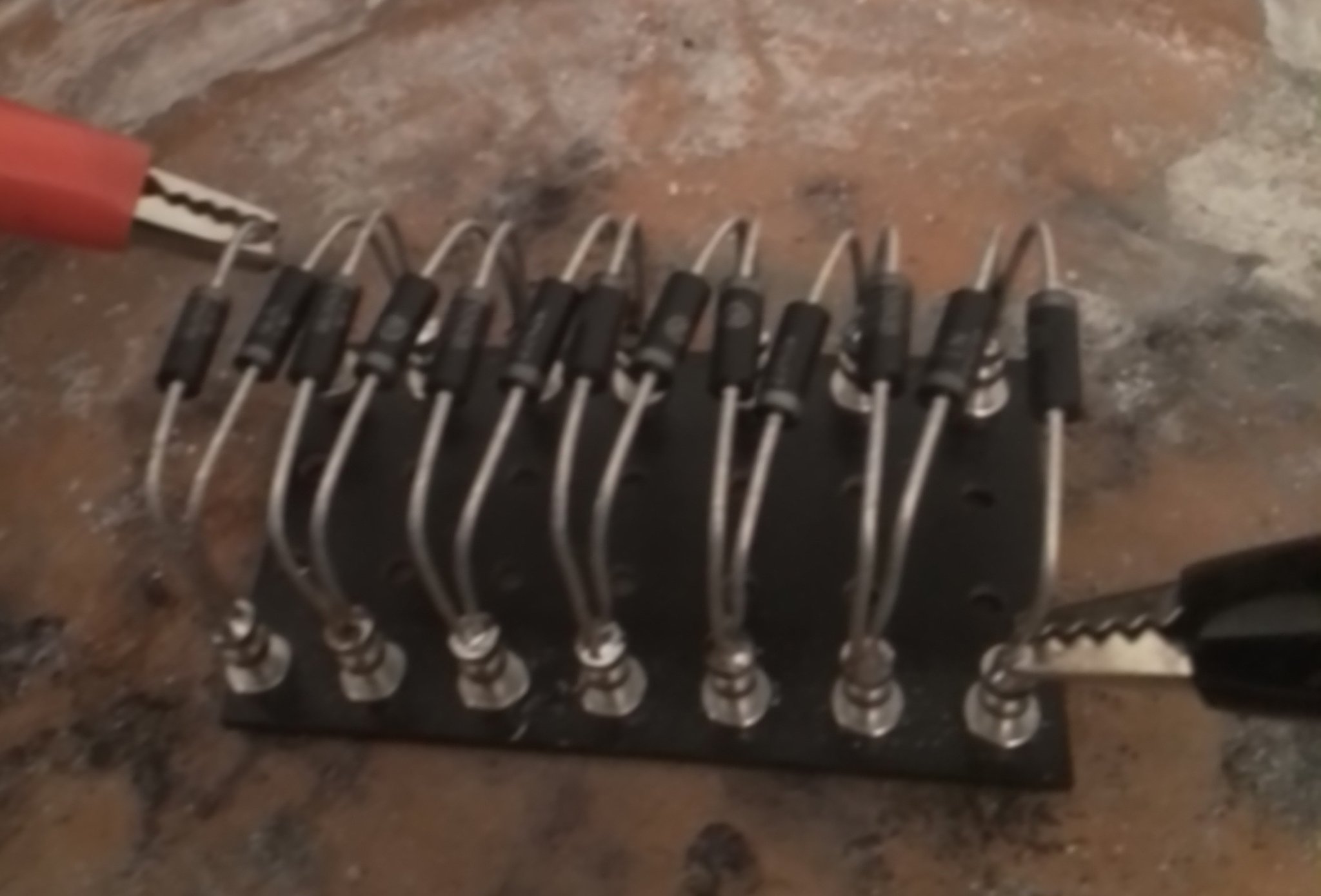

Hey. Even with zeners is not a simple task. It works well with small currents in 20-25mA range. Everything over produce a severe derating from nominal voltage rated value. I think lower voltage zeners (something into 30V range) will work more consistent in respect with current draw.
I use 47 and 68V zeners, with 12 and 15 V for trim (And other uses). Tolerance can be an issue, often a 68V is over 70. And you do have to watch dissipation in the zener and the pass device. If you get 306V when you were shooting for 300 it’s close enough. It is the simplest way to make an arbitrary screen voltage without custom iron.
...well, I used 51V 5W Imax 95mA. 7pcs. Expected voltage: 7x51=357V. But real voltage with 25mA through = 385V. That meant divided by 7, 55V. Okay, still acceptable.
Now, real deal in circuit : Input 470V, 1K series resistor, only 45mA through , meant 425V regulated (the screens draw 1.5mA x 6= 9mA total) at 45-9= 36mA through diodes. So my 51V zeners regulate 55V at 25mA and 60V at 36mA despite the fact are max rated for 95mA...
So, for around 40mA I think something like 30V will fit better, and work cooler of course.
I cannot limit the current more my screens draw 12mA each at 380V around so 72mA total. 1k series resistor fit well for this purpose please.
Those zeners seems works correctly rated for 1W around. I don't get it why they rated as 5W if not proper work? Even at 2.5W it smoked and are hot as hell...

I really don't understand how usable this zeners are. I did a jig with no less than 13 pcs of 30V / 5W. 480V input 1K series limiter. There are 7mA to screens and 40mA clamped through diodes . I expected 390V output but real output is more 430V around. The voltages over diodes are 33.5V around. There are still not usable at 1.3W ?
