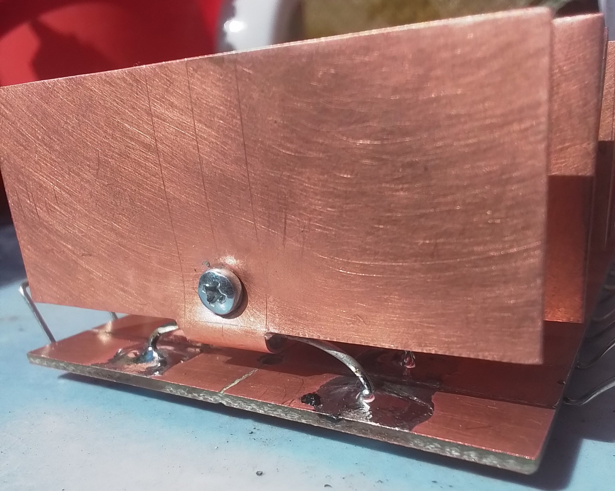

Thanks. Yes, short leads and board vertical mounted as trobbins suggested . The leads are short enough - 1/2 inch. Still the board pads are warm whilst the cases heatsinks are hot...
Maybe the zener case have propreties to conduct heat effective, They stated is made from "Void free, transfer−molded, thermosetting plastic" whatever it mean...
Perhaps try and appreciate the difference between thermal conduction in a metal, versus a plastic. The metal leads on either side of the zener are the lowest thermal resistance path for heat to take, as the leads but up internally to the pn junction where the heat is generated. The shorter the distance between package and solder joint the better. Imho, solder the entire length of each zener lead to the copper pad, to enhance the distribution of heat to the total pad.
Then, something is wrong. The leads now are pretty short 1/2 inch and are soldered to the both copper sides of the board. Still as I said the board pads are cooler than the case heatsinks. I don't know how much but I can keep the fingers on the pads for undetermined period whilst on the case heatsinks I cannot keep it more than 2 sec. (I ordered a temperature probe as necessary tools for this kind of tests). The Zener leads are generous soldered to the pads but not bended underneath (are already cut short). In this conditions I cannot imagine nothing but the solder should be responsable for a weak heat transfer. I used regular Stanol SnPb 40/60...🤔

Perhaps look again at Fig 32 of the Motorola link. 1/2" leads provide about 11C/W resistance to Tj. If Tj is dissipating 2W then lead has about 22C drop along its length - that is sort of the difference you are seeing when you touch the copper pad which is circa 22C below the junction temp.
If you reduce lead length to say 1/8" then the junction is only 6C above copper pad. It's not quite ideal like that, but the copper pad will end up hotter, and the junction will end up cooler, which is what you want.

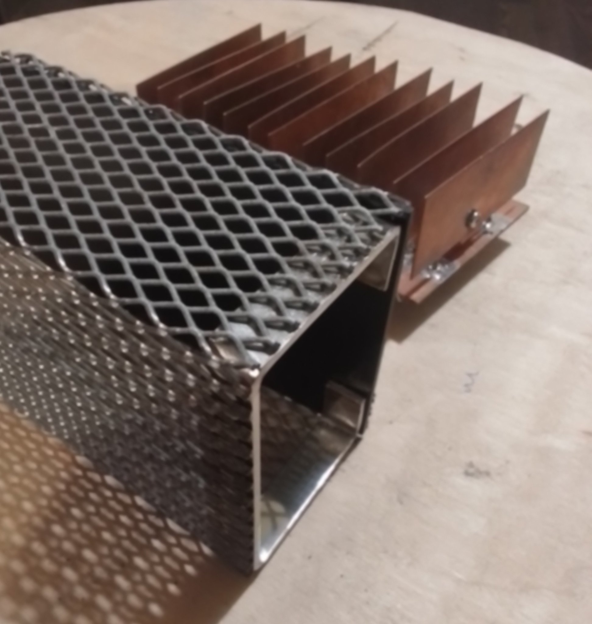

I figured a protection 'case' for the unit, included series resistors, on a FR4 board. It is completely transparent for air flow and will be mounted in the back of chassis , like an extension ( it have same hight ). Actually the current is more 75-80mA after tweaking. It is not perfectly stable, the voltage fluctuation from iddling to max is ca. 15V (less than 5 percent). We have to consider the PT also sag a bit ca.10Vdc after 1st power cap...still, so the fluctuation may be a consequence.A 25W transistor heat sink won’t be any smaller, but it will be more convenient to work with. If you use a fullpack encapsulated TO-220 and heat shrink on the leads you wont have to worry about high voltages and user’s fingers. Can’t mount that zener monstrosity anywhere it might come in contact with people or pets (Which means INSIDE the enclosure, where air circulation is limited).

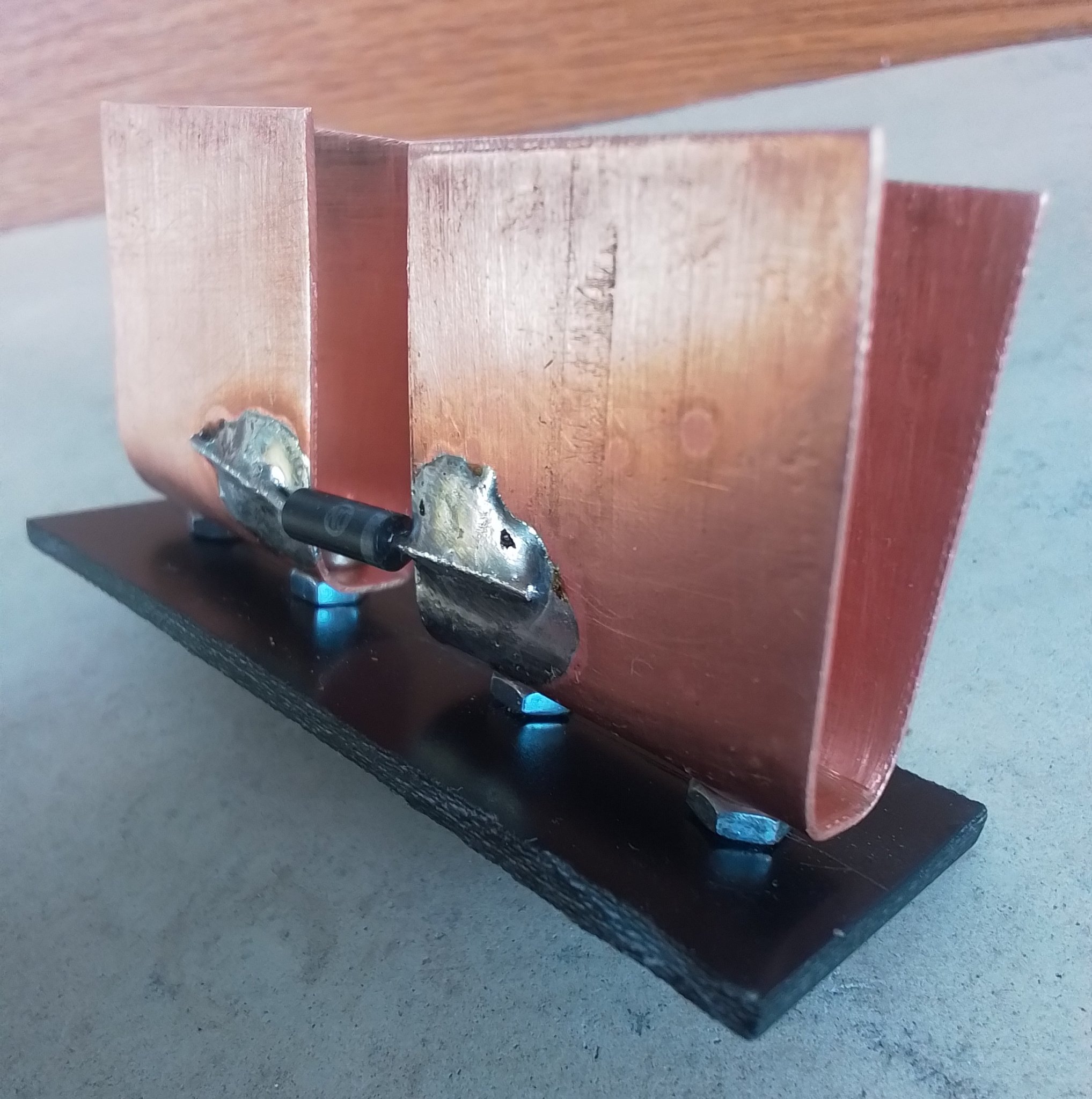

I figured one for a test. A bit over 2 square inch per side. Should it work please ?2W from natural convection would probably put Tj at the 200C Si limit. The case could be hot enough to burn flesh. If you were only using ONE, and it was mounted to a .062 FR4 with 4 square inches of 2 oz Cu on each end it might be good for a couple watts reliably. That would be a typical power supply application. They can also tolerate much higher non repetitive surge currents than one watters, in applications where they suppress transients.

![20240624_195536.jpg 20240624_195536.jpg](https://www.diyaudio.com/community/data/attachments/1233/1233947-924ee7505fc8b8083d86002e0c24622b.jpg)
I did a comparative test measuring the temperature of the leads in very proximity of the case as follow:Fire it up and see how hot it gets.
For initial jig with pcb pads and case heatsink I got 75*C (167*F) and 32.05V
For 'U' shaped heatsink I got 55*C (131*F) and 31.7V
As the mains voltage was shifting, now the current draw is 80mA. I measured in same conditions on the leads in very proximity of the case and got 85 C (185 F) on first version and 65 C (149 F) on 'U' shaped. Voltage 31.9V 80mA, 2.56W around. It is safe at 149*F at the end of the case please ?
