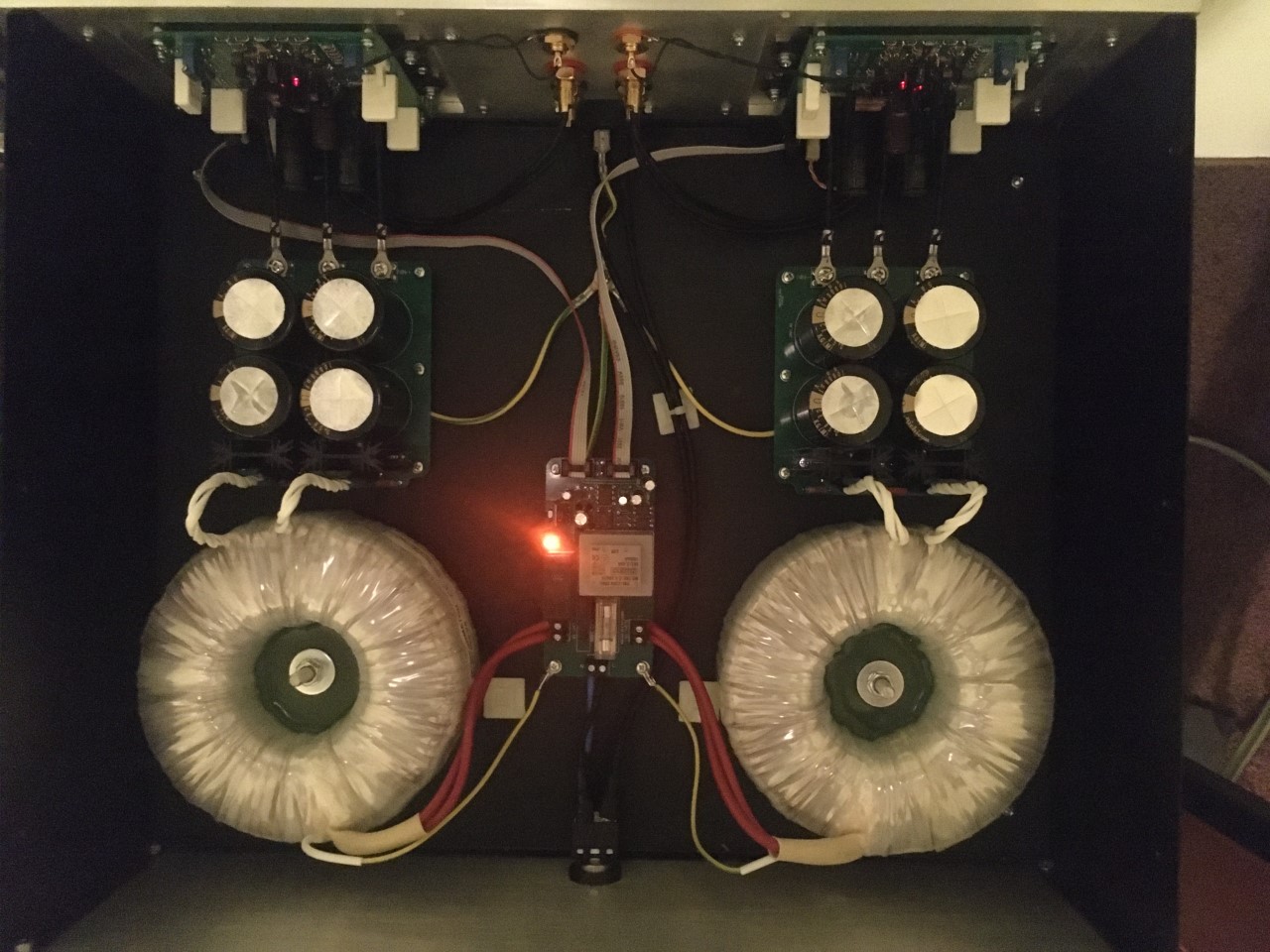

Here is a scheme that should allow a dual mono amp to be wired up that is quiet - ie no hum.
The trick it to ensure that there is one and only one connection between the two amplifiers, and that is accomplished by bonding the input connector signal grounds together.
The wiring scheme uses two ground lifters, although you could cheat and just lift one of the amps, and ground the other directly to the chassis, but I suggest you just spend a little extra effort and use two ground lifters.
A major issue here, as in any DIY amp, is safety. Kindly note the chassis (assumed to be steel or aluminium) is bonded directly to the incoming safety ground (earth) on the IEC receptacle. You cannot under any circumstances omit this connection - it is the most important connection in any amplifier. Using the ground lifters, the two amplifiers and their associated power supplies 0V then float +- 1.4V around the safety ground (earth). For the ground lifters, I always recommend you use a decent 35A 400V bridge rectifier - details in the presentation.

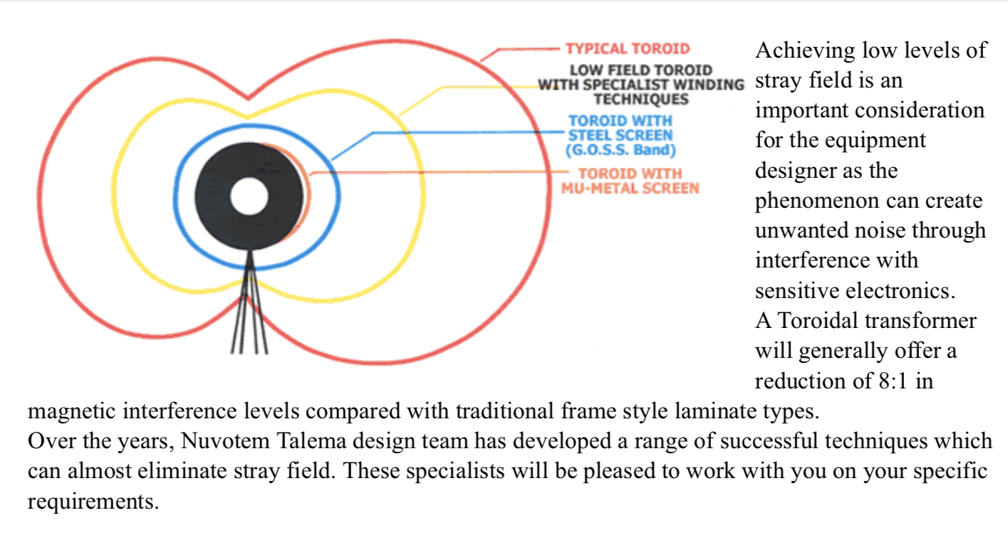

For the transformers, use a Toroidy (based in Poland) audio grade device with a GOSS band to minimize the radiated mag field, or if specifying custom devices, ensure your order your transformer with a GOSS band. An interwinding screen will also help to minimize mains conducted common mode noise.
One final point: do not mount your input RCA connectors on opposite sides of the rear panel. Mount them next to each other in order to minimize the inter-channel loop areas - again, details in the presentation.

You state "GOSS" band.
That is actually a Gauss band, a simple copper or non ferrous material covering the windings. Very popular with the Chinese.
Does nothing apart from making the transformer look nice and covers up the windings.

I usually keep the wire length as short as possible. From the RCA to the amp PCB is 10cm. From the amp pcb to the output is 14cm. From the psu to the amp pcb is 5cm...
This has some restriction to keep the amplifier pcbs on the back wall of the amplifier box.

“ One final point: do not mount your input RCA connectors on opposite sides of the rear panel. Mount them next to each other in order to minimize the inter-channel loop areas - again, details in the presentation.”
Ok, let’s think for a minute about this one; is it where the RCAs are mounted, or maybe the distance between the circuits that are prone?
After all, a loop doesn’t care about whether the RCA jack itself is located if the distance between the amp boards is the same either way, right?
No easy way with this one, have tried many different schemes.

The shortest path between the connectors and the amplifiers is not necessarily the one that minimizes noise. . See how the input cables are routed on slide no. 4. If the input connectors were on opposite sides of the rear panel and the internal wiring going straight to the module, you have a very large loop area.
It looks counter- intuitive but it gives the least loop area compared to just running the cable to the amp modules with the input connectors located on opposite sides of the rear panel. The transformers (even with a GOSS band) will be radiating an EM field this will generate an EMF between the left and right channels that will flow in the screens, degrading noise. (Important also to install a hum breaking resistor on the amp modules to reduce this current).
