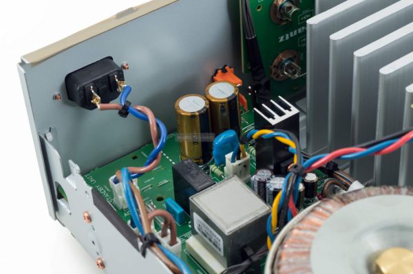

Amplifiers like my Yamaha don't even have a connection to mains earth. Yet they are compliant in a metal enclosure. I find this strange.
They are double insulated. If you look on the chassis, you will (probably) find the double insulated symbol which is a small square surrounded by a slightly larger one.

I know what the double insulation means. But how do You compare it with the wires with single insulation fixed directly to the metal tabs?
How do you compare it with the uninsulated wires on the IEC mains socket?
I would never do it like this...
Sajti
I don't really understand. Double insulated equipment?
As far as I understand it, air is an insulator. For a Class II appliance, you have to provide 6.4 mm between any live connection and any metal that can be touched by the user. So the exposed tabs on the IEC connector, while not pretty, are OK. The issue I have is the wire tie that holds the mains wiring to the chassis. I don't think the insulation of a single wire provides enough insulation to claim Class II. It looks like they tried to add some insulation (the black stuff) but it's in the wrong spot.
Sajti
I agree - I don’t do it like that either. Like a lot of things, the get out card in this case will be a notice on the rear of the amplifier that says ‘Do not open. No user serviceable parts inside. Refer to qualified technician’ or something similar.
The devil is in the detail in these things, but the takeaway point is if you are building DIY gear, make sure it’s grounded (earthed), stick to safe wiring practices etc. for example heat shrink bare connections (which is what I would have done in your picture you posted earlier).
