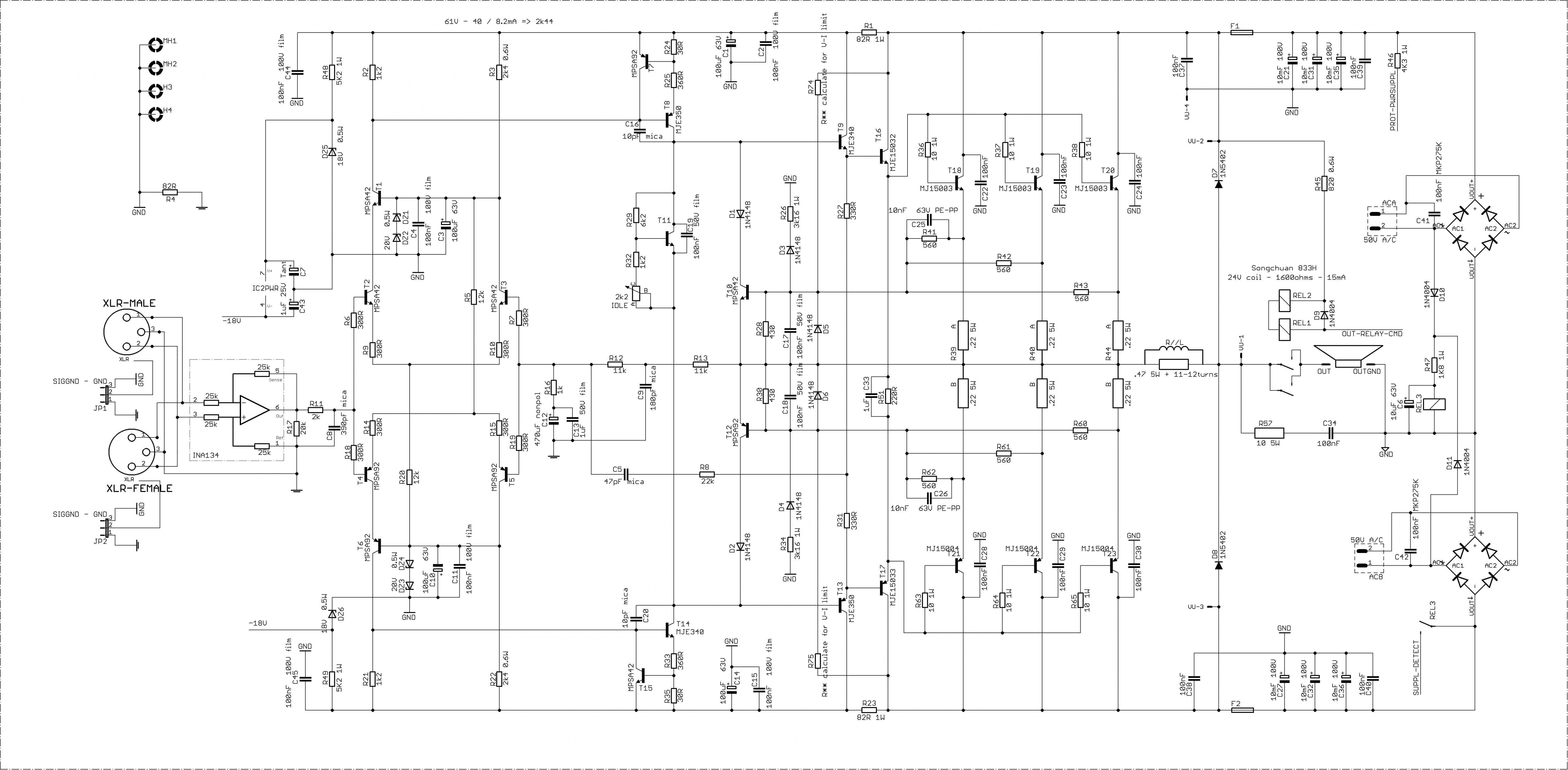

If that is a protection relay, it looks totally inadequate with a contact
rating of 7A/ 30VDC for such a powerful amplifier.
Yes, and I put 2 in parallel for good measure.
I looked at many models and I didn't want one too big in there.
If you have a better one to suggest, I will take a look at it. Not too big though.
I will still use 2 in parallel in any case. And there is one other for the mains power detection, I kept the same model to make things easier. I am considering adding one more for muting the input, but that takes so much room, I'm more interested in using a solid state switch like the J111/112. But this may be for a future version, maybe when I make use of the flat packs, which will take up less pcb real estate and that will allow more stuff on that precious space.

Two relays in parallel do not help with longevity of the contacts, nor does it help with preventing burning/welding of the contacts on opening.
Paralleling helps with reducing the impedance across the contacts and the connecting wiring.
The problem, even with a dual contact relay, is that one pair of contacts opens before the other pair. The time difference only needs to be in the microsecond range and the last opening contact then suffers the burning as the arc establishes across the tiny gap that is just starting to open. It is getting that arc extinguished, that becomes the priority.

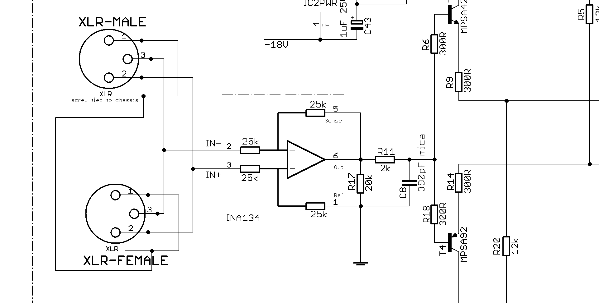

Re-wire your XLR sockets.
PIN1 goes to Chassis right next to it's respective socket. NOT to Signal Ground.
You're quite right! (as always
And now that I looked at it, for an unknown reason, I had also swapped pins 1 with 3. Duh!
The thing is, now I'm not sure what I'll do those pin1, because I can't connect that to the pcb ground plane, neither to the signal ground, and there is no easy physical way to connect it to the chassis. And there is the matter of the external ground connection, not an actual pin in the plug, but the plug casing pin, which I had hooked via jumpers to the choice of signal ground or main ground plane. This isn't good now. I will need to change all this.
More changes will be coming real soon on this ongoing design:
- I will do away with the output relay and replace that by SSRs. I am still pondering on that change, as I really think cutting the ground side speaker return is a good idea, but at the same time, the amp output side should really be also cut, so perhaps doing both sides might be nice.
- I will also do away with the fuses on the rails and use SSRs instead, probably triggered by the same signal as the output switches, not certain yet, but seems like a possibility.
- I may remove the zobel from the main pcb and move it to the speaker plug itself, although this is an uggly wiring to do... I may end up with 2 zobels, one on the amp's output before the output R//L and the other farther out on the plugs. I may even think about tapping the feedback on the outer side of the R//L, so that would be included inside the loop.
- I am also looking at an input muting, which I would want triggered in the proper order when muting the output. I definitely don't want to use the VI limiter's trigger to trip the amp's protection on the SSRs, as I don't want a simple soa trespass to stop the show.
This amp is kind of like my test bed for tweaking design choices. Then subsequent versions will probably go further, and eventually those will be using the flat packs.

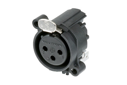

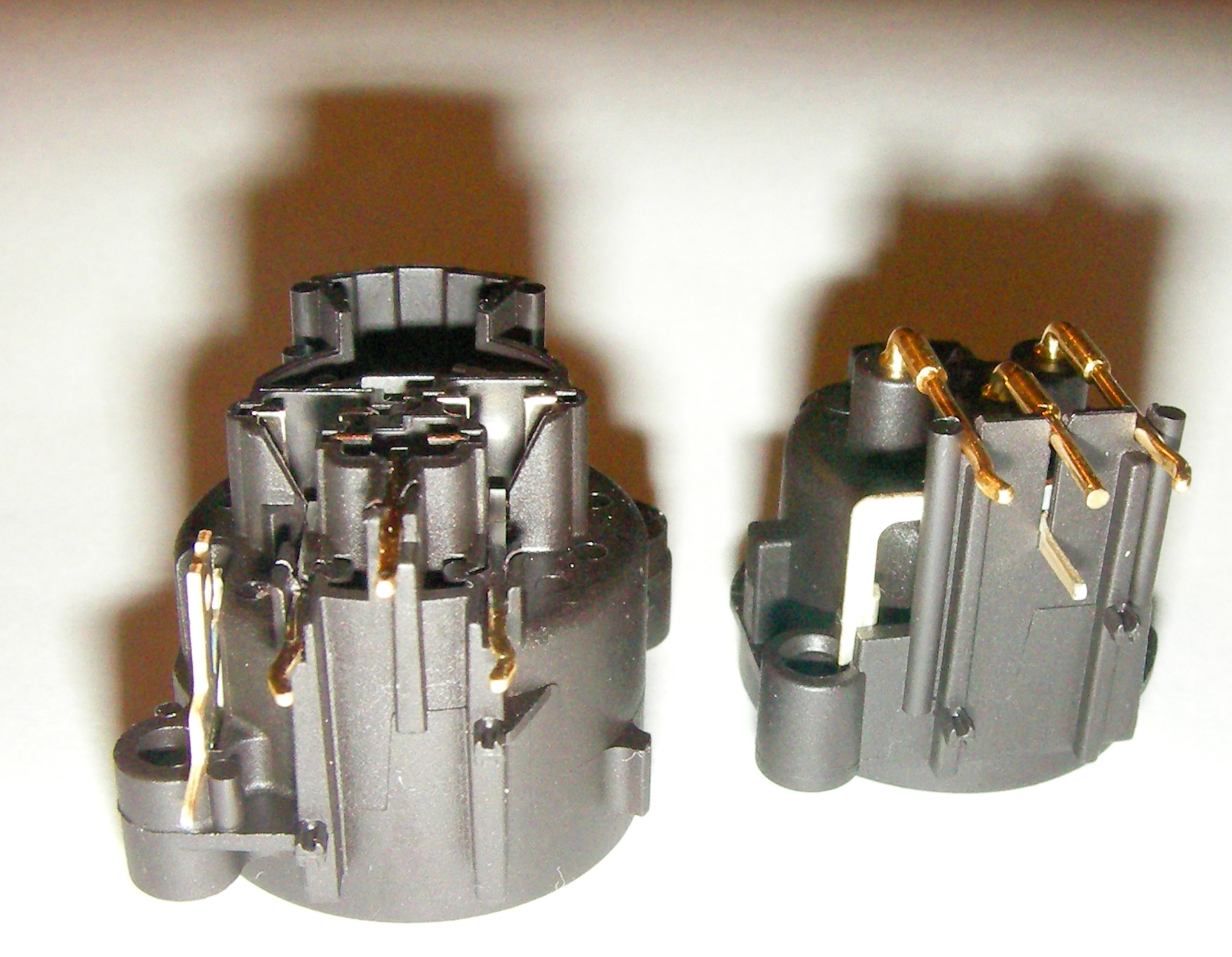

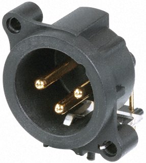

Here are the XLR plugs that I will be using (attached).
Those were not the exact types that I intended using, as I wanted the ones without the extra 4th pin on the plug cases.
I have those, unfortunately, so I have to handle those extra pins. And I figured I would allow for the choice via a jumper to tie them to sig-gnd or gnd. However this isn't any more adequate than tying the pins 1 to gnd or sig-gnd.
Those plugs being mounted on pcb, have no easy way to wire them to the chassis, except perhaps, now that I've noticed it, via the screw hole on the male plug. That screw hole has that inner wire going to that 4th pin, so it would tie to chassis automatically with the screw.
The female one doesn't have that and the 4th pin only goes to that little tab inside the plastic plug that will touch the male plug when it's inserted in it.
There is no easy way to tie the pins 1 directly to chassis, but what if I used the chassis connection coming from the screw on the male plug, tied it on the pcb with the 4th pin on the female plug, and then tie both plugs' pins 1 to this as well, without tying any of them to either sig-gnd or gnd? Or perhaps I could leave the jumpers to chose if we want to tie this chassis local net to either grounds or not at all.
It's probably never good to tie them to either ground, so I guess the jumpers are not warranted.

I think there is nothing wrong with this schematic, it's the leach amp and although I am making a few minor alterations, I like the leach amp the way it was designed.
If you know of a better design out there, I'd be curious to look at it. So far, there aren't many design coming anywhere close to this leach amp. And I'm not into class A, no tubes and I don't like mosfets, except I will make use of mosfets as protection switches.
There is nothing wrong with this sch, not at all, maybe a little obsolete, just saying such project deserves to persuit the best sound quality possible. My suggestion would be to look into dado's thread of 200 W CFA amp.
There is a lot to catch up there on those threads, but I think most are going for mosfets and that's not what I'm aiming for.
There is one thing that I do favor, it's the low TIM, and those looking to get ridiculously low THD with 3 or more zeroes after the dot, are not paying much attention to TIM. High slew rates can be impressive and open loop bandwidths very high, but I don't believe the high open loop gain and a high feedback are good for low TIM.
Leach's topo may be a little old, but I don't think of it as obsolete and I haven't yet seen anything out there that can be much better. The big buzz words don't make an amp good!

I've reworked the input xlr part and I'm attaching the snapshot of that now.
I thought I should just get rid of the jumpers, since they're really not useful there, and I tied the 4th pins to the pins 1 and I'm going to us the inner lead in the male plug screw hole to get chassis contact. I will have to be careful if the rear plate is anodized or painted, as I want it black, and the connectivity will have to be carefully checked with the screw in place.
So then on the pcb, I can have those chassis traces independent from the main ground plane and keep the signal ground clean.
Any comments on this?

Personally I don't think much could be done to really improve it, as our good professor did a great design job.
The main thing that bothers me with it is his choice of using those diodes to sense the heatsink, which requires more wires, can never be in a really good thermal contact, even as he prescribed to put them through those holes in the heatsink. This is akward and the wiring not easy and tidy. I don't think the thermal tracking is as good that way as a TO126 or TO220 can be on the main sink.
So this is one of the slight changes that I wanted to make, which should have nothing to do with sound quality anyway, just perhaps the thermal stability, which I would think should be better with the transistor on the main heatsink.
One small change I recently made, which really doesn't change anything either about sound, is to make use of beefier flyback diodes. He recommends the 1N400x types, but they could be sometimes pushed a little hard when the protection activates. So I figured using the 1N540x would be better.
