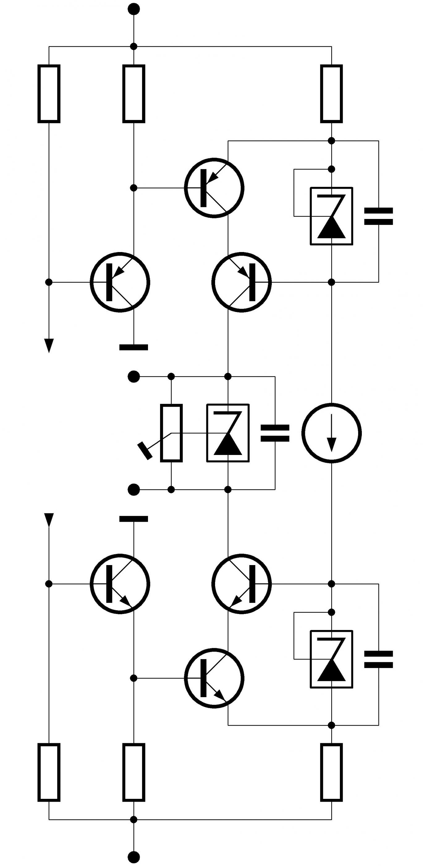

I still think that you can do away with the INA134 and use the ground end of C12 as your negative input with a bit of fiddling with your input resistors. Saves a 15V PSU and the potential signal degradation using the INA134.
I would like that, and I didn't do it because I wasn't sure exactly how to do this right. The input needs to easily be converted to unbalanced if need be, so that broken connection to signal ground on the negative input needs to be made right so it gets reconnected when going unbalanced. I'm not sure how to do this properly.
It would save space and several parts, without that extra psu for sure. That ina134 has rather good performance, so I wasn't too worried about its impact, however I am always in favor of having the least amount of parts in the signal's path, so obviously this qualifies.
There is one thing that I do want to be able to do though. I want to add a muting on that input, and I don't see how this can be done if we are in such a balanced arrangement. It must work either way.
I want to use a solid state input muting, avoiding relays and this circuitry needs to be easily triggered. I would make some kind of arrangement to mute the input at powerup, then the output mute is lifted first before the input, but then when powering off, the input mute should be done first.

Do following steps for better SQ:
- if needed use Lundahl input transformer for un/balanced input operation
- completely omit T1, T6 input cascode
- replace R5, R20 by j-fet CCS
- replace R1, R23 with zero ohm wire
- change FB network values to 2,2 k/100 Ohm/2200 uF
- change R2, R21 to 680 Ohm
- change R9, R10, R14, R15 to 22 Ohm
- change R25, R33 to 22 Ohm
- overall use of better modern transistors
There's more but for the start is OK.

Let's say enhanced VAS, etc.There's more but for the start is OK.
Now talking about sound quality, I've always been very wary of using transformers in the signal path. I see those are extremely expensive, even on ebay, and to me this type of thing is more what we'd find in tube amps, which to me is not something that rimes with sound quality, although some people swear by it.
So you don't like the zeners there. What don't you like about that cascode config?
What would using a jfet there bring? How can that help the sound?
This offers a little bit of separation between the input stages and the more ripply rails. Why would you do that? How could more noisy rails on the input stages improve the sound? I don't get that one.
All this would simply undo what makes the leach amp a low tim. You would change the feedbacks, reduce the local feedbacks in several stages, which would increase the gain on each of them, and then change the main feedback loop as well. All of this is going exactly in the opposite direction from what leach was doing to reduce TIM. I'm sure you would likely reduce further the THD, but it would increase the TIM in the process. How can this be better? I don't see it. Can you explain the reasons behind those choices? And have you done any sims to compare all this?
Looks interesting, and complicated. How does this work and what does it bring?
How can this be brought in the design properly?
Steps to be taken improves SQ, each step practically tested, compared to your's basic sch configuration, confirmed by listening tests many times in recent years, now it's up to you what you will choose.
For instance if you don't know what CCS brings over plain resistor in LTP common node, than I see no reason to explain any further. Just telling you what will elevate this amp to higher SQ level.

your enhanced VAS falls into the 3transistor VAS category.Let's say enhanced VAS, etc.
Many experts on this Forum tell us that 3transistor VAS are very difficult to stabilise.
But guys all these features I counted are practically tested, no problems found with them, I would not lead spookydd to some odd ways. Aren't we all strive for better SQ, at least that's my priority. For instance if listening tests clearly shows degradation in SQ by using input cascode than there's no place for it to be there.
