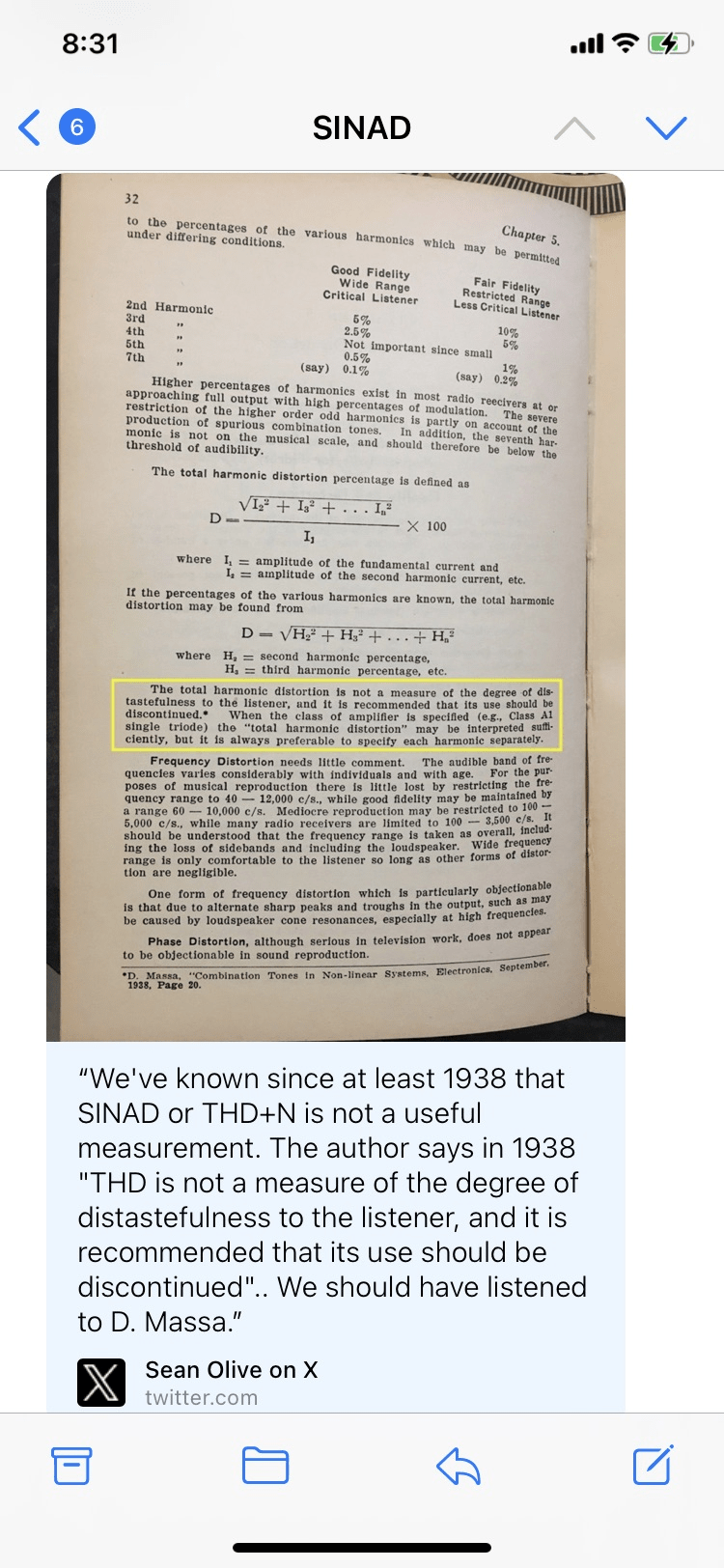

I'm talking about reproducing signals, not distaste! I want an amplifier that can reproduce nasty sounds exactly as nasty as they are, as well as good sounds as well as they are. Just like I like a computer monitor that reproduces colours accurately, and not rose-tinted...
By the way we've known about the mathematical truth of accurate reproduction of a signal for a much longer time than 1938. And remember the amp is only one part of the chain, the easiest part really. Best not to fail with the low-hanging fruit.
