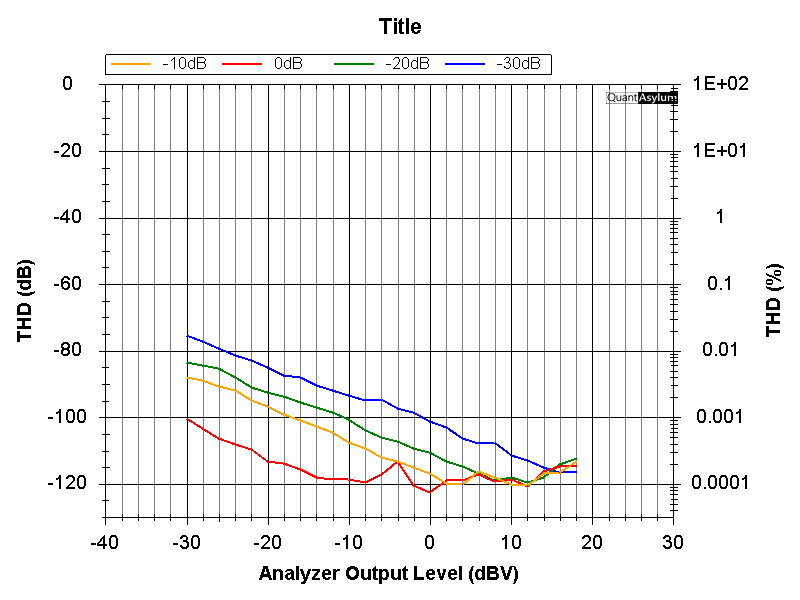

Here's distortion measurements for a cheap carbon track 5k linear potentiometer at several attenuation settings, any distortion is below the noise floor or the limits of a QA503 to detect:
Will have a go at a log pot next

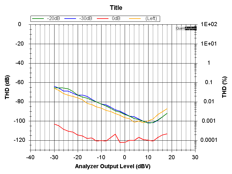

A 100k log pot, PIHER 100KB716M (which I think is carbon) shows clear distortion (I couldn't find a lower resistance log pot alas, so the noise is annoyingly high), showing that log pots are typically poor performers compared to linear (as you might expect - in a linear track any voltage coefficient will cancel out as the track has constant electric field throughout its length).
The 0dB trace is effectively the floor of the QA403, the trace labelled Left should be -10dB. The distortion at 18dBV is a good 20dB up compared to a simple linear pot.
The take-away is use the Baxandall volume circuit and low impedance linear pots, easy and performant.

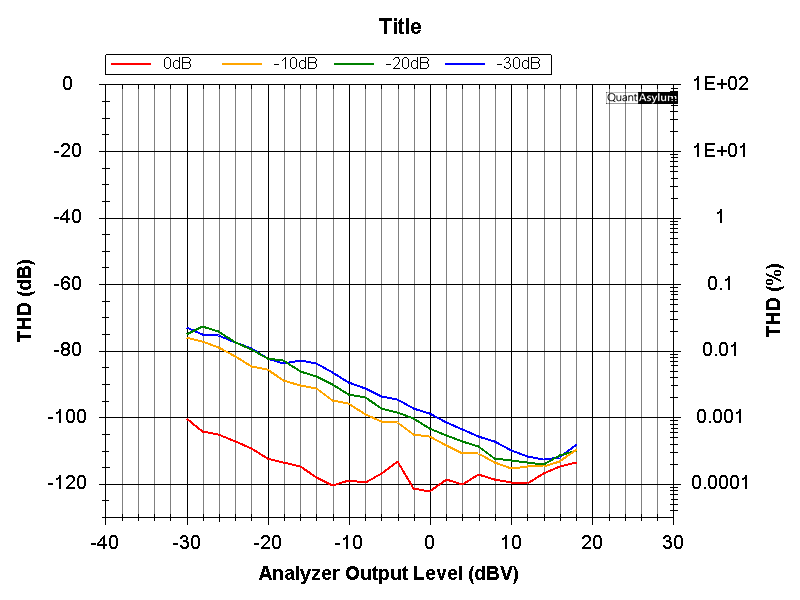

For completeness the 5k linear pot again but with 220uF 16V electrolytic on the wiper:
There is slightly raised noise on this, I think due to using a different breadboard this time and more mains pick up.
