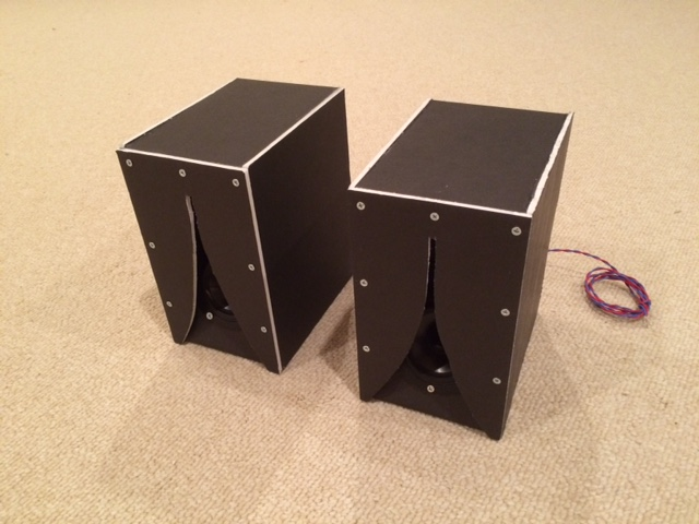

I finished the stereo pair for the RS100-4 today. They sound great - even with no EQ, very enjoyable. Astonishing bass extension and impact. Definitely a keeper and highly recommended build - super easy 2 hr construction and 1 sheet of foam core. This is one of those speakers where people will ask you where the sub woofer is hidden. I am really enjoying listening to them. Smaller than the 0.4x Karlsonator, yet deeper bass extension similar to the 0.53x.

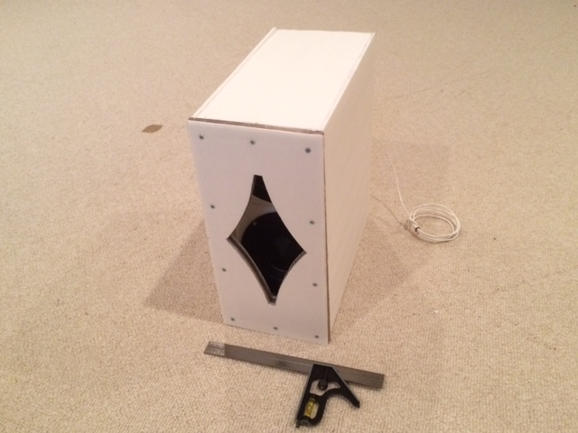

This was a prototype of a subwoofer using the XKi alignment with a couple of 5 inch PE buyout W5-876SE 16ohm sub drivers.
The design ended up as 18 liters on the rear and 3 liters on the front chamber with dual 7in wide x 0.6in high x 17in long wraparound vents. The front "vent" is a K-aperture with equivalent area to a 7in dia circle. The design f3 was 45Hz, with intended application as a corner loaded sub to I wanted a down-slanted bass shelf to compensate for room gain. Predicted cone motion for regular listening levels circa 90dB was less than 1.5mm (5 mm xmax) to keep distortion low.
I implemented the build in regular dollar store 3/16in thick foam core with a sandwich of FC and double-wall cardboard for the driver mount baffle and K-aperture. Only hot melt glue is used throughout. Otherwise, copious bracing with FC is used throughout. The box was very strong and vibrated a lot less than many of my other FC builds due to lots of bracing.

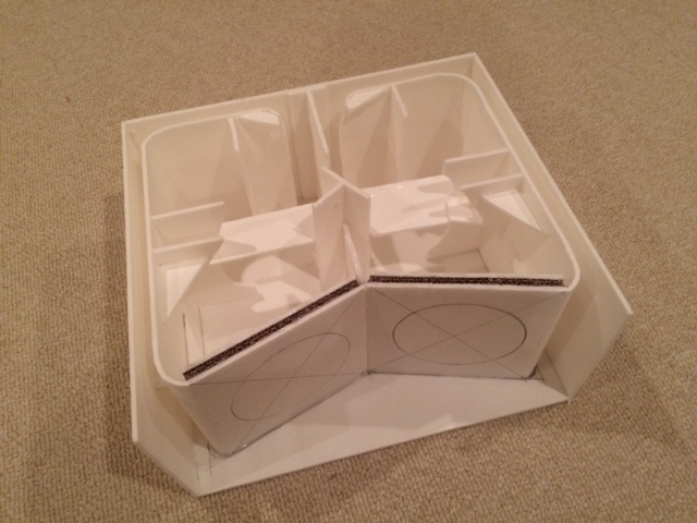

Here are the photos of the build - turned out to be a regular 3d sculpture with curve vent entrances and exits to reduce turbulence and allow one piece wraparound baffle/vent construction (Grandcalmar's construction idea):
Here is a nearfield measurement 2 inches away from exit plane to remove room effects - as you can see the bass corner ended up near 35Hz - about 10Hz lower than I expected. So there is something I am missing in the model - a correction for the narrow aspect ratio slot vent (empirically the factor is 0.67x to be applied to CSA to get freq predicted to match):
How does it sound? Only had a chance to listen to a couple of tracks with it as a FAST using an RS100-4 XKi on the top. Sounds very nice - digs deeper than I would have guessed possible for a couple of 5 in drivers. The SPL, is not huge though - about 88 dB at 1m and 2.83v for 40Hz because it is tuned too low. If the vents were shortened to get f3 back to ~50Hz, the SPL's would be quite a bit higher.

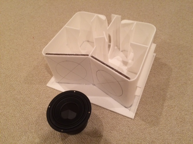

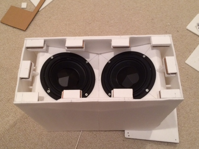

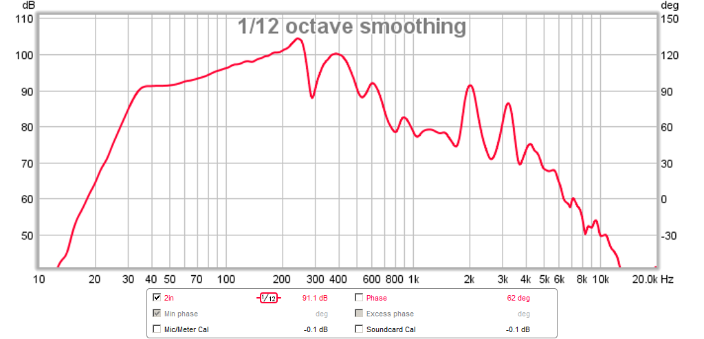

![466272d1424148438-xki-xs-ab-initio-karlson-6th-order-bandpass-xki-w5-sub-2in-measurement.png](https://www.diyaudio.com/forums/attachments/full-range/466272d1424148438-xki-xs-ab-initio-karlson-6th-order-bandpass-xki-w5-sub-2in-measurement.png)
