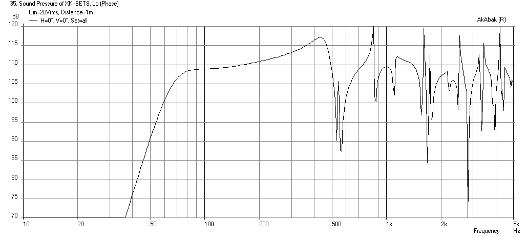

XKi for Beta 8CX tuned 70Hz
Freddi,
Per your request to hit 70Hz. This is a 17 liter box (internal volume) with 2/3rd volume in back chamber and 1/3 volume in front chamber with 10in wide x 1in tall x 12.25in long vent. Make the K-aperture about 60 sq inches (12 in high x 10 in wide). You can get about 108dB at 20volts for xmax - xlimit is much higher. -3dB is 67Hz and I use a 57Hz -24dB HPF. Note that this is a simplified sim without the effects of the K-aperture and mixed front radiator. I think in reality, the bandwidth should be broader and smoother.
Here is SPL at xmax:

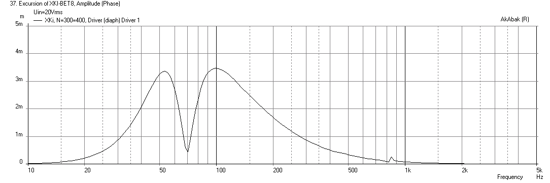

Here is cone displacement at 20 volts for xmax with HPF:
![475873d1428264586-xki-xs-ab-initio-karlson-6th-order-bandpass-xki-beta8cx-70hz.png](https://www.diyaudio.com/forums/attachments/full-range/475873d1428264586-xki-xs-ab-initio-karlson-6th-order-bandpass-xki-beta8cx-70hz.png)
![475874d1428264586-xki-xs-ab-initio-karlson-6th-order-bandpass-xki-beta8cx-70hz-dsipl.png](https://www.diyaudio.com/forums/attachments/full-range/475874d1428264586-xki-xs-ab-initio-karlson-6th-order-bandpass-xki-beta8cx-70hz-dsipl.png)

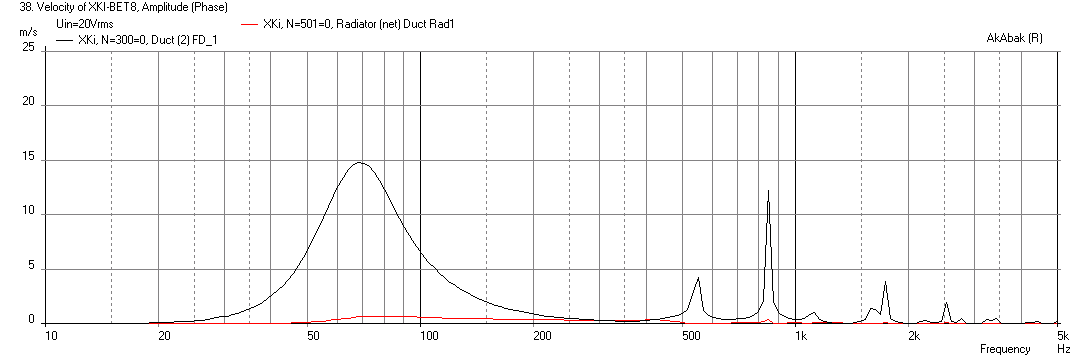

Here is vent velocity at xmax:
![475875d1428264586-xki-xs-ab-initio-karlson-6th-order-bandpass-xki-beta8cx-70hz-velocity.png](https://www.diyaudio.com/forums/attachments/full-range/475875d1428264586-xki-xs-ab-initio-karlson-6th-order-bandpass-xki-beta8cx-70hz-velocity.png)
if it follows the sim, then will have somewhat better LF extension than some K12, so would expect it to sound reasonably well balanced on most music without a subwoofer. These should work nice on tripods and in 2.1 mode with extension to maybe 40Hz solid to keep the 3-piece system light and compact.

Freddi,
Yes, I was concerned with the possible vent cancellation thus I made the vent area larger to reduce the velocity and the length is shorter than my initial version. This was in an effort to preserve efficiency and give you an fb of 70Hz. The front chamber volume that I suggest is 0.2 cu ft as 1/3 of 17 liters is 0.20 cu ft. Are you concerned that the rear chamber isn't big enough for the basket and CD magnet? Have to sketch out the chamber based on dinensions and volumes to know for sure.

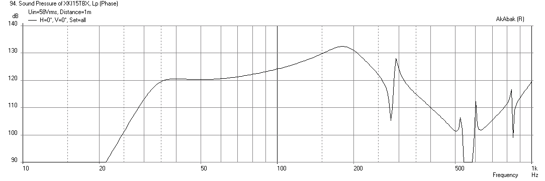

XKi for B&C 15TBX
Freddi,
I recall you have a B&C 15TBX lying around... Here is a sim for an XKi as a thumpin' sub woofer. 5.3 cu ft total internal volume with usual 1/3 front and 2/3 rear volume distribution, with 18in wide x 2.5in high x 24in long vent, K-aperture is about 175 sq in (24in high x 15 in wide). 120dB SPL at xmax with 58 volts and achieves 33Hz at -3dB. Use 30.5Hz -24dB BW HPF.
Freddi,
![476018d1428324512-xki-xs-ab-initio-karlson-6th-order-bandpass-xki-15tbx.png](https://www.diyaudio.com/forums/attachments/full-range/476018d1428324512-xki-xs-ab-initio-karlson-6th-order-bandpass-xki-15tbx.png)
on the Beta8cx - a little concerned to fit - would probably use the excellent D280Ti PRV as have two sets (they changed style IIRC from the first offered at PE) 5.3 cubic feet for 15TBX40 is pretty good - K15's two chambers seem like 2.2 front and 3.6 loaded rear so this would be in direct comparison to a K15. 15TBX as a direct radiator sounds kinda power hungry as its midrange is around 5-6dB less than a 15 with mms in the 50-60 gram class.
