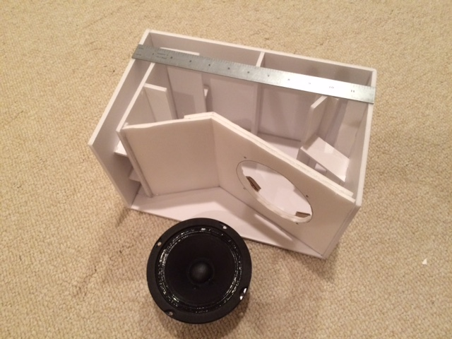

I had some time for some quick foam core speakers again. I threw this one together pretty fast using the stiffer Elmer's brand foam core with softer foam core for the double thickness baffle board. I have been curious as to whether or not the Dayton PA130-8 would work well in an XKi... I suspected it would based on how great it sounds in a 0.53x Karlsonator. I wanted to try the XKi because it is much more compact - desktop size basically at 7in wide x 12in tall x 7.5in deep.
I did not get a chance to make the K-aperture yet, but I tested the sound without it and it sounds very good. Bass down to about 65Hz and pretty low distortion and balanced overall. I did not even bother to put pads or stuffing inside yet and it sounds very nice already.
This is going to be a classic that I will keep around for a long time - I can tell. It has the great compact size and proportions, sounds balanced, has rich full bass, a great midrange, and it is pretty loud with great dynamics.
This foam core build confirms that the model works and the plans shown in post 315 is good. I set the break point on the front baffle at 5in below the top edge.

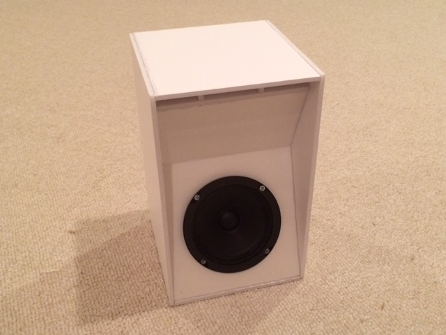

Here is the XKi with the K aperture. I made the aperture out of 1 sheet of foam core glued to 5mm floor underlayment plywood. It's pretty stiff and gives the speaker a nice look.
Here is a photo of the new XKi (there is a terminal cup on the back):

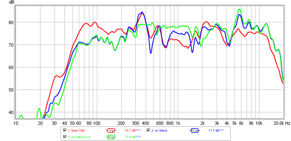

Here is the frequency response up on a stand, 6in from a back wall, and without a K aperture:

It sounds very good despite the dips and peaks characteristic of many Karlsons. The aperture gives a wider more uniform polar directivity:
It has about a 55Hz -3dB extension.

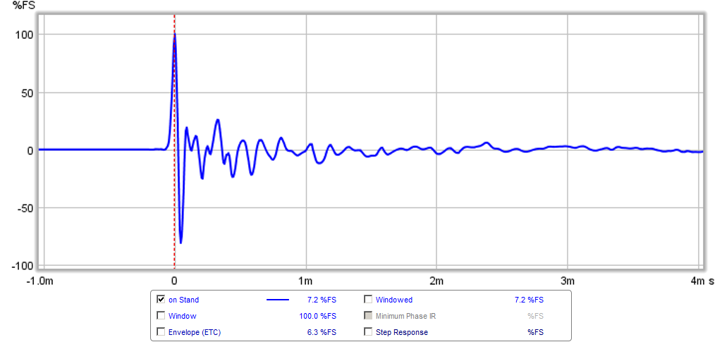

Here is the impulse response for the K-aperture case:
![500011d1440314705-xki-xs-ab-initio-karlson-6th-order-bandpass-xki-pa130-ir.png](https://www.diyaudio.com/forums/attachments/full-range/500011d1440314705-xki-xs-ab-initio-karlson-6th-order-bandpass-xki-pa130-ir.png)

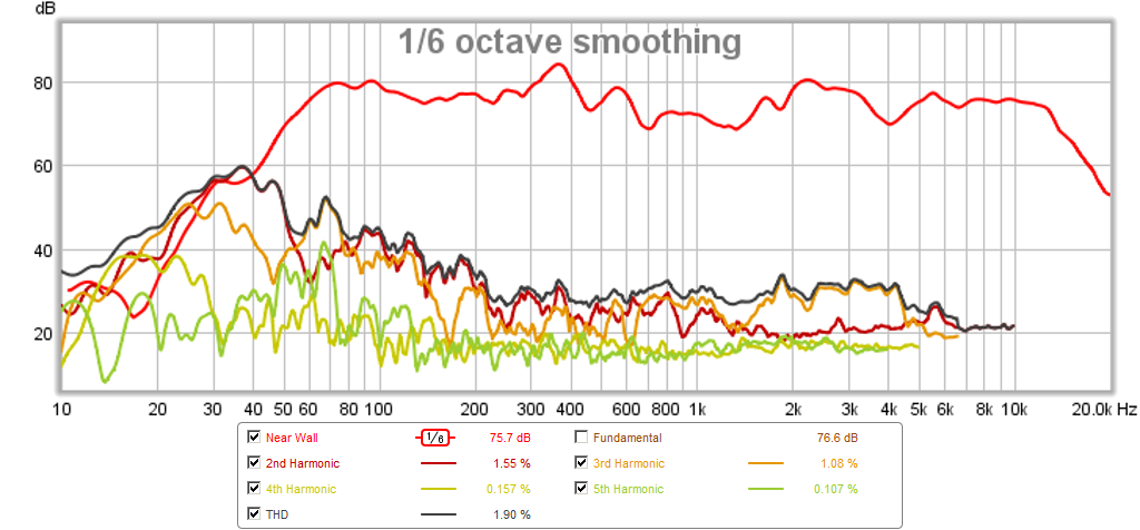

![500012d1440314705-xki-xs-ab-initio-karlson-6th-order-bandpass-xki-pa130-hd.png](https://www.diyaudio.com/forums/attachments/full-range/500012d1440314705-xki-xs-ab-initio-karlson-6th-order-bandpass-xki-pa130-hd.png)

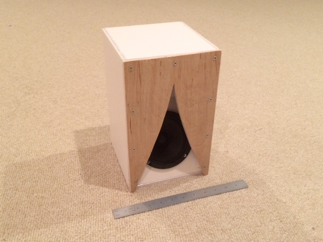

I still have some of that 5mm underlayment around and I figured why not get rid of all the K-wing flex and make it look good while I am at it. The foam core on backside acts kind of like some padding to absorb sound I think. Acoustically a lot less hard than ply - more "cork like" I would expect.
Yes, this thing sounds really good - stand up plucked bass is unbelievably good and you can't imagine coming from a little box with 5in driver. Let me records sample and post.
