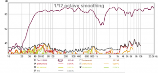

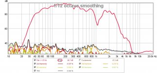

Initial measurement of the Beta 8cx XKi shows bass extension is good and distortion is very low. There is a large dip at 1kHz though - I suspect it is the port resonance cancellation. The 1kHz corresponds to approximately the fundamental frequency of a 13.5 in long vent - approximately the acoustical length of this design if you account for losses of a 90deg turn. This means that the vent will have to be reduced in CSA and length shortened to bring the dip above the XO freq. The PRV D280Ti needs to be crossed at about 1.2kHz so this is a problem for now.
However, it shows that the design achieves pretty good bass extension and cone excursion control and fairly uniform response over the effective bandwidth.
Next step is to add CD to the coaxial and see how it sounds, 1KHz dip notwithstanding. Probably will require surgery to go in and reduce port length.

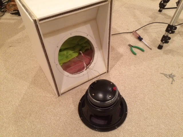

I installed the PRV D280Ti compression driver onto the back of the 8CX. It is a hefty CD, with a magnet almost as big as the woofer. I connected the two drivers with bi-amp (TPA3116D2) and miniDSP for XO and EQ. Here is the Beta 8CX with the D280Ti mounted on it and about to go back into the XKi.

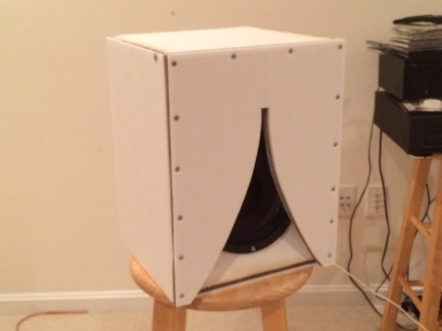

Here is the completed speaker with K-aperture made of same 3-ply CLD sandwich construction. It is screwed straight onto the thick cardboard layers of the main panels using drywall screws. It is quite stiff and doesn't hardly flex, having the CLD gives it a dull thud with a finger rap.

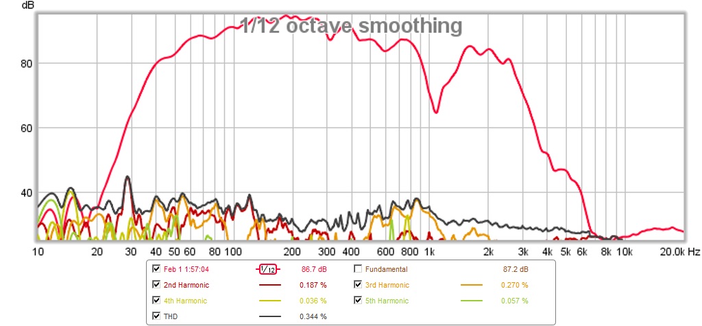

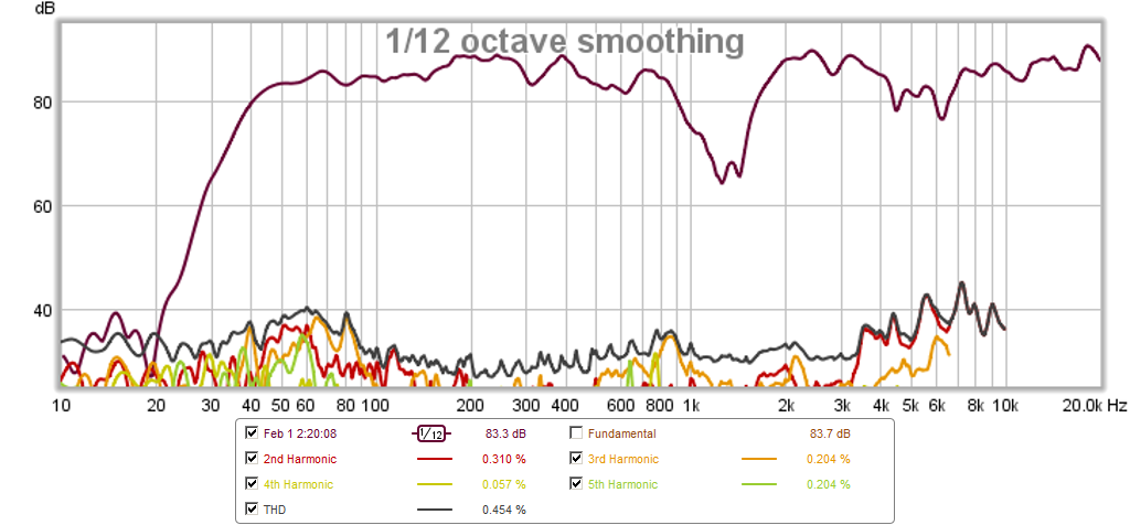

Here is the measured frequency response with the CD installed. I am using a 2kHz 24dB/oct BW XO here. Only a mild +3dB high shelf EQ from 4.5kHz on up was applied to get the HF flatter, and a +3dB low shelf from 80Hz and below was applied (HD was still decent so I don't think it's a big deal). Note the huge hole at 1kHz - trying to figure out how to fix this - if I can this will be an awesome speaker because even with the hole, it sounds very nice as you can hear below.

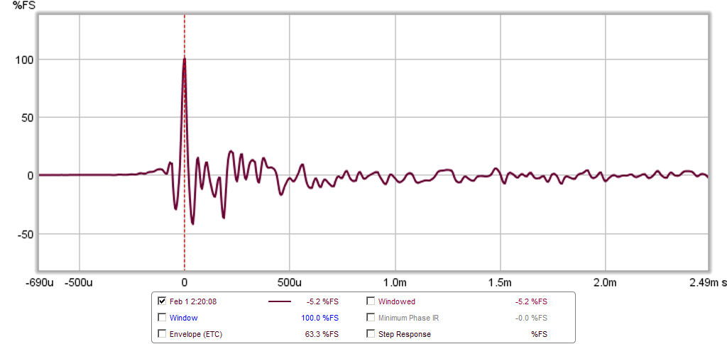

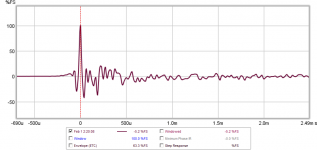

Here is the corresponding impulse response - a clean pulse with a little low level oscillation that is coming through a bit sibilant. I should note that this is my very first real compression driver! Up to now, I have only used cones, domes, and pleats. It sounds quite good actually considering this is a budget priced driver at $40. One way to fix this is to use a CD that has a lower XO capability but those are pricey. Another option is to build a custom coax with a homemade coax using a 3FE22 mounted onto the internal horn (use the horn as the rear mounting tube and serving as rear driver chamber with driver protruding out front of woofer). Then I can use it with a XO at say, 600Hz.
![462842d1422826077-xki-xs-ab-initio-karlson-6th-order-bandpass-xki-beta8cx-hd.png](https://www.diyaudio.com/forums/attachments/full-range/462842d1422826077-xki-xs-ab-initio-karlson-6th-order-bandpass-xki-beta8cx-hd.png)

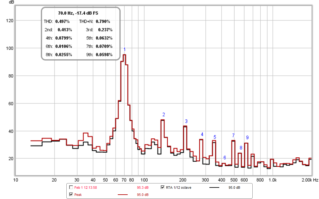

The dynamics are very clean and quite punchy. I was standing in front of it and could feel the kick on chest at moderate volumes. The cone doesn't appear to move much, at max volume with the TPA3116D2 putting out about 17 volts, the cone moved maybe 3mm on kick drums. It was very loud, but sounded clean still. Here is the RTA of a 70Hz sine wave to check for HD levels and absolute SPL levels at 1m and 2.8v. I am getting about 0.5% THD at 95dB at 70Hz.

Other than the dip at 1.5k this response looks great! Low distortion is a bonus! This design has lots of potential XRK... Keep up the GREAT WORK

does your Beta8cx based XKi seem to play loud enough for a medium room without the cone moving "too much"?
