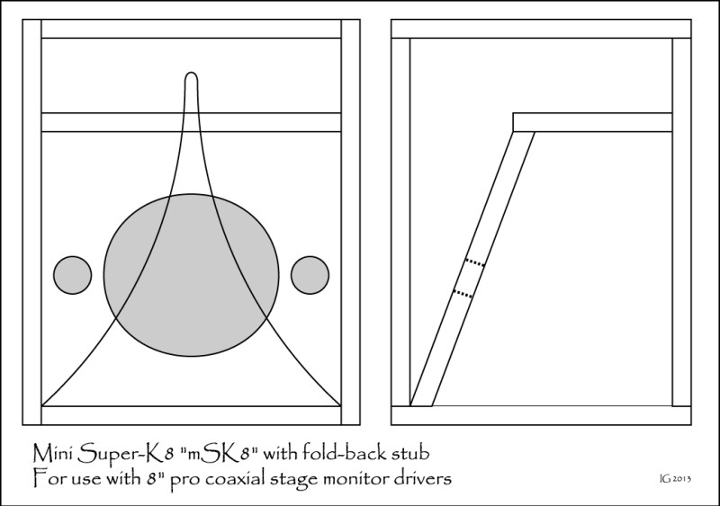

The form-factor reminds me of something I was working on a couple of years back, which was basically a shorter SK8, dubbed mini-SK8 (originality!). It was also meant for pro 8" woofers or coax. Depth is 12" and width 13.5", as with SK8; I forget height, probably ~16" or so. Proportions are correct on the below draft in any case.
I went for simplification of most involved principles - as I could see them, thus the venting scheme "driving" the same point as the driver in the front stub "air column". I had also thought of rear venting the top-shelf much like you did here, but not quite as long. I wasn't going so much for bass extension as efficiency above ~80Hz. IIRC, sims looked decent for FF225WK, Beta 8cx and 8A as well as various B&C units. I noticed how SK8 was too big for many pro 8", so reduced the rear Vb, but folded the stub back to try and keep the ~200Hz front tuning. I never built a prototype.

Hi IG81,
Thanks for the kind words! You look like you were about to go down the same path as me. In your drawing there is a stub in the upper outer chanber. Would that not cause a echoing effect? Your two side by side vents are similar though - just not as long. In a way both resemble an RJ in some respects.
I found out the hard way that a long vent on the larger 8in causes a massive cancellation dip. So the trick is to keep it 6in or under. Unless you are using as just a bass or sub then vent can be extended for best bass performance below upper cutoff notch.

The fold-back may make for some funky effects higher in the midrange, an actual implementation would best confirm that I suppose. I was hoping to conserve the full vertical height as seen by lower frequencies, which would not care about the bend.

a small wad of polyfil in the foldback portion would probably kill any tendency to honk plus can aid to smooth ripple. Metro's T15 stub (if made like their depiction) has a vent smack in the middle of the length so may behave differently.

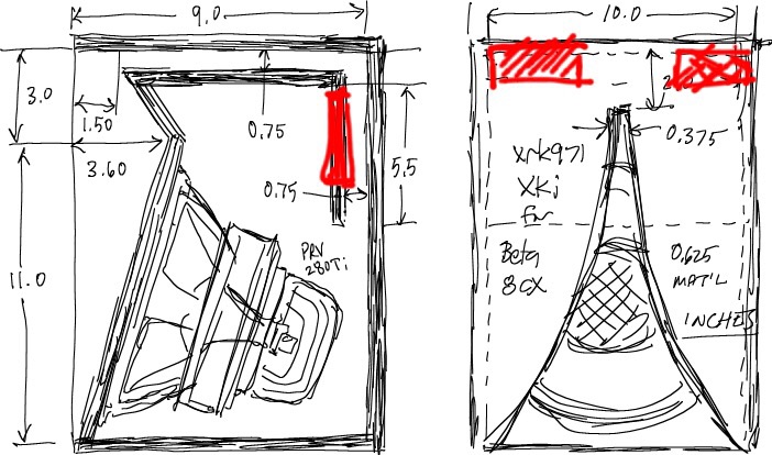

XRK, could you post a quick drawing of the changes you made to the Eminence 8CX beta box to improve the sound?
As I understand it, effectively you shortened by cutting some holes in the back vertical part of the port, and halved the size of the front port with some foam, and also put behind the speaker some foam pieces. (but I'm not sure where)
I basically cut out pieces of FC and stacked to match vent gap and put one to each side of vent at the top to reduce cross sectional area by factor of two. Then I cut rectangles about width of remaining vent (5in wide) x 2in tall total cross sectional area on back vent wall. I could barely reach through driver cutout to do this. The idea is to reduce area by 2 and length by 2. If built from scratch just make vent about 10in wide x 0.375in high x 6in long. Or 5in wide x 0.75in high x 6in long.
Here is sketch (not to scale) showing where foam was added and where window was cut.

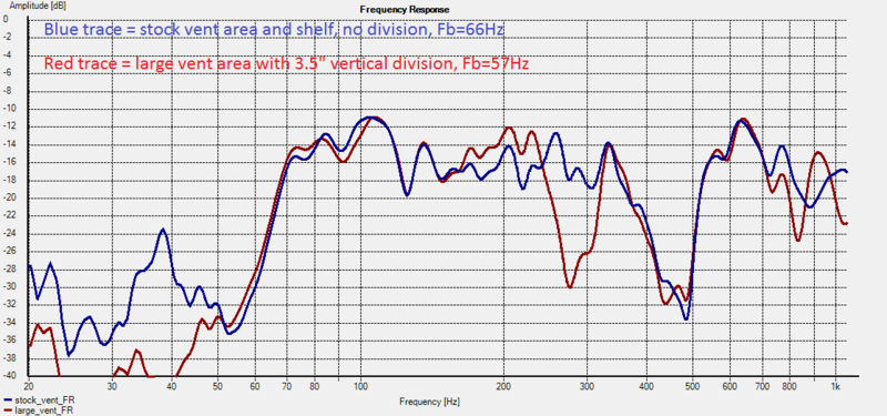

Did it work?? It seems like you are fighting an anomaly of the driver primarily, but by an unfortunate coincidence the SKi has a small dip at the same spot.
A reflection from a surface ~3.25" away would cause a null at 1khz. Any likely suspects? Could it be the wings, or the sidewalls?

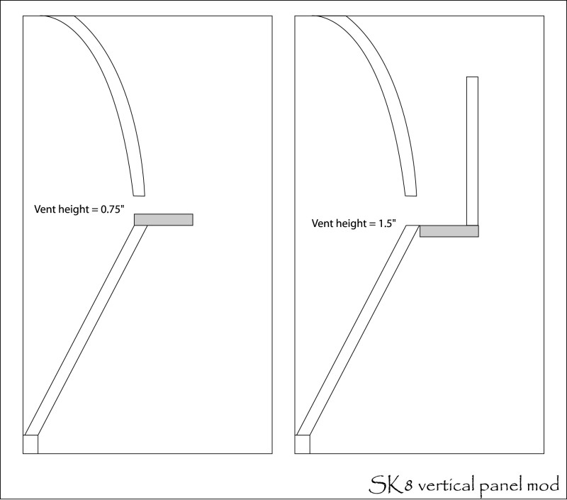

I did try a long-vent modification in my actual SK8, but it turned out disastrous IMO.

It's funny how modest differences in folding/geometry really matter in these things. I recently found my original Karlsonator folding sims, which looked a lot worse than your long vent modification. It took a few tries...
The SK8 -- for those of you that did not hang out in the Karlson subsection of the old fullrangedriver.com forum -- was a modestly stretched modification of the original Karlson 8 design of the 60's. It was more or less designed by committee when we all realized the original had a 'stub' that was too short.
Yes, back on post 147 I discussed improvement. I dealt with reflection (if that was part of the problem) from sidewall with foam on back chamber. The vent length reduced dip by ahout 8dB. I suspect it was not sidewall and will check by removing foam at some point. Interestingly, the added foam increased harmonic distortion so I want to get rid of it if not needed.
