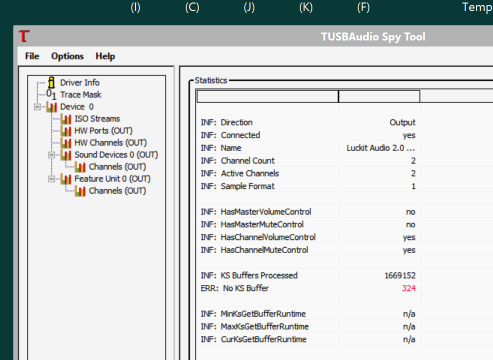

I found the attached Err entry in TSUB Spy Tool.
What is the significance of this?

I'll forward your infos to Thesycon and ask them to answer to your question!

Latest Driver 2.23 but also found in 2.15 etc
Win 8.1 x32 but also in x64
32 bit KS 50 and 140mS buffer foobar 1.3.2 KS driver with no plugins activated. Native 176.4 and 192k .wav files.
I would really like to get to the bottom of this. Does it happen in your systems?

I wait for the answer from Thesycon and here it is:Latest Driver 2.23 but also found in 2.15 etc
[...]Regarding the issue: This error indicates that the application (the player, e.g. foobar) was not able to provide audio buffers in time. But the correct interpretation depends on when the error happens: a) If the error is counting up while a song is playing then this indicates that there is a problem. b) If the error is counting up while the player switches from one song to the next, or during user-initiated start/stop transitions then this is normal behavior. Typically, during such transitions the player is not able to provide buffers in time. One should use Options - Clear in the menu to reset the counters and then watch carefully when the counter increments.
Note: [...]Spy Utility is intended to be used by developers and support staff only. Correct interpretation of the counters is not trivial. Due to internal implementation details some events show up as errors but are not really error conditions.
Maybe making the buffer in TUSBAudio Control Panel a little bit large could solve the issue (hoping it's indeed a real problem and not a 'hidden' code showed as an error, as Udo said above)?
