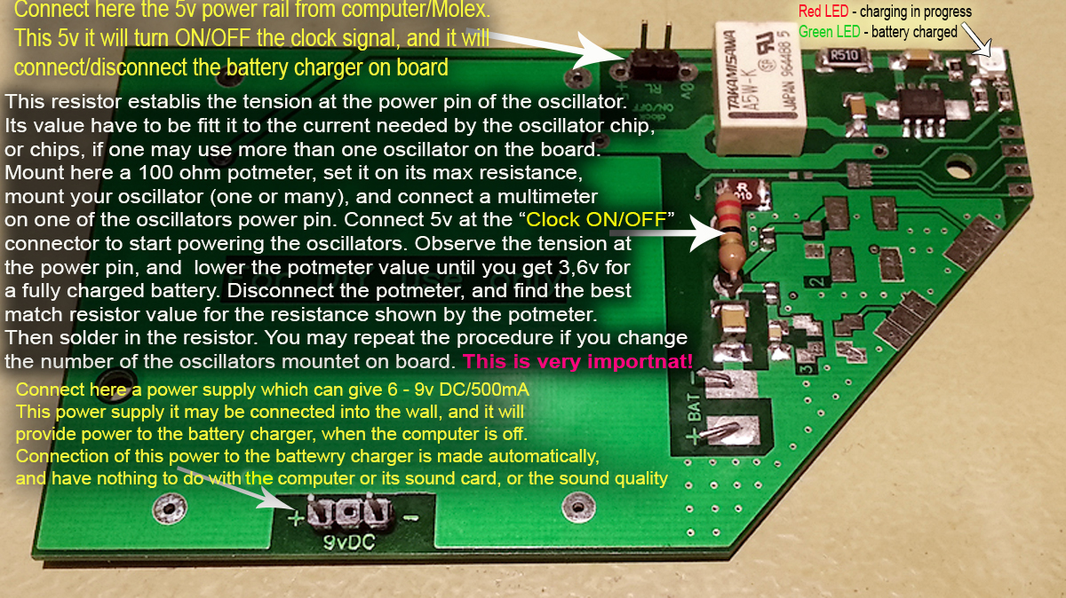

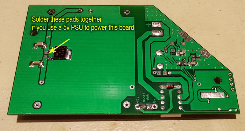

First, there is not here about to find a battery charger to connect it to this clock board. This charger is integrated into the board itself. The only one may care is to provide 7v - 9v DC power to this board.
You can of course connect the power to the board as you wish, with switches, connectors, and so on.
The only problem is that all these things are not necessary, as the battery charger get connected and disconnected automatically when the computer is on or off. Even more, the disconnection of the charger is completely. Both power rail and ground are disconnected from any contact with the computer, when one turn the computer on.
To conclude, I would like to precise, that this clock board is meant to work as a part of a system. This system include a power supply and two small transformers, which either will be placed inside the computer, or outside. The power supply board is to be placed over the sound card together with the I/V board. I think there are published here some pictures of this PSU and the I/V module. The transformer (which are meant to completely separate the post DAC processing power system from the computer one, as the ground connections between these two systems) are meant to stay always connected to the wall (their primary coils), while the secondariness are managed automatically, by the simple Power ON/OFF of the computer.
But when one will use this clock board as stand alone, then one may provide the power to it, using a usual sort of PSU. Such it may be a very standard converter box one, stack it into the wall. One can even use a 5v PSU, but then it may bypass the 5v regulator planted on the board. This is very easy done, by soldering together (pads provided) the input with the output pin of the regulator. Actually the regulator on board is meant to extend the range of the input tensions for this board. The battery charger work at 5v. If one do not have exactly this tension on his available PSU, then can connect what one have (into 9v DC), and the regulator will care to deliver what the charger need.
Some important details for those who want to implement this mod.
Please "read" the picture...
