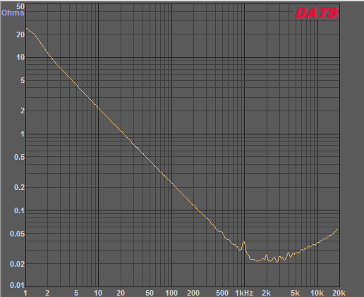

Below is impedance sweep for one Panasonic FR 6800uF and same sweep with added parallel PP film 10uF looks exactly the same so there is no clue to see inside low bandwidth that DATS unit is covering.

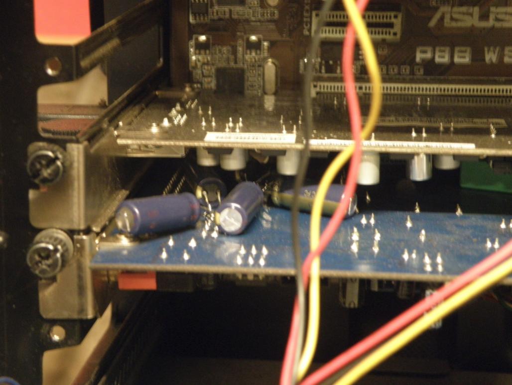

Also think FC series are great value and good sound, below is M-Audio AP192 soundcard having original 22uF exchanged with 470uF that because of volume needs to sit on other side of PCB, the use of relative higher value help improve HD when measured and also when soundcard is used as measure device there is much less excess phase finding place at lows so that measured absolut phase is much more in agreement with theoretical minimum phase.

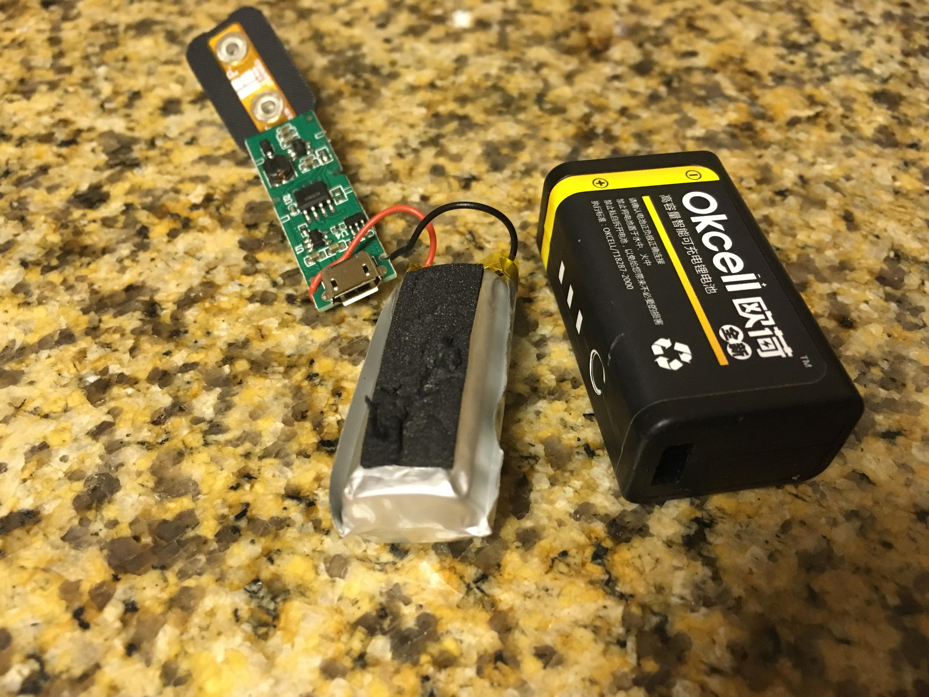

fiddled a bit more with my LiIon batteries (Soshine brand).
Either the protection circuit is more aggressive than you guys' EBLs or my capacitors are too large at 2700uF. It will never charge it sufficiently to turn on even with flicking it on and off many times.
Needs a "jump start" from either an alkaline or another power source. Starting it with 1x liion + 1x alkaline charges the caps, and i can quickly switch to liion and it works. If you guys know another way I'm all ears.

I tried it (four horizontal 12.5mm wide caps) and couldn't fit my OKCell 9V batteries in the tin, because the rail caps were protruding past the edge of the board. But maybe it is possible with different batteries or a different brand of mint tin?? One possibility I'm considering is to pop those LiPo batteries out of their cases which makes them half the size (see pic), or try my hand at doing a DIY battery like X has done.
Another option I may try on another build down the road is to omit the battery wire socket and just solder battery wires directly to the PCB on the SMD side. This would free up space for longer rail caps. Panasonic FR has a 10x25mm can size that would fit there. For instance, I would really like to try that fat Silmic that Funch used on output, with a 25V 1200uF FR on the rails.

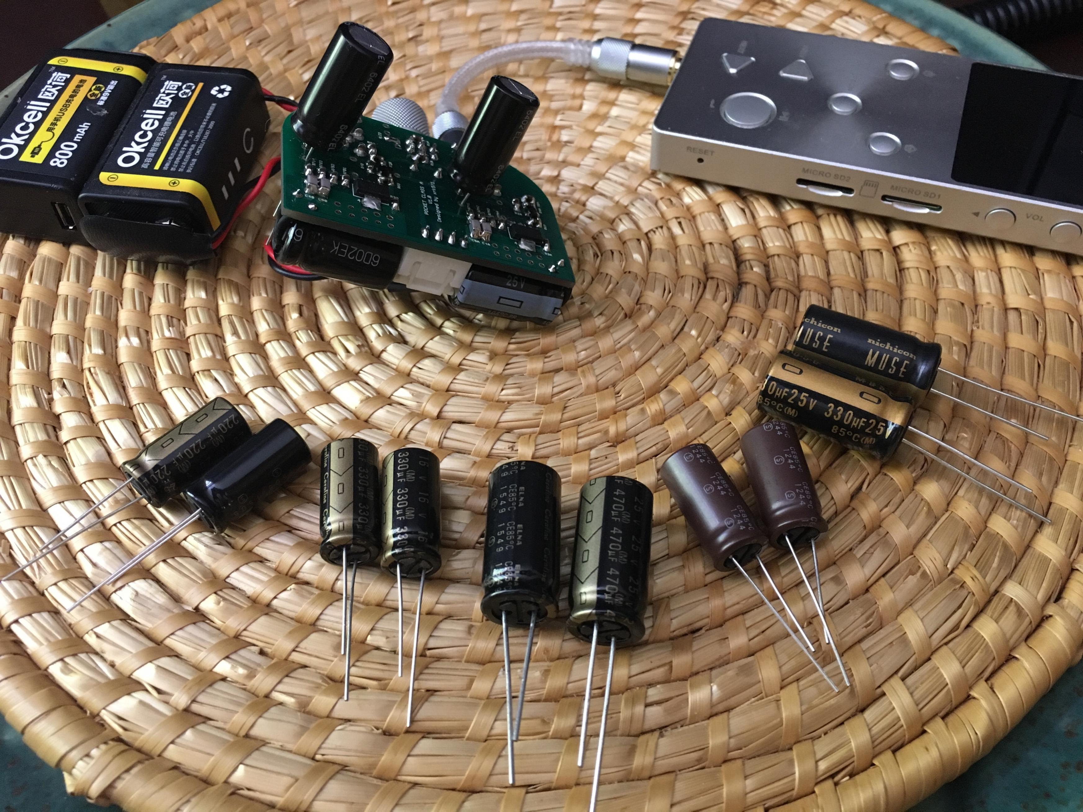

Beginning my final round of tin-sized cap listening tests.
25V 220uF Cerafine / 16V 330uF Cerafine / 25V 470uF Cerafine / 16V 220uF Silmic / 25V3 30uF Muse
I should have also gotten the 16V 470uF Silmic that Funch used, but forgot that one. Even so, I think I'll get a good idea of the pure Silmic sound, just with a tiny bit less bass.
